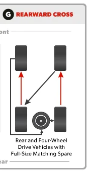

Tire rotation was also only done for the 4 being used and not the full size spare. I was told that its not needed and thats why the air pressure is so high in spare. Even though, this was BS but leaving a spare tire for emergencies was ok so didnt want to argue with the guy. Plus the kind of rotation recommended by toyota will leave 3 tire on one side used differently.
