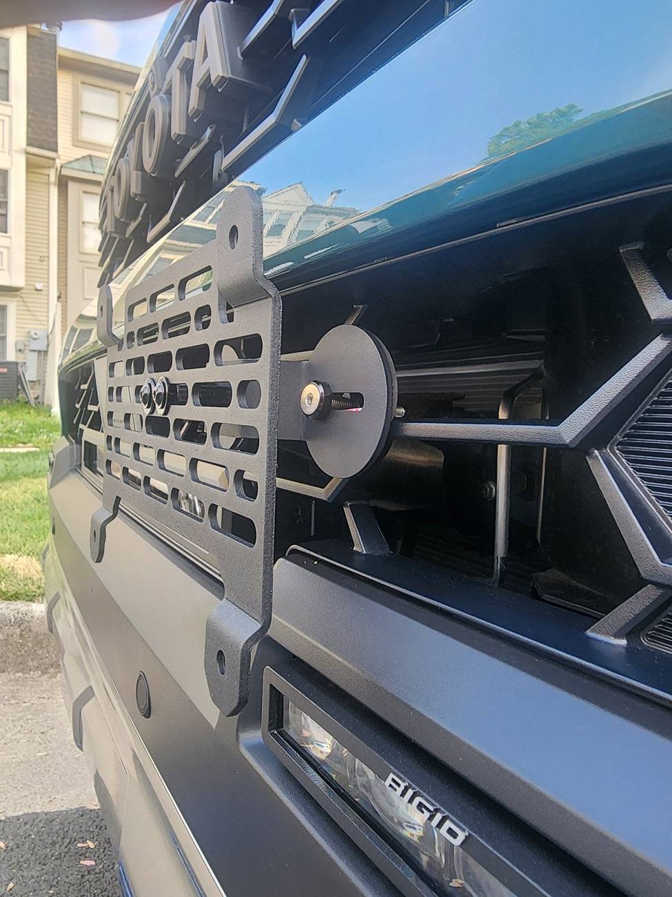

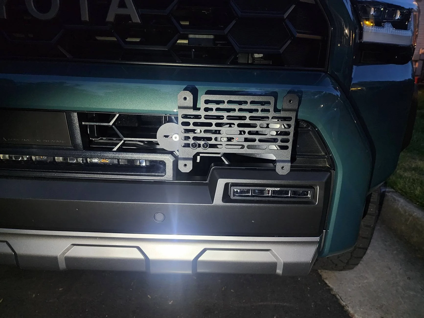

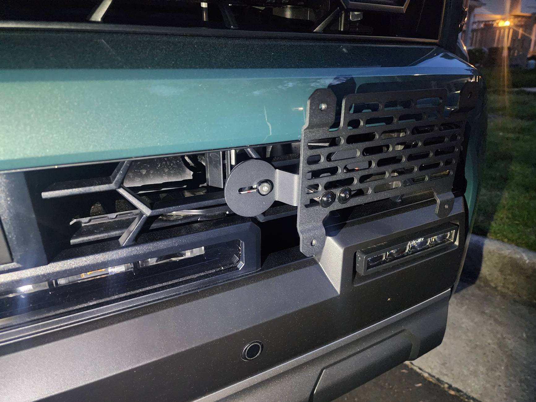

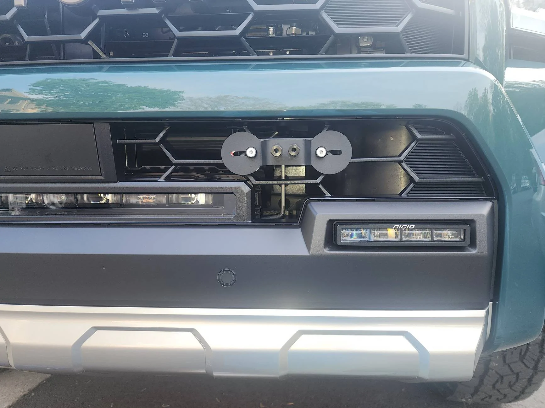

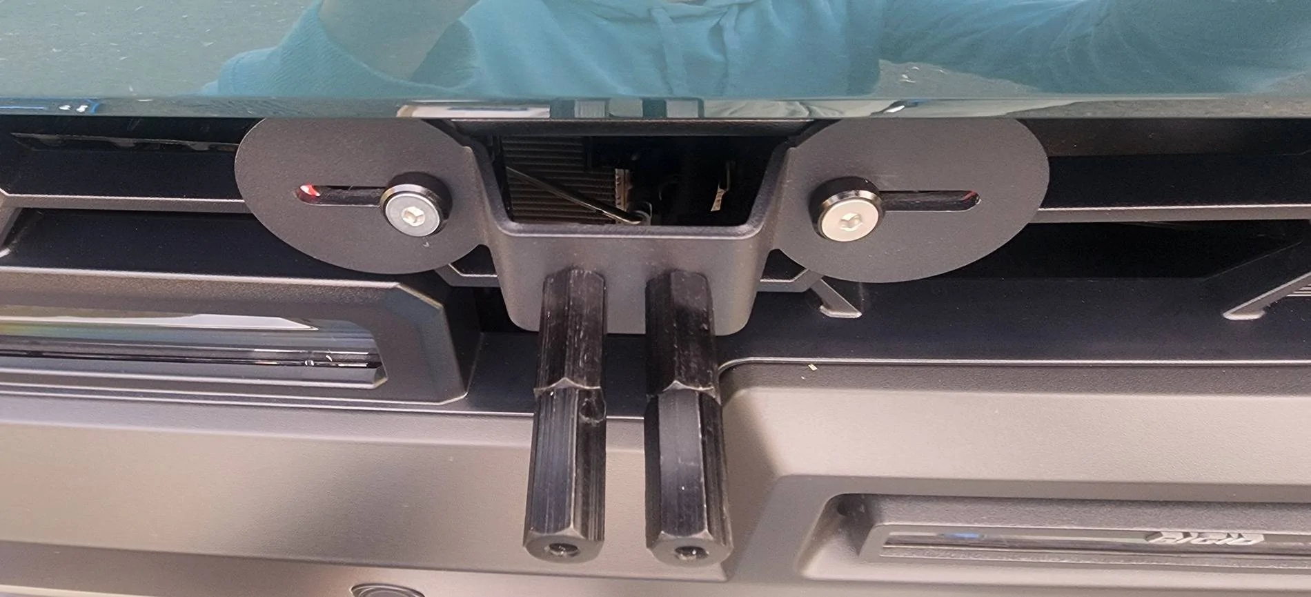

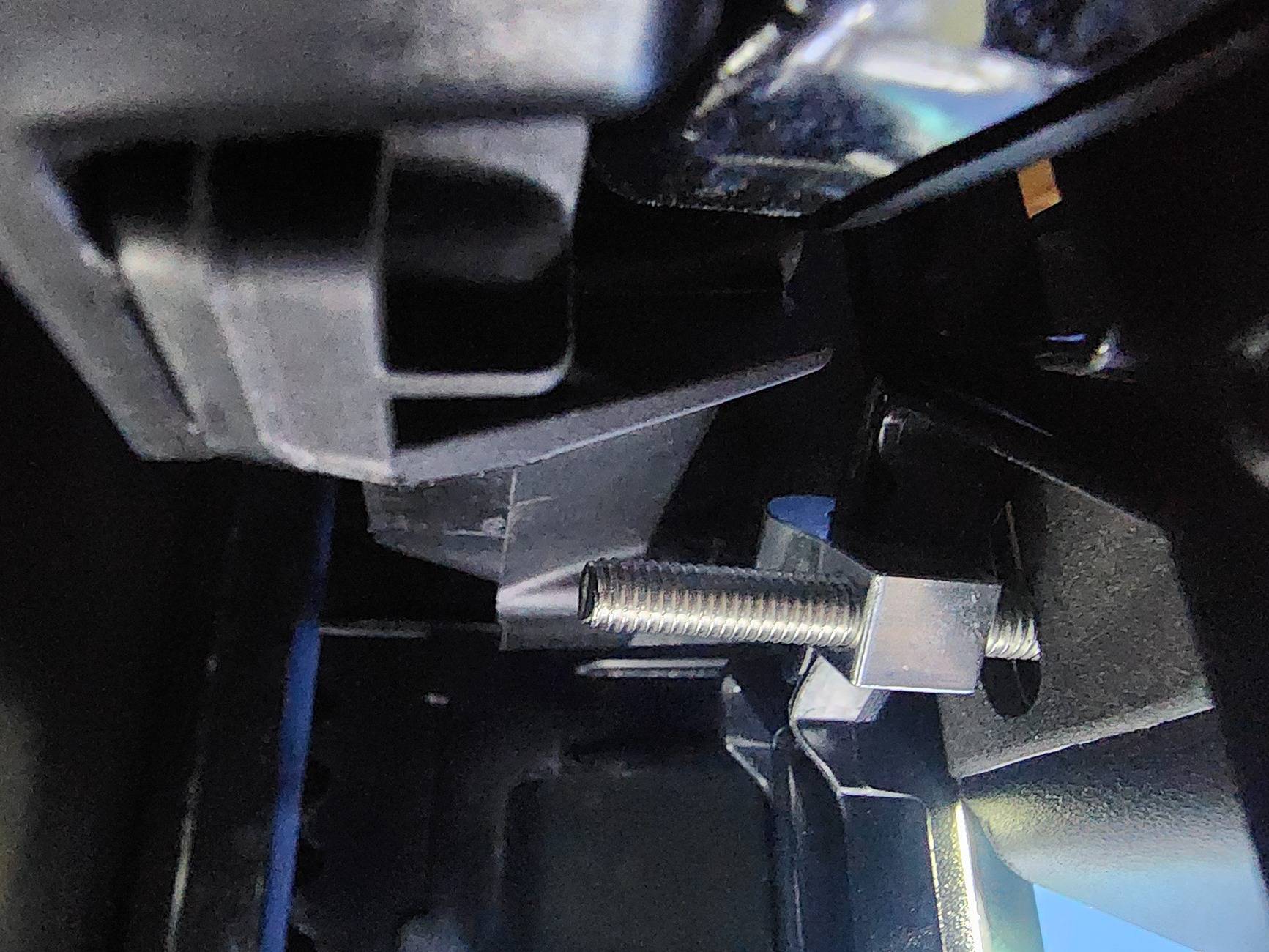

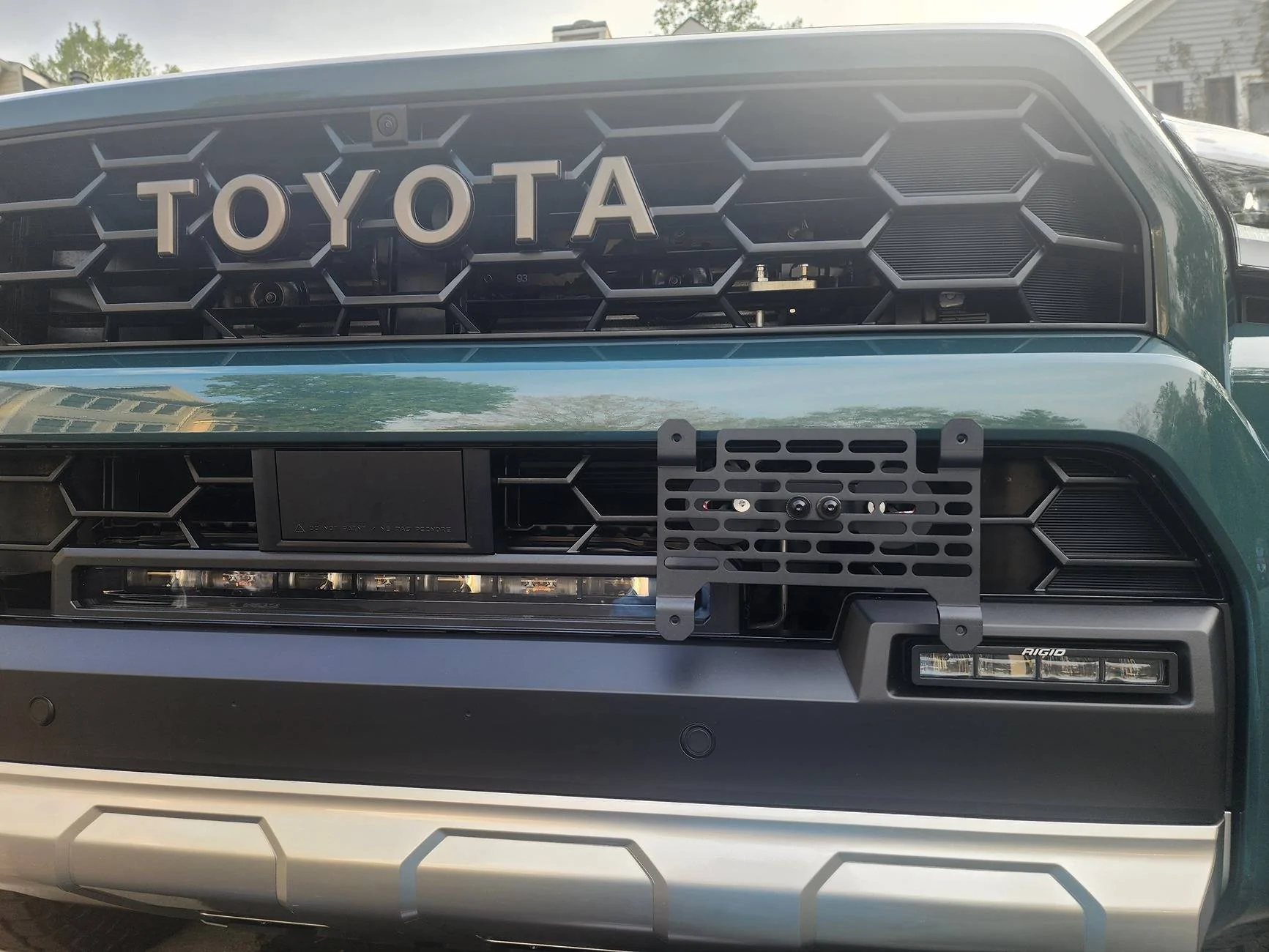

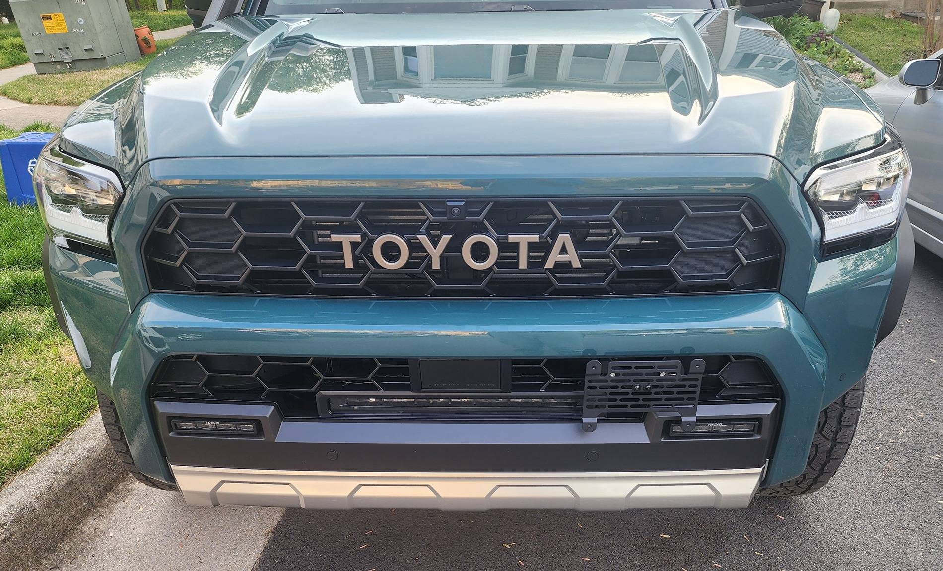

Got this license plate holder to avoid drilling holes in the bumper
https://a.co/d/1bZTNhf
It works well if you thigten each side just enough by hand. Some modification would be to cut the slots slightly more towards the inside.
Also a nylon nut in the back so it won't fall off.
PLEASE DO IT BY HAND. if you use a drill it my crush your grill

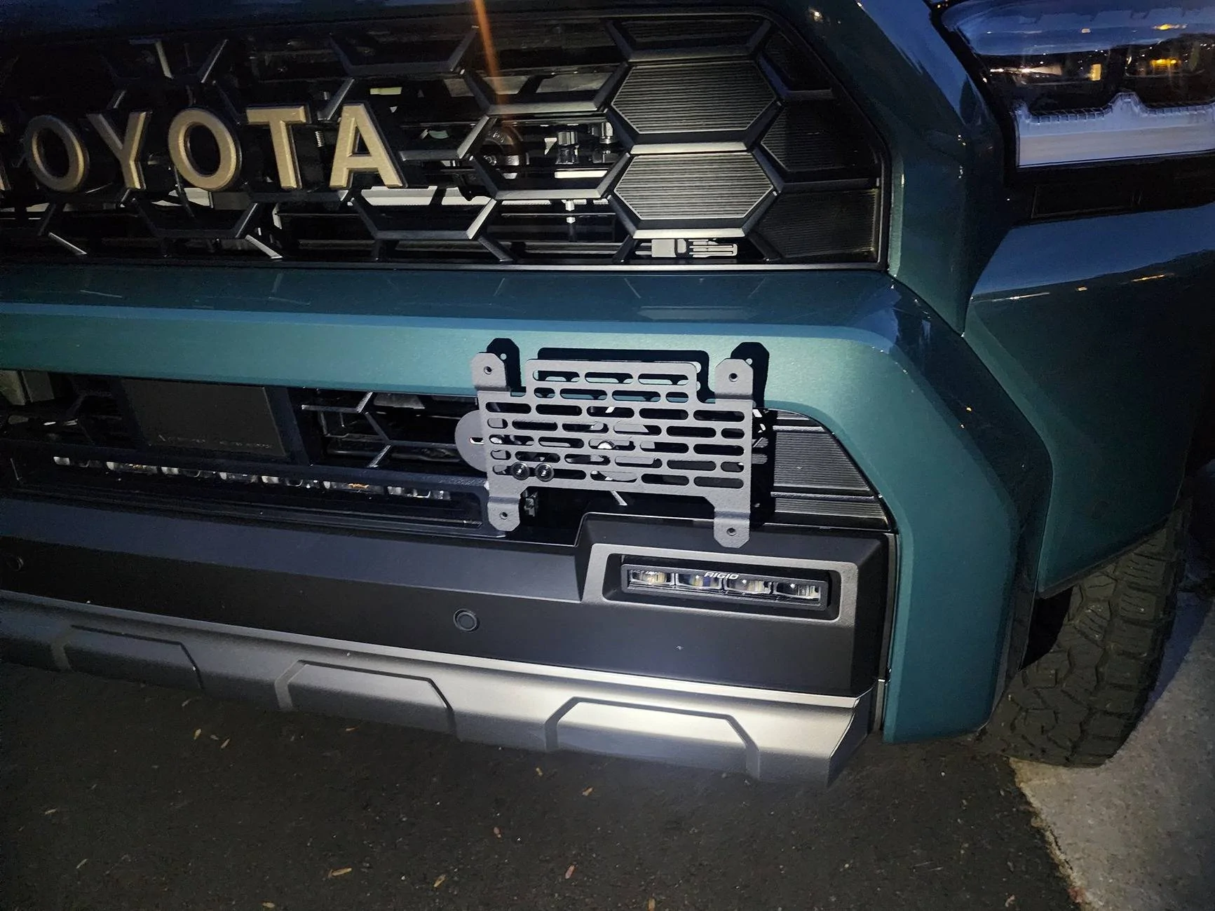

NEW LOCATION:
i think if you move it down one row and over just a tad, it will be enough
here ya go

Thanks for posting! Do you feel it’s pretty solid?

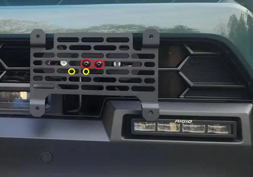

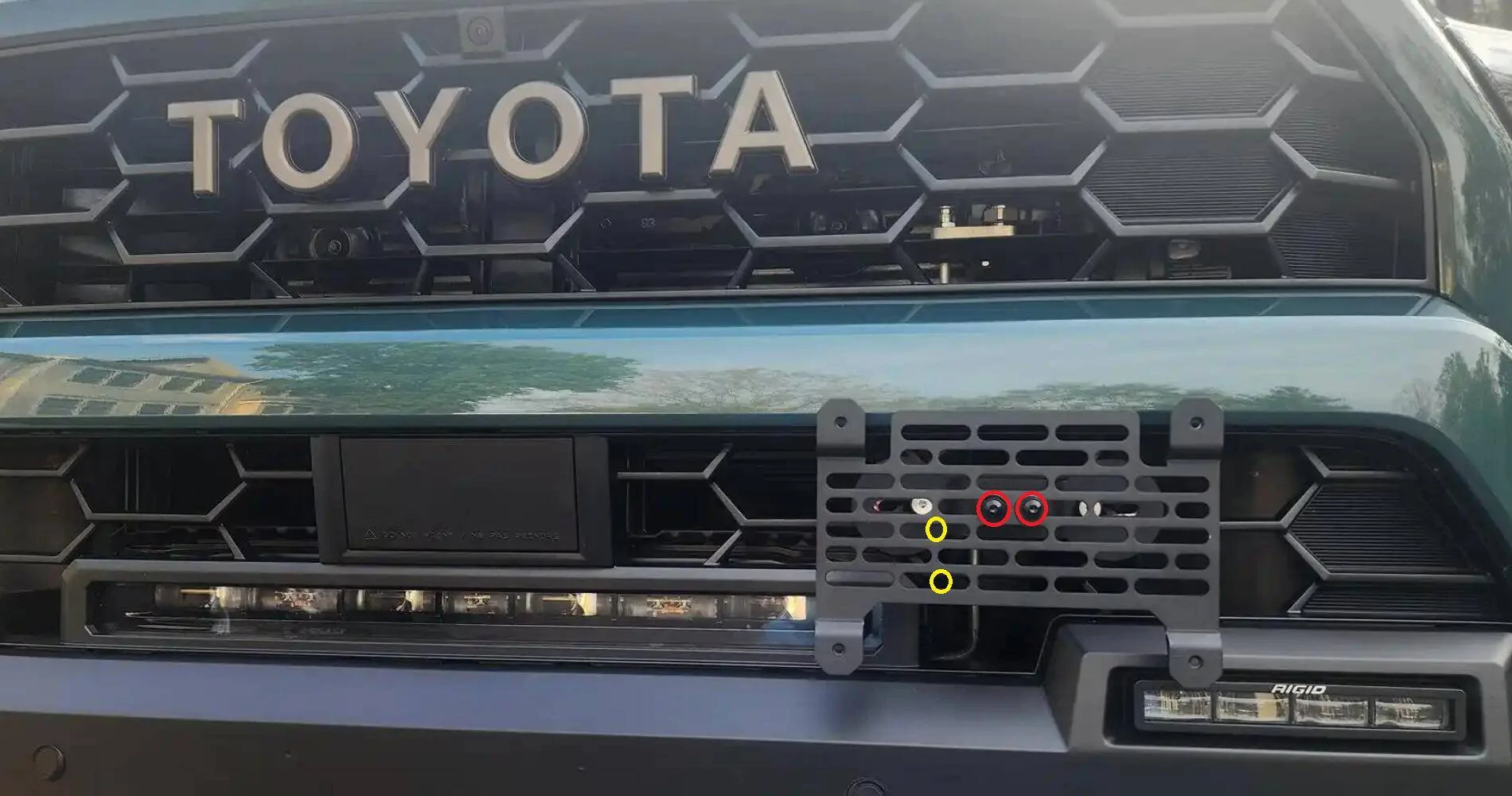

nice bracket but bad placement area. cuts off the fogs lights and light bar slightly and will look really odd/out of place due to placement location.
but thats my opinion.
only thing i can think off
1. move the mount point more to the drivers wheels horizontally
2. move the mount point upwards
move the plate holder so the bolts mount in the yellow locations.

Trust me guys I tried everything to move it out of the way of anything but it would either not grab the grill or be too loose

I would be able to rise the bracket slightly high but as you can see the two screws that are together in the middle cant be moved separately. What I can do is move the plate higher so put both screws together to the yellow spots you mentioned. I will post a pics later today.
2025 2026 4runner 6th gen NO DRILL Front License Plate Holder [Trailhunter + TRD Pro] license plate mounting part 2
