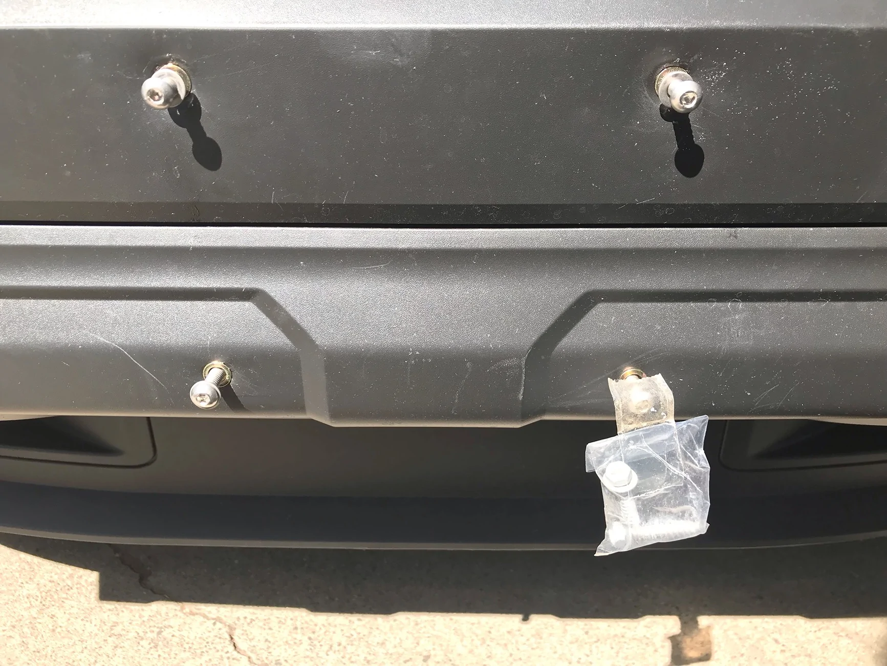

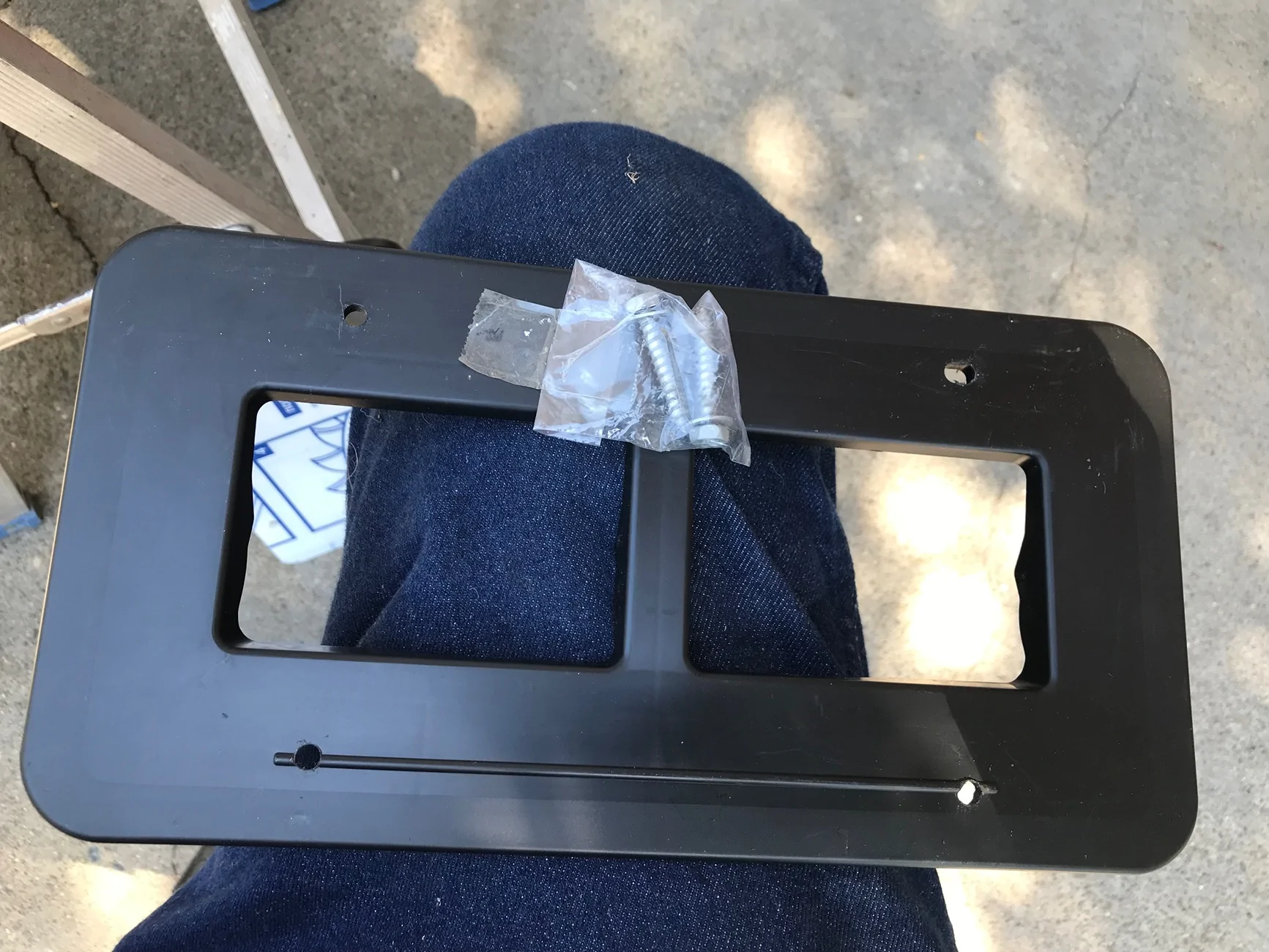

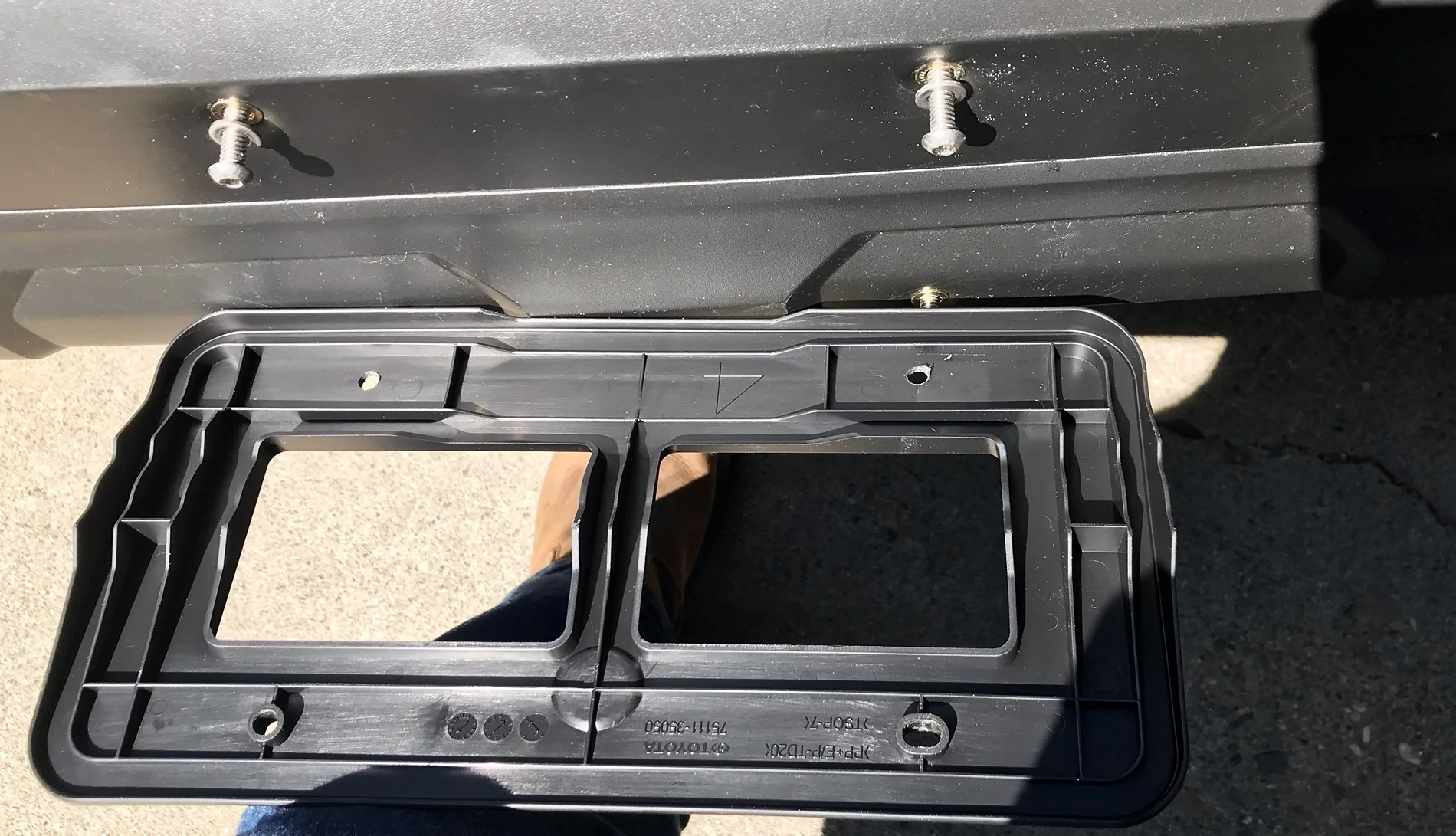

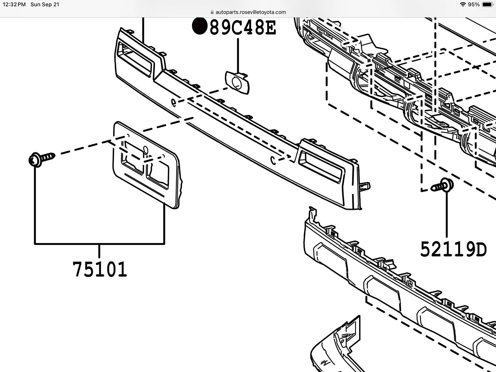

Hello,
How are people attaching the front plate for the TRD Pro? In British Columbia we have to have a front plate.
Expandable Threaded inserts. Dont use the hardware that comes with the plate / bumper bracket. Its two large coarse lag bolts. I internet ordered the bumper mount plate bracket from the local dealer for walk in pickup. The amount i save over just walking in was more than 25%. Even at that it was about $50 American.

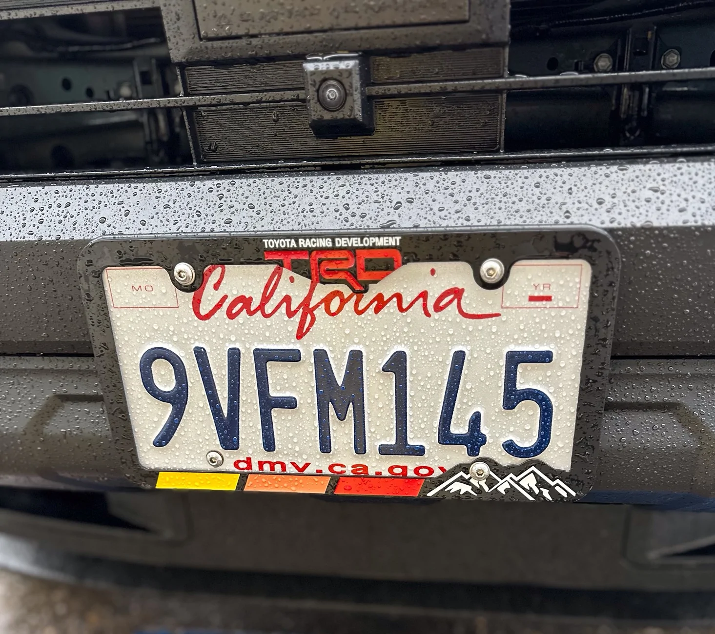

After much deliberation, I just installed the OEM front plate bracket with the OEM hardware. Works for me. I did drill really thin pilot holes in the divots that are pre-stamped in the bumper, despite the instructions specifically saying not to do that!
Normally I go for something drill-free, or just go without the front plate even though it's required. The honest truth is that cheap piano black valance isn't all that beautiful anyway so I didn't feel any kind of way "damaging" it. Also had no second thoughts about using the OEM bolts; they're plenty snug/tight (just don't over-tighten). It could maybe become an issue through many installation cycles, but the reality is this plate went on and probably won't be coming off even once over the course of many years. And, you'll discover that _most_ of the exterior bits and pieces are held on with similar bolts driven into plastic all over the entire vehicle. For example, it bothers me much more that this is what fender flares and mud flaps are held on with than the front plate.
