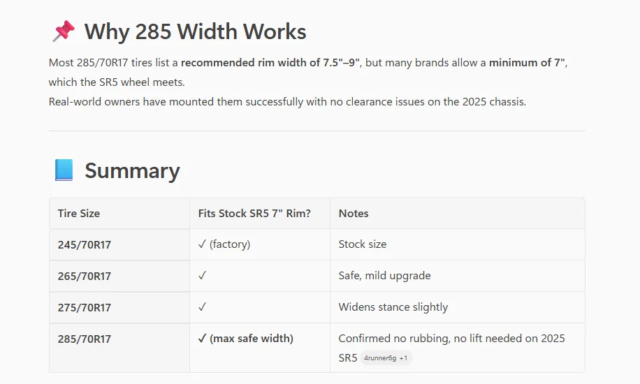

OEM rim on the SR5 is only 7 inches wide. The max recommended tire size is 245.

What I am seeing is the Falken Wildpeak AT4 265/70/17 works on 6.5inch wide rims . So at a minimum you can get 265s from this brand and many others on the SR5 rims.

Toyota SET installs 265/65R17 nitto ridge grapplers as a port option so I believe 265s are fine. I have the above, and would have preferred 265/70r17 if I could have picked myself. Looks better, more side wall and a more accurate spedo.

That is the stock size that comes on the SR5.
If I were you I’d move to the 275 or 285 tires with a 17inch wheel.
