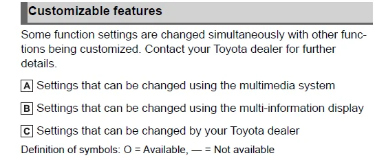

Key owners manual references below:
2025 2026 4runner 6th gen 2026 4Runner SR5 help fix unlocking rear passenger doors with touch unlocking 1785177425715-fx
2025 2026 4runner 6th gen 2026 4Runner SR5 help fix unlocking rear passenger doors with touch unlocking 1785177451533-f

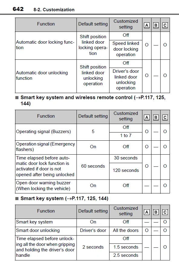

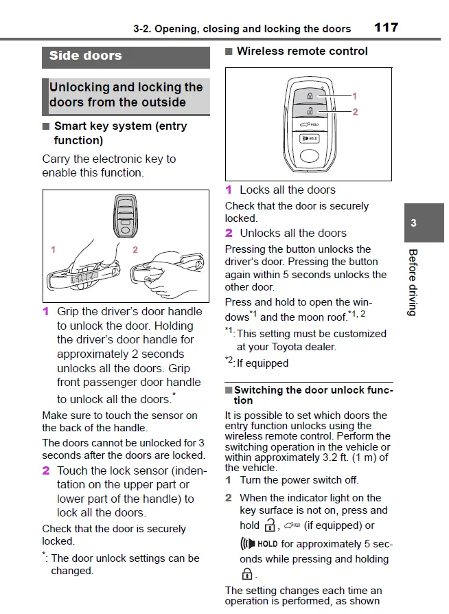

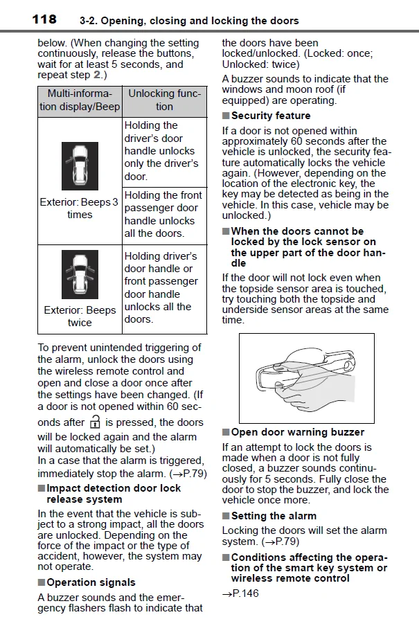

On page 642 below, note the following
2025 2026 4runner 6th gen 2026 4Runner SR5 help fix unlocking rear passenger doors with touch unlocking 1785177831481-oh
2025 2026 4runner 6th gen 2026 4Runner SR5 help fix unlocking rear passenger doors with touch unlocking 1785177526214-mr
2025 2026 4runner 6th gen 2026 4Runner SR5 help fix unlocking rear passenger doors with touch unlocking 1785177801548-vi

I'm not sure I exactly understand the question but I really like the automatic unlocking of the back doors when I touch the inside of the drivers (or front passenger) handle. I'll note that I had the dealer adjust the delay time down to minimum (1.5 seconds per manual) but still hated waiting for back doors to unlock. Then suddenly one day - unrelated to any service on the vehicle - it started working for drivers handle like for front passenger handle: all doors unlocked instantly. I've chosen to be happy with the apparently random update and not tried to hard to figure out what happened (but I am curious).
