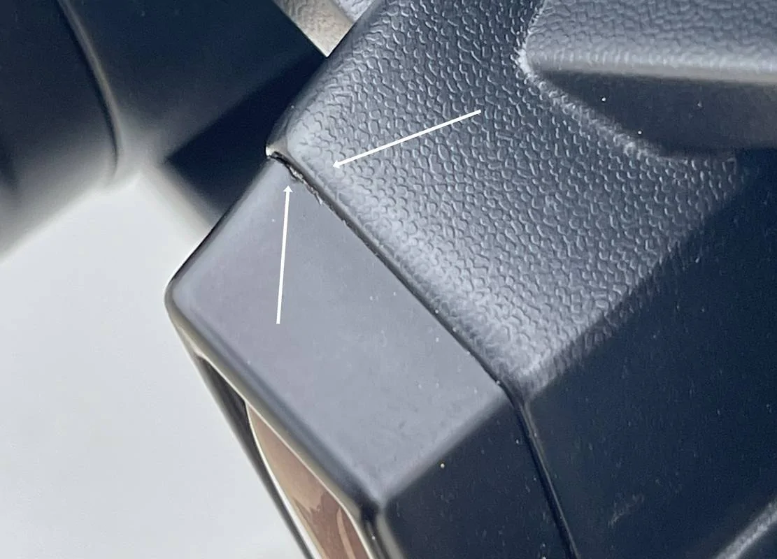

Then (Y) letter from my grill fell off after mini heatwave and strong winds.. Glue did reattach though after holding it w. blue tape. Then when looking closer I saw that some of my front letter overlays had damaged plastic on the edges... also why have bronze overlays over bronze letters??? — dealer is replacing the grill after Toyota field rep inspected it.
2025 2026 4runner 6th gen 2025 4Runner Trailhunter 1300 miles in.. (check before buying) _Overlays-(Y)

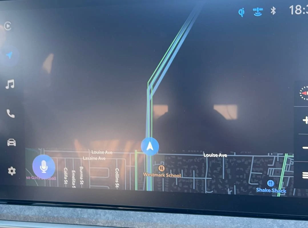

About a week after that there was a glitch in my Navigation system. Streets and names disappeared couple of times. Normally I wouldn't care but during wildfires and mudslides when cell signal is down I heavily rely on it. To no surprise though dealer couldn't find what was causing it.. so I just have to hope it doesn't happen again.

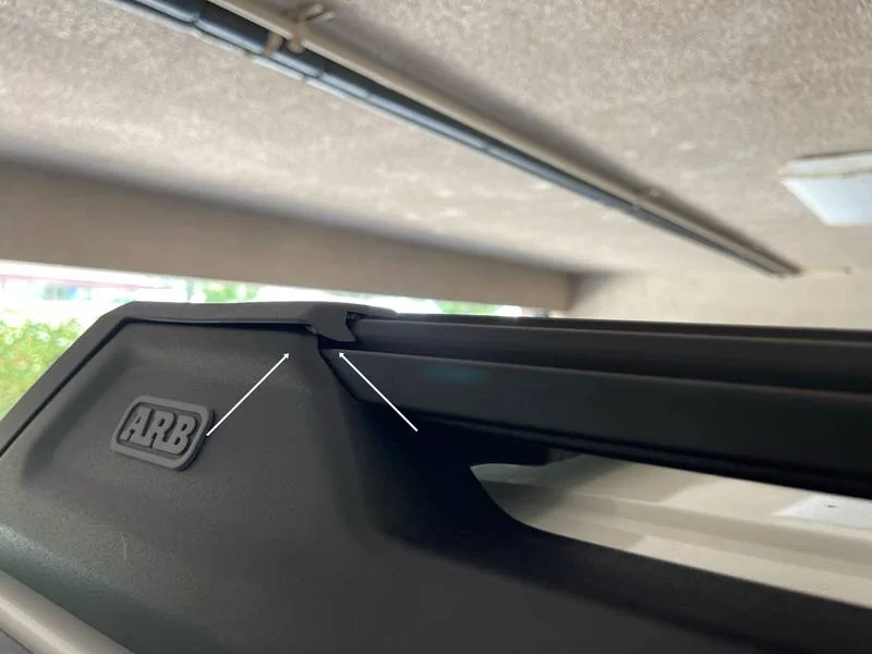

Don't remember where I saw about gaps in fender flares.. but sure enough my car has it on the right rear. Checked another Trailhunter and that car didn't have it. However according to Toyota rep, this is "normal characteristic" and dealer tech tried comparing my car to a Tacoma.. it's not even the same part. Shortly after that I found damage on my roof rack. Luckily I have pictures from my salesperson before I picked up my car that showed the damage.. Pain the butt though I have to wait until another appt w. toyota rep to get it handled..
2025 2026 4runner 6th gen 2025 4Runner Trailhunter 1300 miles in.. (check before buying) IMG_5821

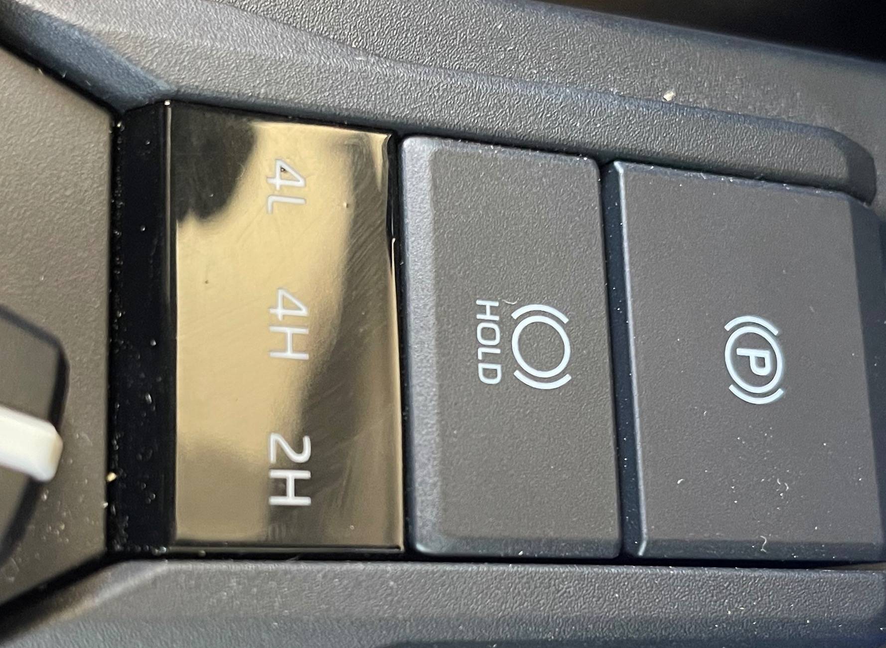

Week or so ago ended up buying film to protect the very scratchable black shiny parts.. and gauge cluster.. when I was wiping down interior came across defect in plastic (4H 2H drive selector).. two pinhole dings.. — dealer is replacing that part as well.. (it's inside the 4 in 4L - in the pic) and (below 4H)
2025 2026 4runner 6th gen 2025 4Runner Trailhunter 1300 miles in.. (check before buying) _Drive Mod

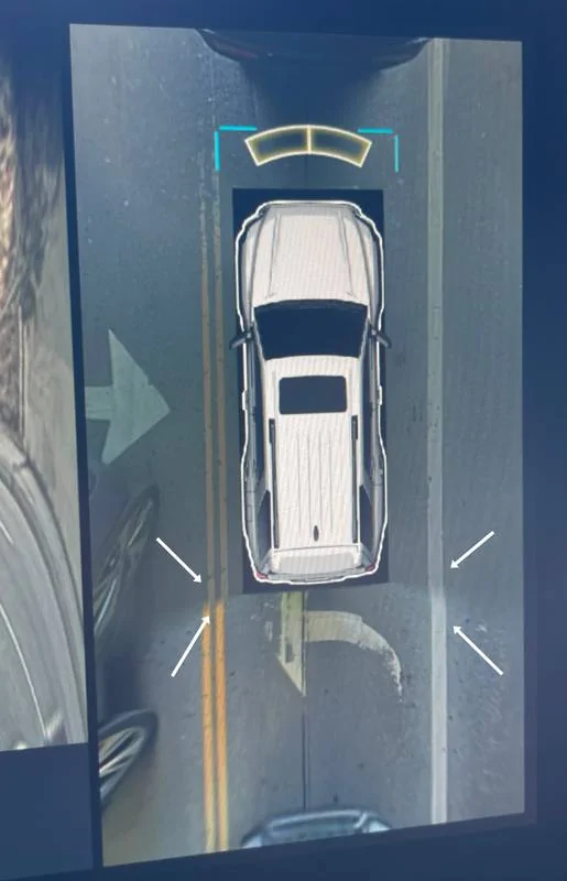

I did notice rear camera distortion early on but thought it was normal until I started to watch reviews of people test driving OR-premium trims.. and that distortion wasnt there. I think when the new suspension was put on the car that lifted it.. they recalibrated the front cam but not the rear. Someone was in the rush to get these cars out.
2025 2026 4runner 6th gen 2025 4Runner Trailhunter 1300 miles in.. (check before buying) _Rear-Camera-4

2 things I did notice but were also (after later checking at the dealer ) on other units were :
-Rear spoiler has quite a bit of play. TRD ORP had it too.
-Air intake has some play as well. TH tacoma had it too.

TechnologyNavigation systemDisappearing street names/map sections
