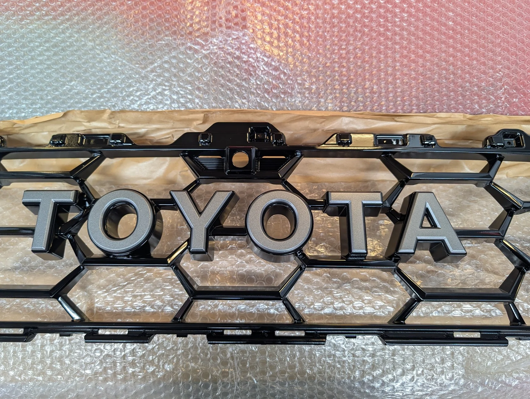

I recently got the TRD PRO top grill and was hoping to swap it out, I'm not doing the bottom grill where most people swap the location of the camera.
Does anyone know where you can get a cover for the camera hole on the TRD PRO grill?
2025 2026 4runner 6th gen Heritage Grill Camera Hole Plug Cover PXL_20251031_190538625

Probably have to get creative if Toyota doesn't sell one. Perhaps an end cap of some type.

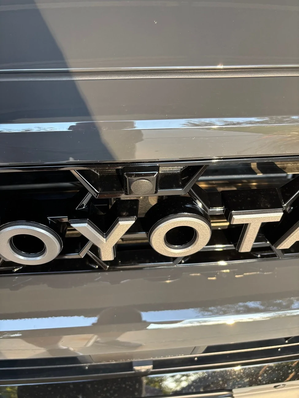

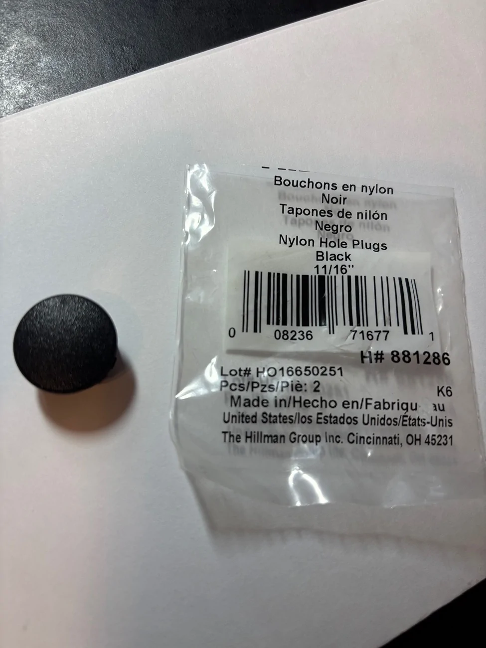

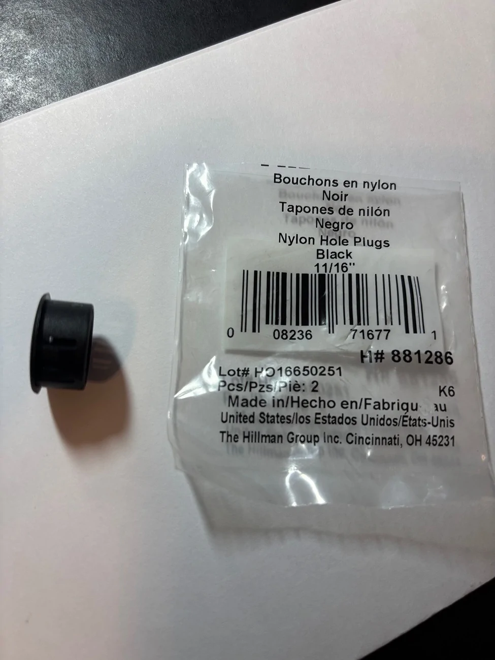

I did the same grill swap. I found these plugs at Lowe's that fit perfectly and super easy to install. Cost -- $1.98 for two. They are not gloss but that is not noticeable.
2025 2026 4runner 6th gen Heritage Grill Camera Hole Plug Cover Grill 3
2025 2026 4runner 6th gen Heritage Grill Camera Hole Plug Cover Grill 2
2025 2026 4runner 6th gen Heritage Grill Camera Hole Plug Cover Grill 1

Wow! This is perfect! I will definitely be stopping by Lowe's to pick me up a pair!

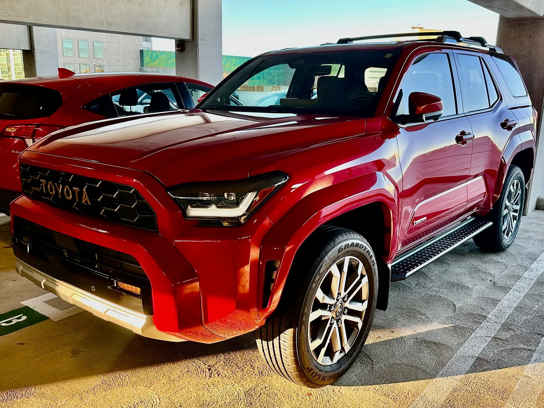

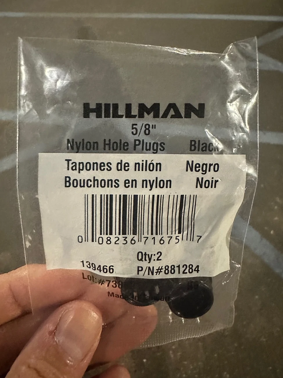

If you get the trailhunter grill with the bronze lettering, the 5/8 plug from lowes was perfect. At first I tried the 11/16 but wouldn’t fit. I thought it was weird that it wasnt the same fit. Overall good find, it looks great!
2025 2026 4runner 6th gen Heritage Grill Camera Hole Plug Cover IMG_0613
2025 2026 4runner 6th gen Heritage Grill Camera Hole Plug Cover IMG_0607

lol I got the 11/16 plug today and for the life of me couldn’t get it in the hole. Was wondering what kind of sorcery ajoelk used to get it in there 🤣. Will be swing by to get the 5/8 tomorrow! Thanks!!
