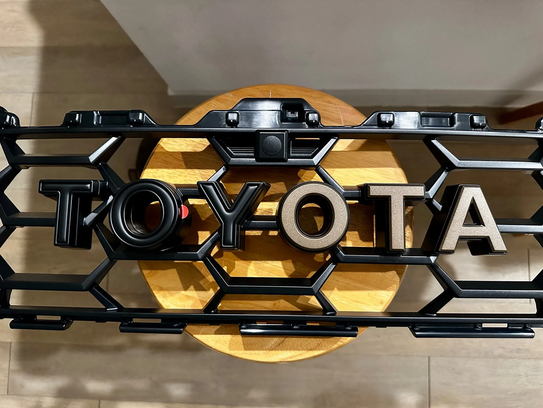

For anyone doing the grille swap, the 5/8” nylon locking hole plug works perfectly!
RedRaiderATX Member Joined May 22, 2025 Threads 6 Messages 18 Reaction score 21 Location Texas Vehicle(s) 4Runner Jan 16, 2026 Thread starter #1 For anyone doing the grille swap, the 5/8” nylon locking hole plug works perfectly! Sponsored
4running Well-known member Joined Feb 7, 2024 Threads 35 Messages 232 Reaction score 313 Location TX Vehicle(s) 2020 4Runner SR5 Jan 16, 2026 #2 This part from Lowes hardware store also works perfect. Credit to @ajoelk for this find. Cost -- $1.98 for two.
