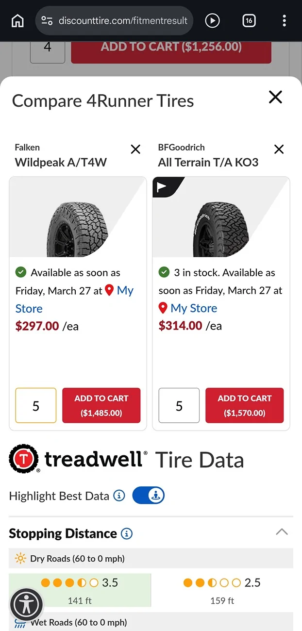

2025 4runner 6th gen 20" XL to 17" KO3 "C", how's the ride? Screenshot_20260327_094610_Chrom
Rodo94
Mar 26, 2026
San Francisco, CA, USA
4Runner 2026 Platinum
The AT4w comes in SL and E, I believe the E is comparable to the KO3 C.
@Cranberry was your issue temperature related?
I do like the look of it for sure, narrower channels…
I checked Craigslist and FB Marketplace, I do see a lot more “new”ish Falkens than KO3s
I don’t go offroading a lot, I’m trying to level out road imperfections + going thru speed bumps, railway crossings… at speed.
I climb on street curbs daily and our streets are coated with all kinds of nails, thanks to roofers and carpenters.
From what I understand, a E load sounds like more problems on the stiffer 6th gen.
From the reviews everyone agrees the KO3 is a quieter and lighter tire. No complaints about highway use.
back to my original question, I believe C is very close to XL in terms of construction, so my ride should be softer in general even with added weight?
I would have to replace all 5 wheels so I don’t want to make a costly mistake.

@Rodo94 Looks like the Yoko XL is 2-ply where the C load BFG is 6-ply, so you'll have a stiffer ride. You can always play with the PSI to make it not so bad. The 6-ply should cause less worry about hitting rough stuff on the road and cause a puncture, but I would not expect to have a smoother ride going from the tire you have now to a beefy all terrain.

the KO2 / KO3 issues were not temperature related. Stopping distance, failure rate and ride quality remained the same in summer vs winter. That being said, when you hit ice, have fun keeping it straight. The BFG's were one of the worst all terrain tires i have ever used in winter conditions. The second we hit any ice they just slide.
In comparison my Duratracs and Falcons i can lock up on our loading ramps at work in winter with no issues, when i had my KO3's on the same ramp it needed a running start or it would slide back down with all 4 wheels locked.
