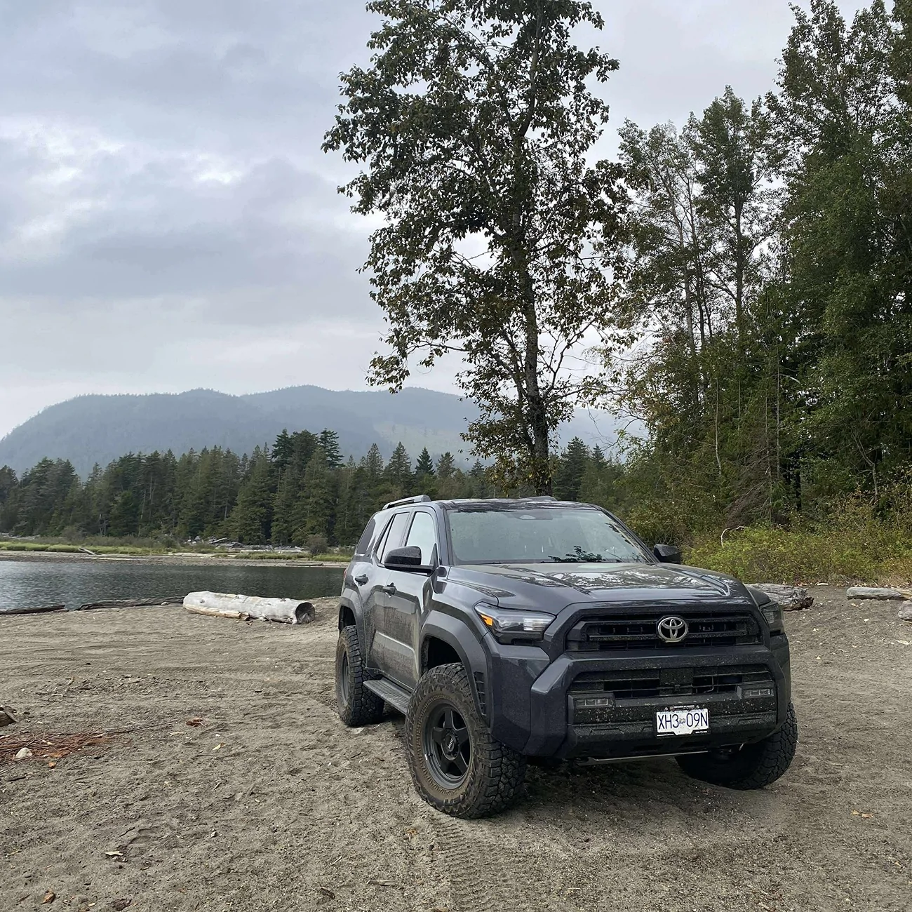

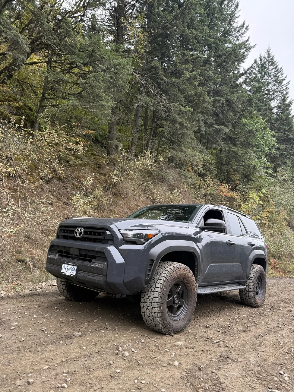

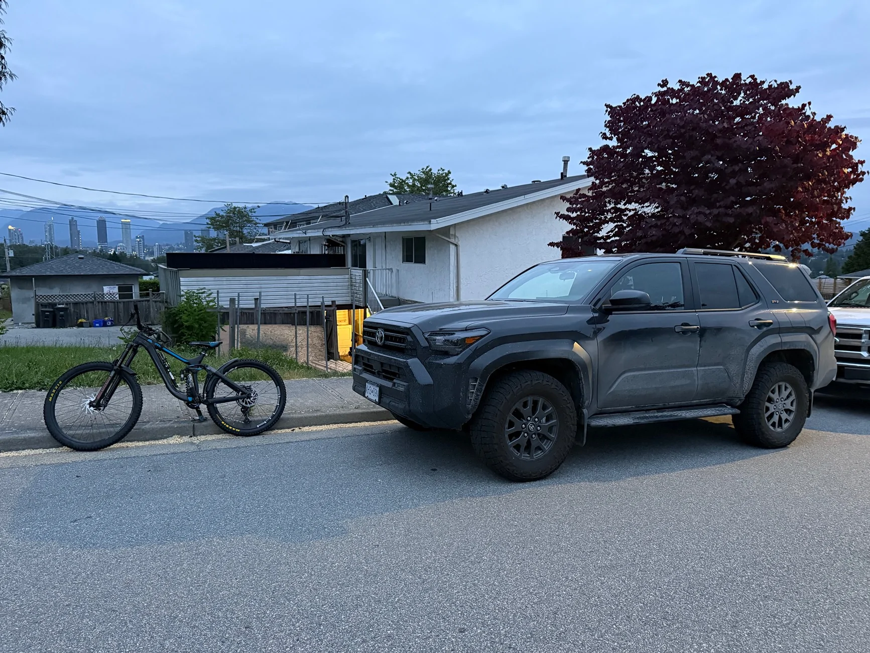

I got a kmc 728 lobo 17x8.5 +18 offset
With wescott design lift 285/70/17 falken wildpeak and no rubs at all full turn
And it pokes around 1 inch.
But it looks good with the poke

It shouldnt. Cuz i think thats the sweet spot for the offset with no poke. Check mjmotorsports808 on instagram you’ll see some of their post with the offset
