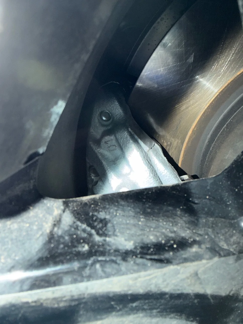

For those who are running 17” wheels did you notice there was barely any room between the wheel barrel and top of the caliper?
I did a test fit with 5th gen trd off road wheels (winter set from previous car) and was planning on buying the narrow m14 lugs from raveoffroad. Calipers will be cleaning the wheel from snow lol

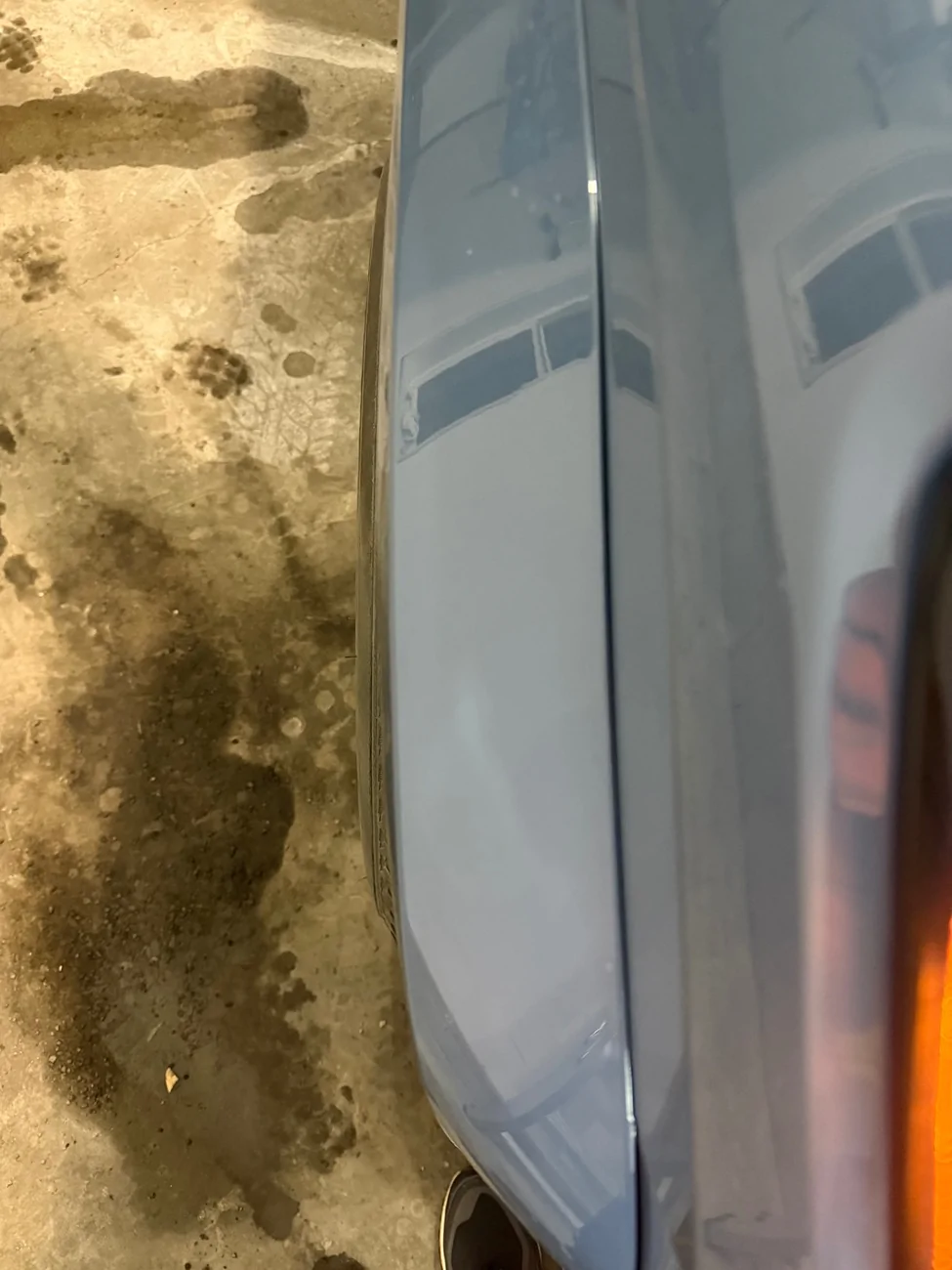

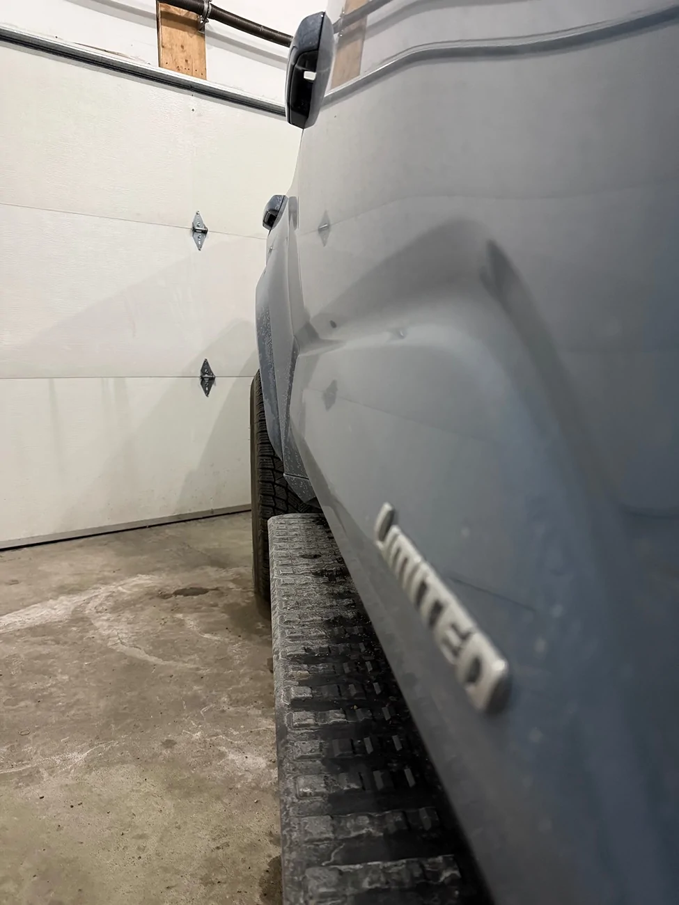

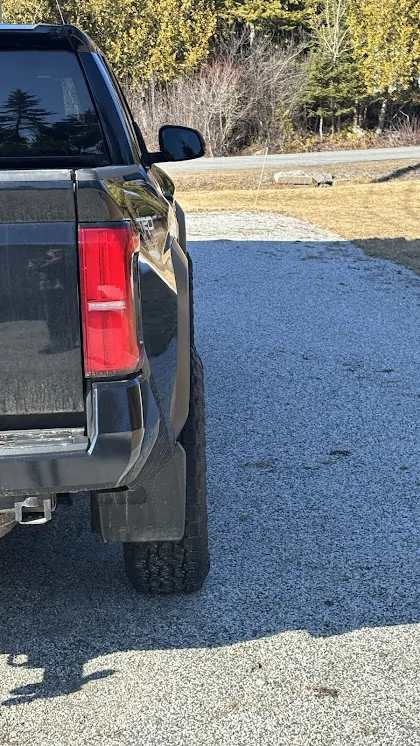

If anyone was curious. I managed to fit the 5th gen wheels on. Has minimal poke.
What's the offset on these wheels?

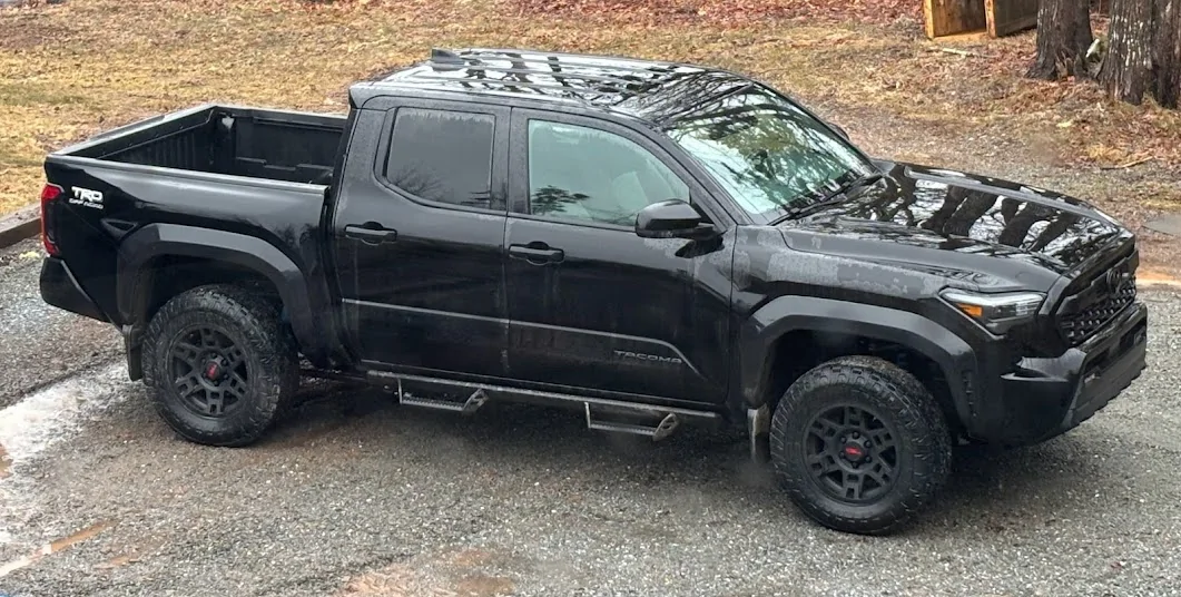

I have the TRD wheels with the +4 mm offset on my Taco plan to put them on my 4Runner whenever a TRD ORP that's not white or heritage blue arrives at the dealer. On the Taco, they poke out a little, I with they were flush.

These are +15 on 265/70/17 winter tires.

I received my 4Runner TRD ORP at the end of May. Fredericton Toyota didn't want to install the 17" wheels on the 4Runner claiming there wasn't enough clearance around the callipers. But I see 17" wheels on here all the time.

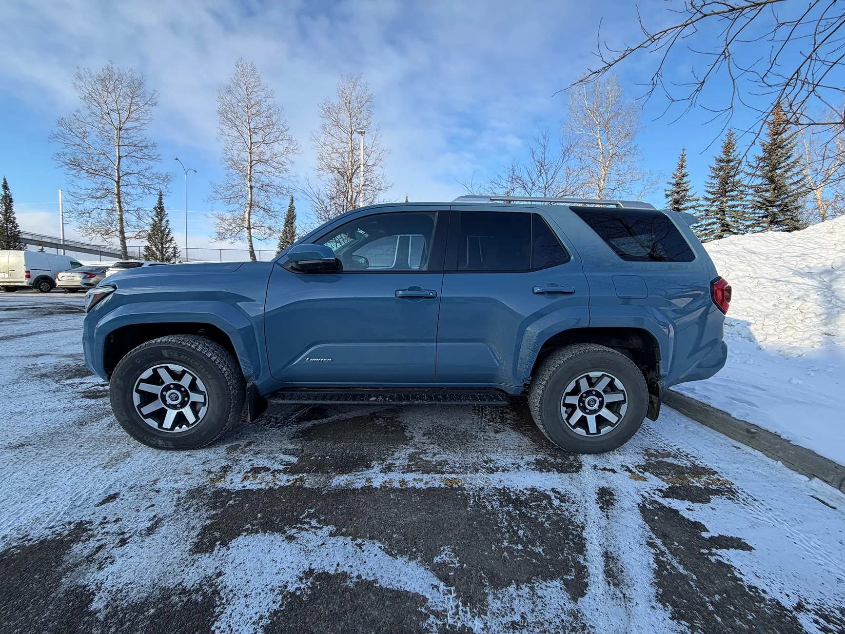

4Runner SR5 and certain Tacos come with 17" wheels, don't they? Same brakes and everything. I wouldn't stress about it tbh.

I haven’t had any issue with mud and dirt from off-roading with the SR5 wheels. Deep snow or slush/ice never made any noise or issues either.
I do feel like the OR/Pro/TH having 18” wheels might have been for a reason though and could be worth keeping some extra room if your doing a lot of off-roading.
