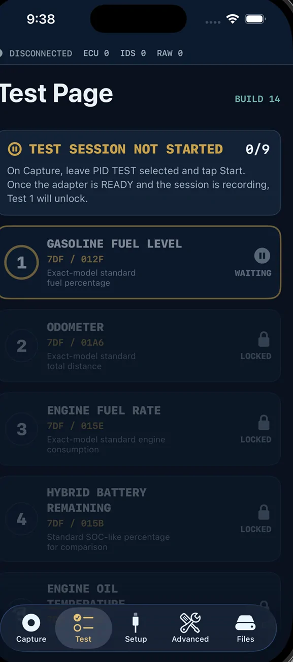

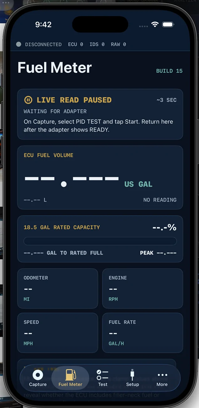

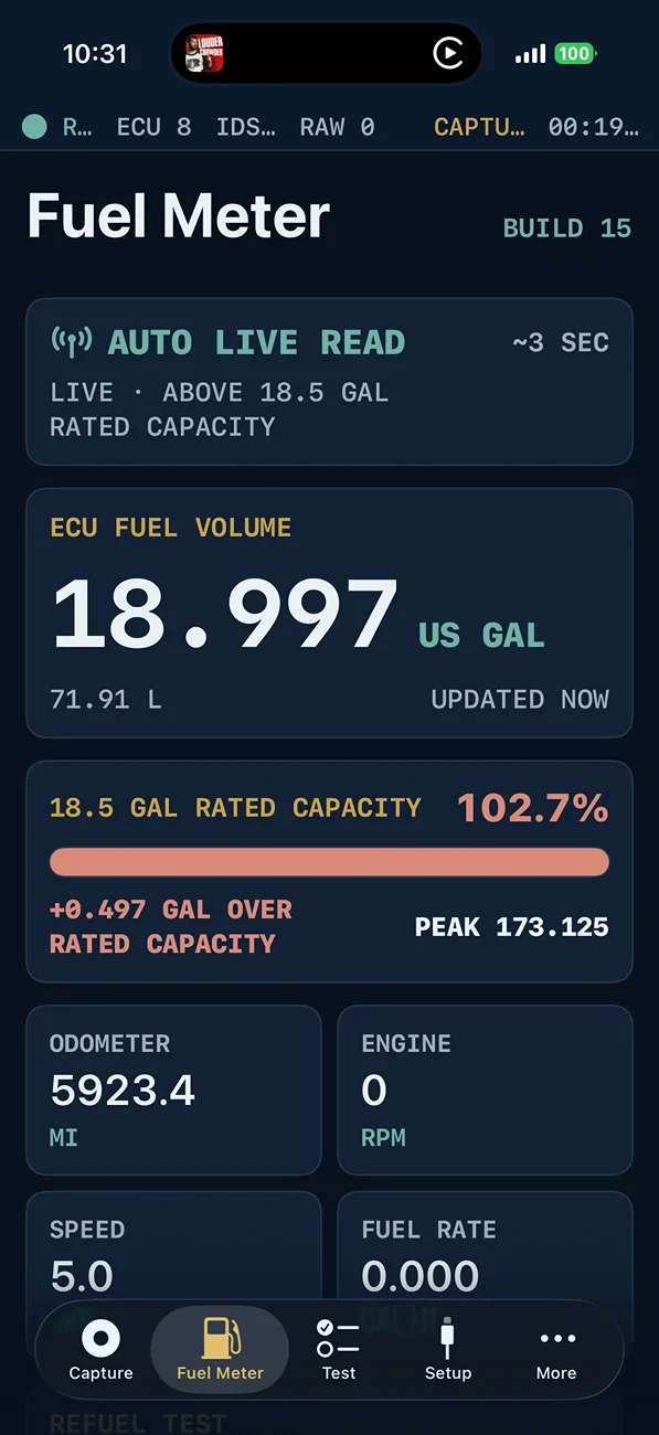

I have not written code in over 20 years, though I'm an engineer and work in the tech sector. But with all the AI vibe coding, it's really gotten me interested in writing apps. In fact, I even have an app on the Apple App Store now (AI Tagging App/Plug in for Adobe Lightroom).
So I decided to see if I could write an app for the sixth gen 4Runner based on the things that I'm interested in seeing. So I started developing it and the biggest issue I came across is that the PID and CAN bus information is sparse. So I built a small sniffer app that I ran for a couple days collecting data off the ODB2 Bluetooth adapter I have and my friends at the local Toyota facility who helped me with the Techstream app information.
I've done my initial test and the initial build of the app is really going to be around fuel, average miles, and general information that I can collect, eventually building out a full trip app and overlanding app.
I may make the fuel app available in the App Store, and I can actually make that an Apple CarPlay app. Apple has a lot of restrictions on what can be on a CarPlay screen, so my full overlanding app can't go there. But it can go on your iPad or on your iPhone. So I just wanted to show people what I started, what I have, and if anybody's interested, let me know. And if there’s things you'd like me to add, let me know.
One interesting thing I found is that the car does report the actual gallons to the thousandth in the tank.
I've added a couple screenshots so you can see what I'm doing on the app and what it's collecting.
2025 2026 4runner 6th gen Building iOS App for 6th Gen (fuel, average miles, and other data) IMG_2907
2025 2026 4runner 6th gen Building iOS App for 6th Gen (fuel, average miles, and other data) Screenshot 2026-07-25 at 9.38.01 AM
2025 2026 4runner 6th gen Building iOS App for 6th Gen (fuel, average miles, and other data) Screenshot 2026-07-25 at 9.42.09 AM

Very nice! By chance, have you been able to integrate it with the OBDLink? I just bought one and still tinkering with the apps that can link via Bluetooth. I’d like to see temperatures - engine, oil, intake, cold and hot off the intercooler, transmission, etc.

I've done all my testing is with the vGate vLinker MC+. All the data you are looking for is available in the TechStream app (which is the one the Toyota service centers use). I am slowly capturing all of them so I can add other things to this app or another larger app I am looking at building
once its stable I might do "beta" release so people can test with various adapters so I can add them.

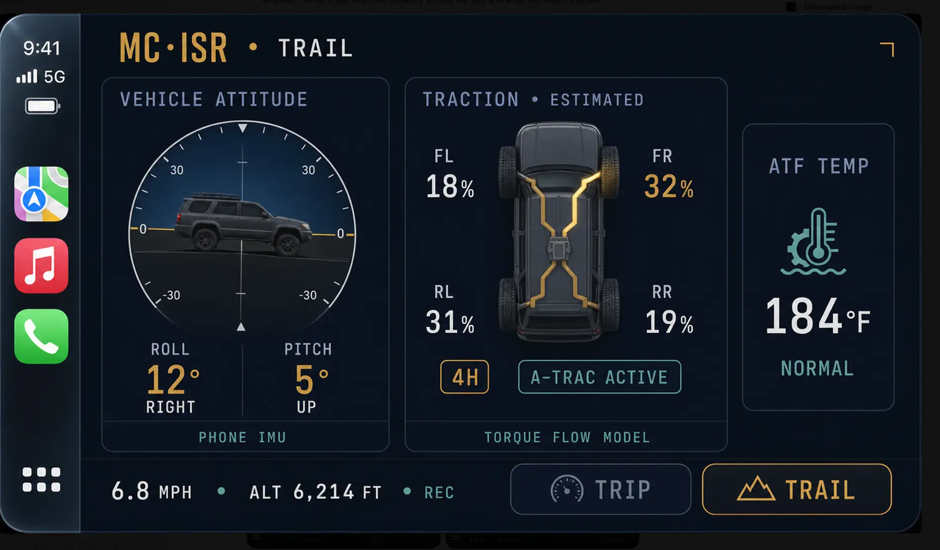

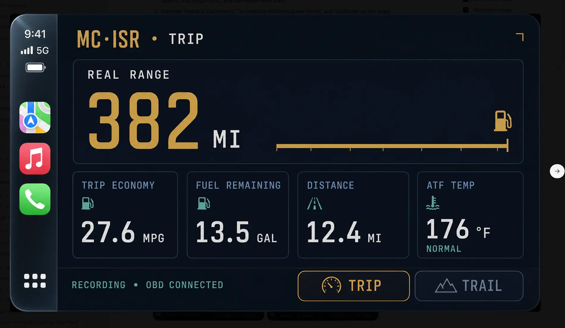

Great....I am working through a few details now figuring out how to set things up with "test flight" which allow me to give people beta versions to test....standby
Also just mocking up some car play screen now
2025 2026 4runner 6th gen Building iOS App for 6th Gen (fuel, average miles, and other data) Screenshot 2026-07-26 at 11.37.29 AM

Love the mockup. I also use CarPlay the full screen widgets look great!

Very promising!
I hate my fuel gauge bar display with 4 segments that my center screen shows. I would love to see more accuracy - as your ideas seem to show.
I am curious about the last set of mockups. I’m wondering if the “fuel remaining 13.5 gal” and the “updated now 18.997 gal” displayed to the thousandths would both be available in your finished product.

The vehicle knows the roll and pitch, why pull that data from the phone? The phone has its own offset from the vehicle depending on where its mounted.

I don't know if I’ll have it in the thousands in the final designs,. , although that is the level of detail that the system does provide. I may make that an option in the settings so, individuals can decide accurate they want it to be.
Also, working on a better true distance to empty based on the actual driving at the time
