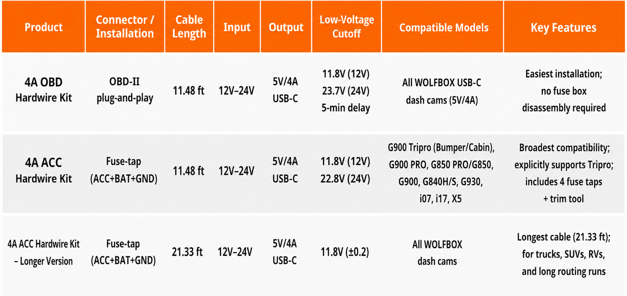

Hi everyone,
In this thread, we’ll introduce three of the most popular Wolfbox hardwire kits, including their key specifications and compatible dash cams.
Understanding these details will help you choose the right hardwire kit for your vehicle and dash cam. At the end of this section, you’ll also find a comparison chart of all three kits, making it easier to see the differences and choose the one that best fits your needs.
Hardwire Kit Types
WOLFBOX USB-C 4A OBD Hardwire Kit, 11.48 ft
This is a plug-and-play hardwire kit with an OBD-II connector, eliminating the need to access the vehicle's fuse box. It accepts a 12V–24V vehicle electrical input and delivers a stable 5V/4A USB-C output, with a total cable length of 11.48 feet. The low-voltage protection threshold is set at 11.8V for 12V systems and 23.7V for 24V systems; when voltage drops below the threshold, recording continues for 5 minutes before power is fully cut, allowing the dash cam sufficient time to save files. The kit is compatible with all Wolfbox USB-C dash cams rated at 5V/4A.
WOLFBOX USB-C 4A ACC Hardwire Kit, 11.48 ft
This is a fuse-box-tap 4A hardwire kit. It accepts a 12V–24V input and provides a 5V/4A USB-C output over an 11.48-foot cable. The low-voltage cutoff is 11.8V for 12V systems and 22.8V for 24V systems. It is compatible with all Wolfbox dash cams and mirror dash cams.
Installation requires three connections: the red wire to ACC (switched ignition power), the yellow wire to constant power (BAT), and the black wire to ground. The package includes four different fuse-tap adapters and a trim removal tool, allowing a reversible installation without cutting the vehicle's factory wiring.
WOLFBOX 4A USB-C Hardwire Kit – Longer Version, 21.33 ft
This is the extended-length version of the 4A fuse-tap hardwire kit. At 21.33 feet, it has the longest cable among the four options and is designed specifically for trucks, SUVs, RVs, and other large vehicles, or for any installation requiring an extended cable run.
It accepts a 12V–24V input and delivers a stable 5V/4A USB-C output, with a low-voltage cutoff of 11.8V (±0.2) that automatically shuts off power when the threshold is reached. The kit is compatible with all Wolfbox dash cams.
Installation follows the same fuse-tap method: red wire to ACC, yellow wire to constant power, black wire to ground. The package includes four different fuse-tap adapters and a user manual, with no cutting of the vehicle's factory wiring required.
