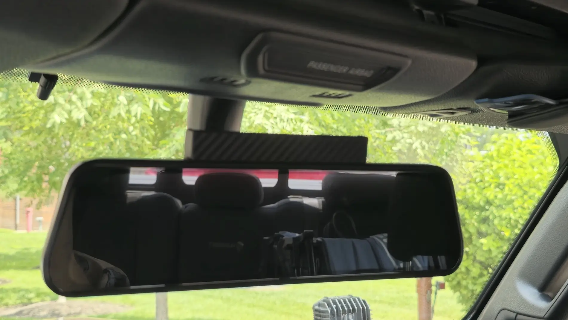

@Wolfbox - As an update to this, it turns out that the (more robust looking) universal mounting arm doesn’t work on the 6th Gen 4Runner. At least I couldn’t figure out how to make it work… The shorter length compared to the Toyota (technically Camary) specific one makes it impossible to connect the wires at the top and have the mirror oriented in a position that makes sense. Even when using right angle adapters, there isn’t enough clearance between the top of the mirror and the headliner. Unless I’m missing something…

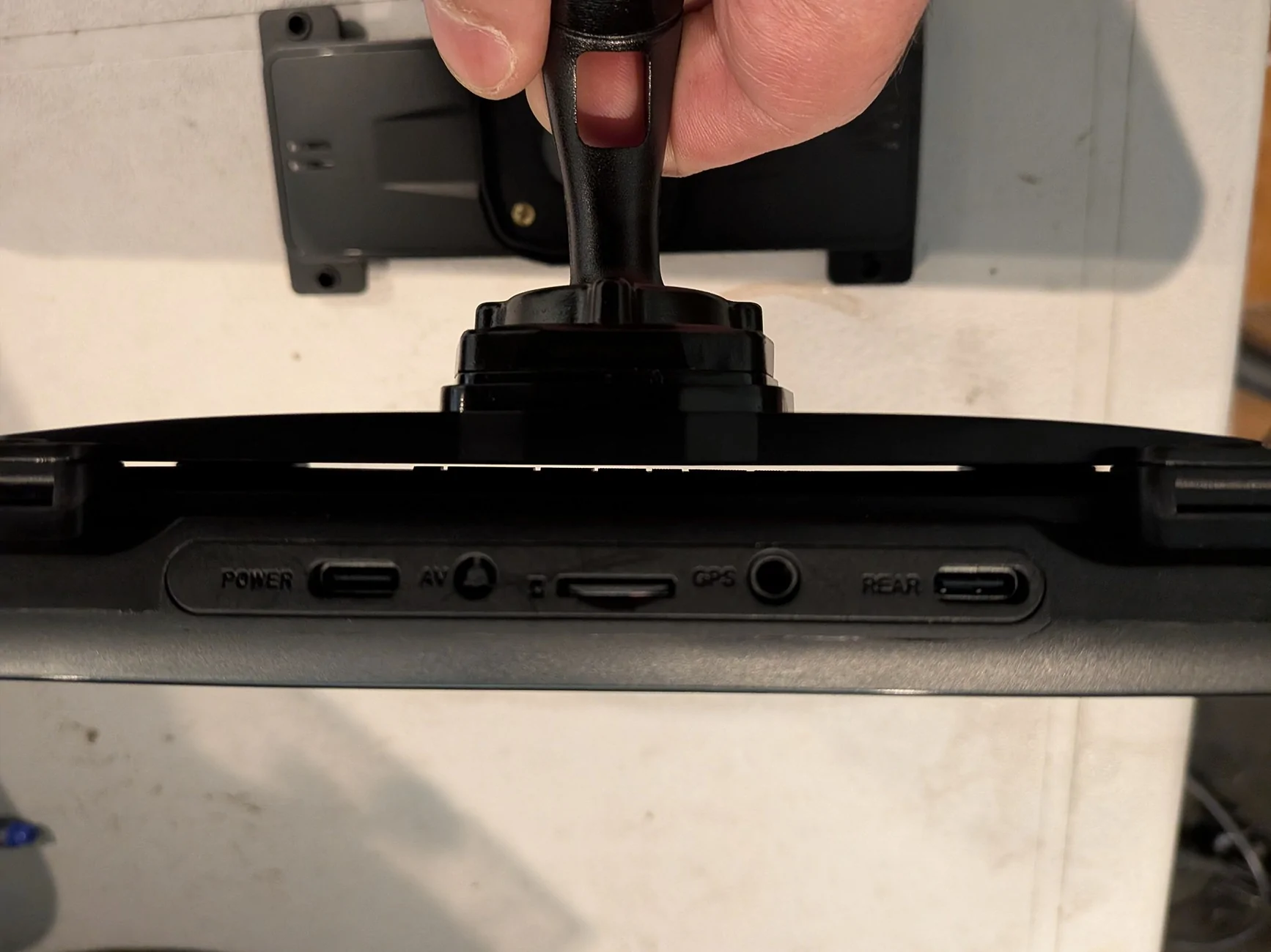

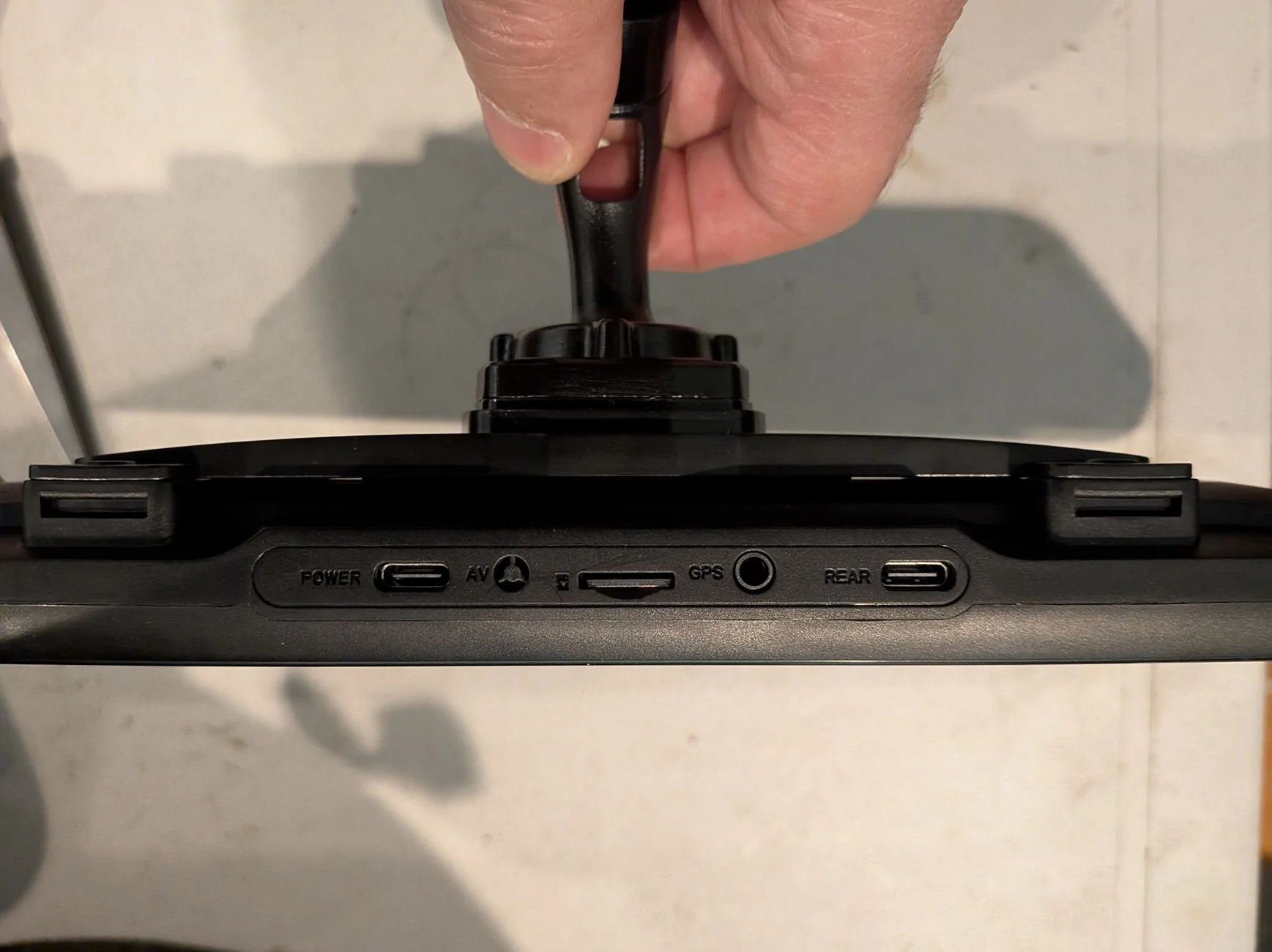

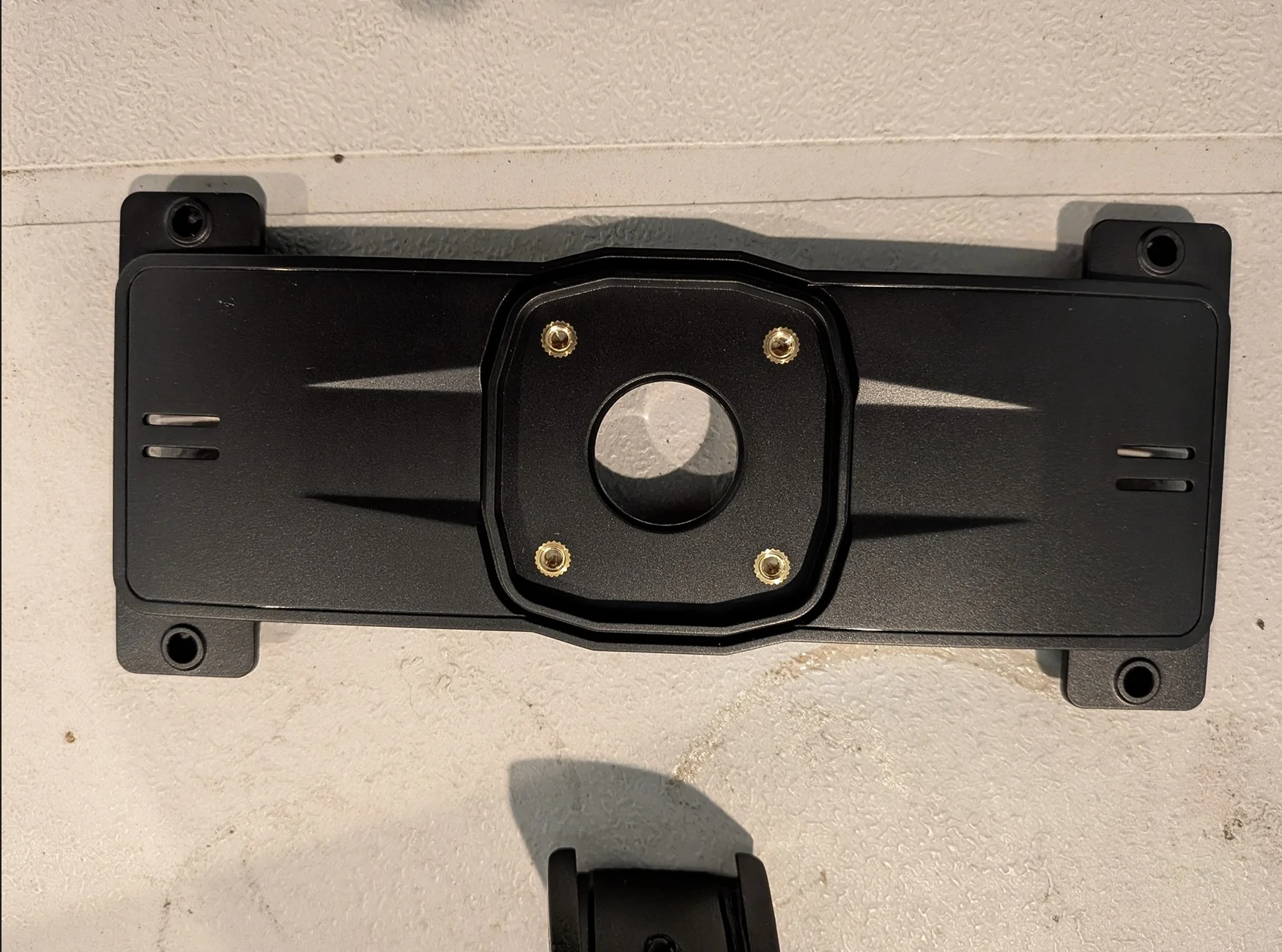

But what I also realized is the vibration I see in the mirror wasn’t due to the arm, but more the mounting plate (1st screenshot). The material is too flexible and it doesn’t mount flush to the back of the mirror, creating a gap that that allows the mirror to vibrate (2nd screenshot).
I was able to mitigate this slightly by placing a scrap from the material I used to line my toolbox drawers (I think I got from Harbor Freight). But it’s not ideal (3rd screenshot).
Would be great if you guys were able to make these from a sturdier plastic. Or even better, a lightweight metal.

Thanks for your feedback. You can contact the customer center for a #190 bracket, that should be more suitable.
We will improve the plate. Thanks.
