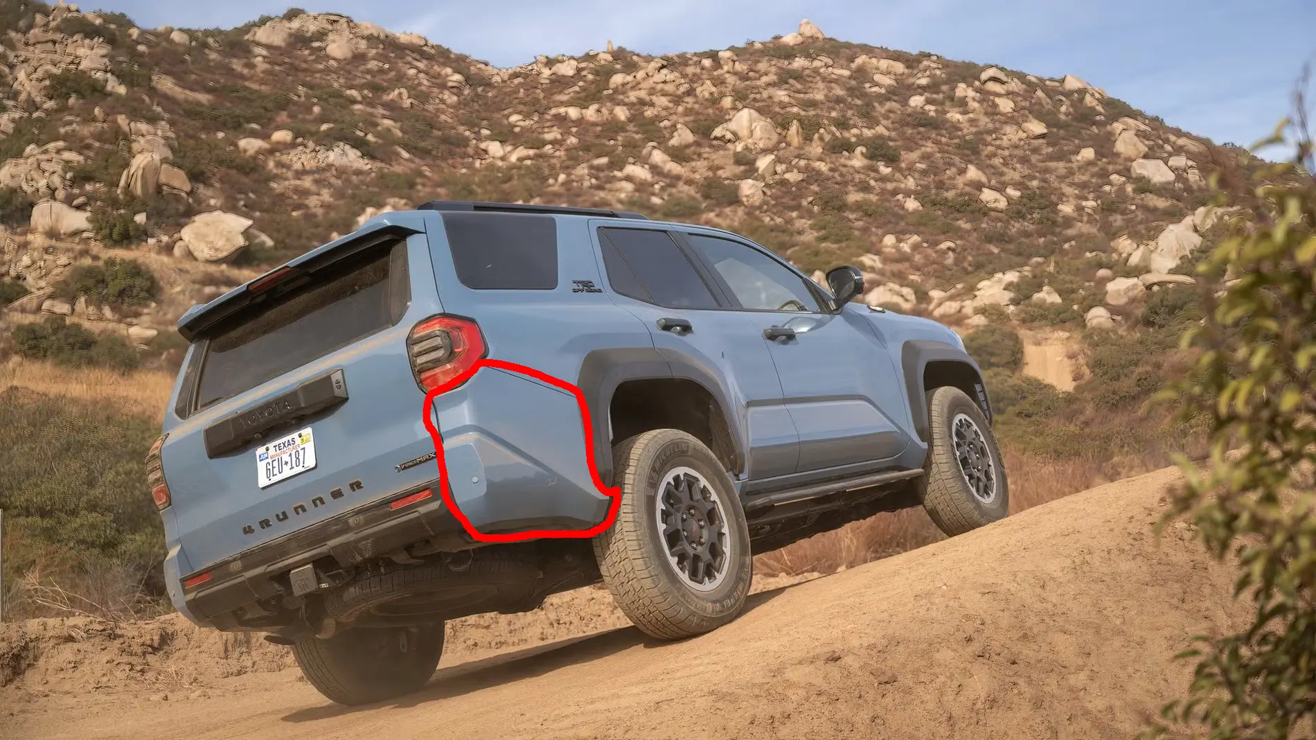

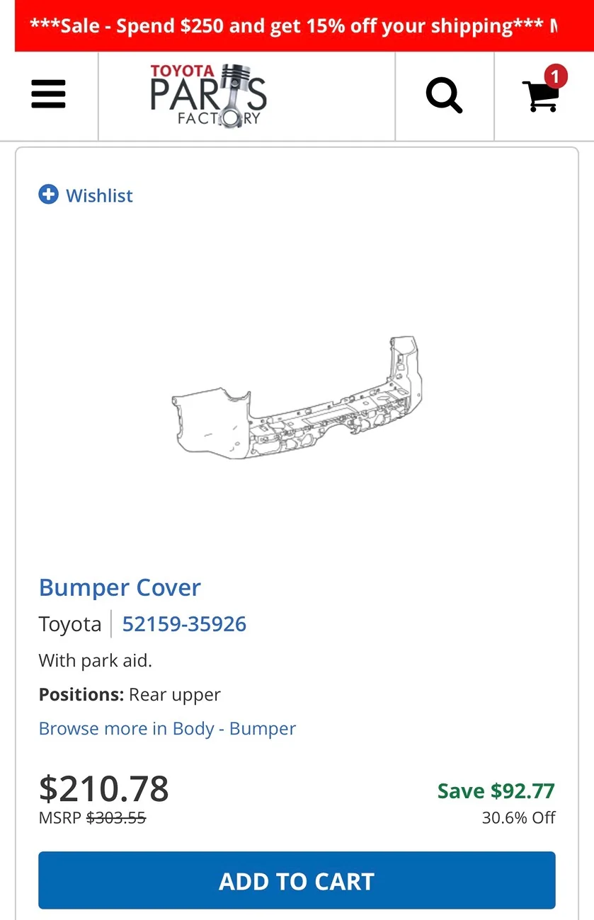

What is this lower rear quarter panel part called & part number? (in heritage blue)

What is this lower rear passenger side quarter panel part called & part number (in heritage blue)?

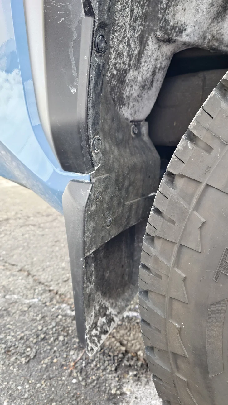

The body panel is made out of some kind of thin plastic that is normally soft but brittle in the cold. And there is a 90 degree lip with a couple of u-clip nuts with the mudflap screwed into them from inside the wheel well. And the lip just breaks right off, and another crack formed along the bottom going from the wheel to the bumper. And glue doesn't stick to that plastic, so good luck trying to repair the lip to get the screws back in.
That whole area is just a bunch of flimsy delicate plastic parts all clipped to each other with nothing screwed to anything solid, so as soon as any one part breaks, the whole area falls apart.
I'm agrevated but in fact I was able to get it more or less back together good enough for now.
I was able to transfer the u-clips to the same places but on the wheel well so there is something to screw the mudflap to. And there are a few other places that had these big beefy square plastic expansion nuts in square holes, but the plastic body and wheel well parts the nuts are in are way softer and weaker than the nuts, so the nuts just pulled right out. I was able to replace those with some "Lincoln license plate nuts" at ace hardware which are black and square and grab the square holes much more solid. And some black #14 x 1 sheet metal screws & washers to go in them. The broken lip is covered up by the fender flare so it doesn't show, and the big crack along the bottom is on the bottom so it doesn't show either from above. So it's in position and won't fall out and looks ok, but it's weaker and you can wiggle it around now.

The part you circled is part of the rear bumper. It’s all one piece. You cannot replace it individually. The entire rear shell including the piece you circled is around $800 from paintedoemparts. Look there and it has the part number listed.

$210.78 from Toyota (if your local dealership will price match) + paint
or roughly $800+shipping from paintedoemparts as @TyRoosevelt posted above

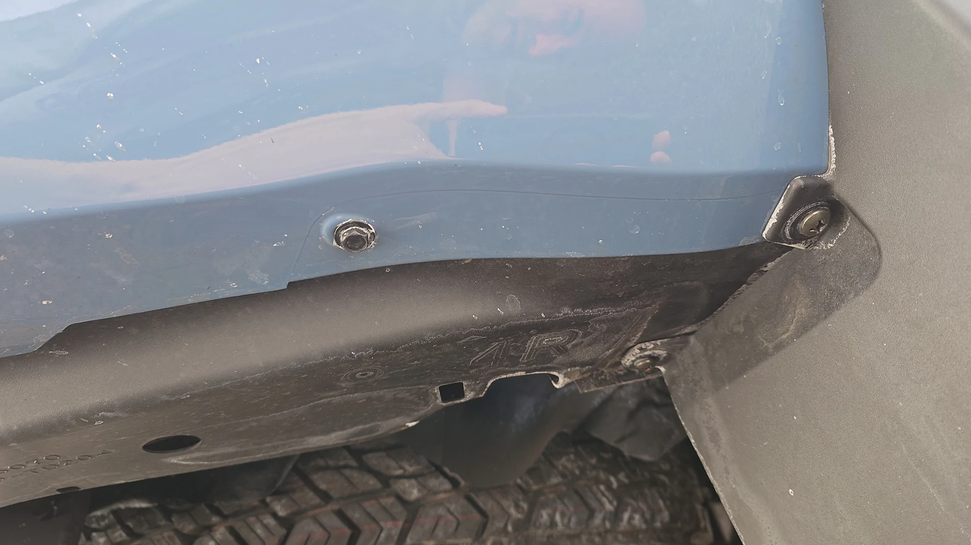

I was wrong about one of the cracks I described, it was just this molding seam that stars at the top-right screw here and goes left & around the other screw.

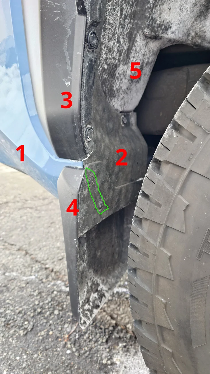

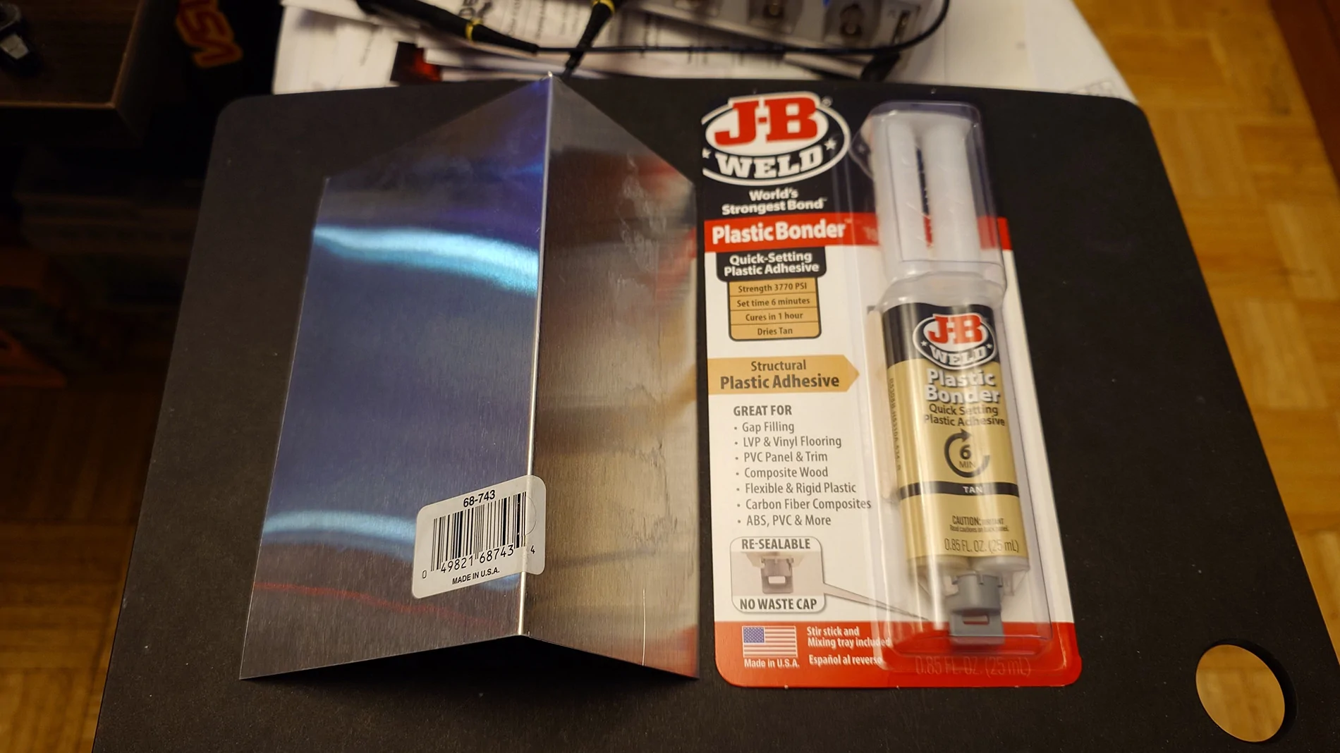

The u-clip nuts were originally on part 1, now they are on part 2, and parts 1 & 2 are not connected to each other any more.
Part 2 is not super rigid and only connected by real screws over on the inboard side. At the outboard side it's only attached by those loose push button rivets. So when you wiggle the flap, the wole black thing flexes and moves a little. The original attachment to the body panel gave it all just that little extra mouse of strength.
And here's my plan to rebuild the lip where the u-clips were originally. I found this piece of aluminum flashing for 58 cents at Lowes. I don't trust the epoxy to actually hold to the plastic more than lightly. But if I have a large sheet surface area glued to the inside surface of the body panel hopefully that will make up the difference.

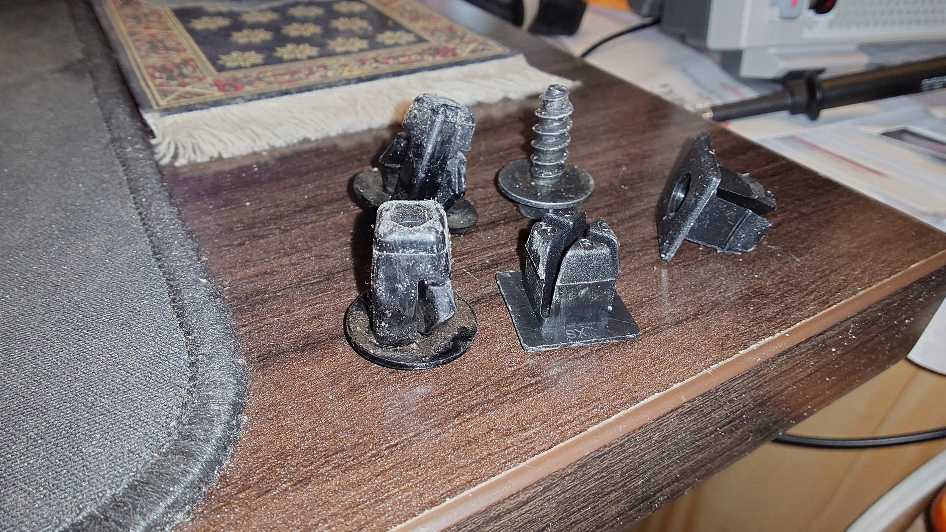

Here's the original expansion nuts vs the license plate nuts. They need to poke through more than one layer on the back side so I found these unusual ones that are longer than most. I can't find a link for them on the Ace hardware site. They were in the loose hardware drawers, and they were labeled as being for Lincoln.
They are only inserted into nothing but soft plastic panels, no metal. Those 2 little wings in the corners pull right through and bugger up the corners on the way. You could put the originals back in rotated 90 degrees to get two fresh corners and one more use. But I just hate everything about the way those work so the other style that grabs all 4 flat sides instead of 2 corner tips is just 100 times more solid.
Wow. Well I guess it makes sense to bother trying to rebuild the lip after all.
That is kind of ridiculous to have such a big part so easily broken. I mean it's a mudflap. it IS going to take hits. At least the part costs less than I would have imagined.
