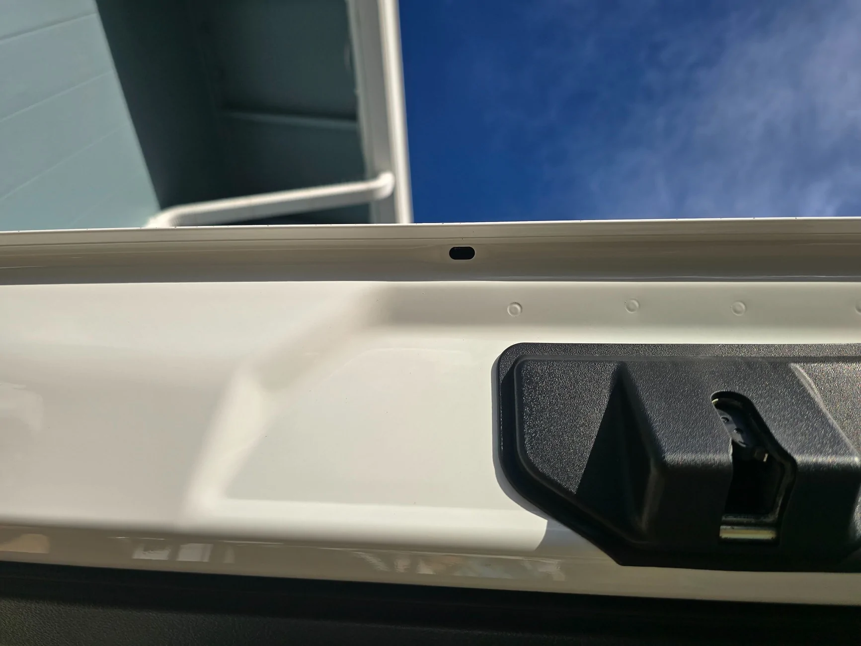

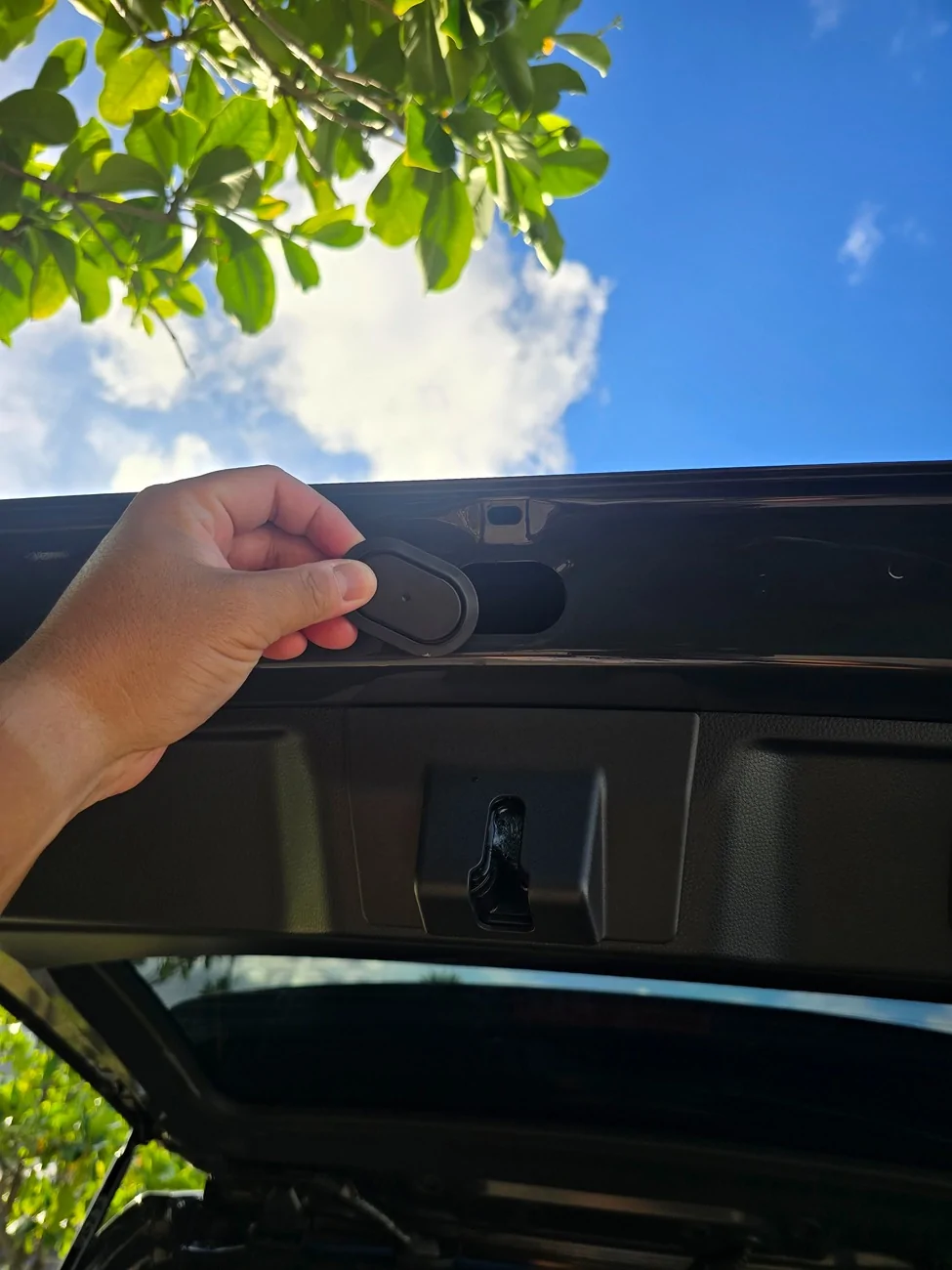

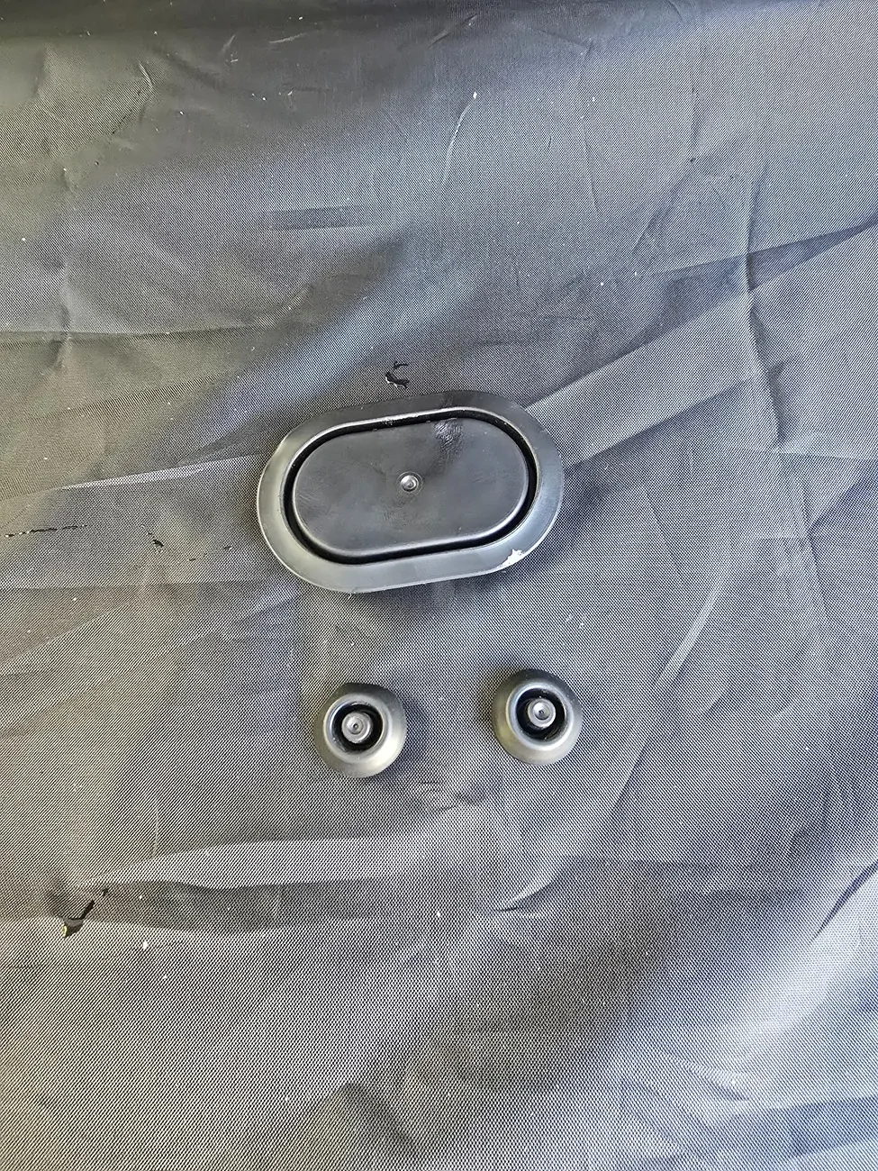

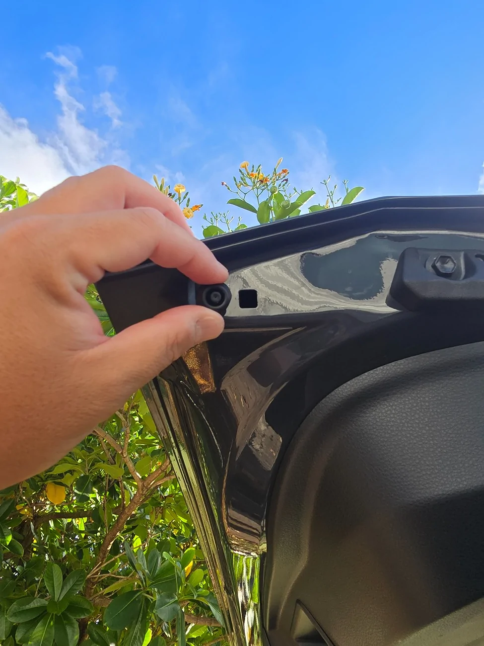

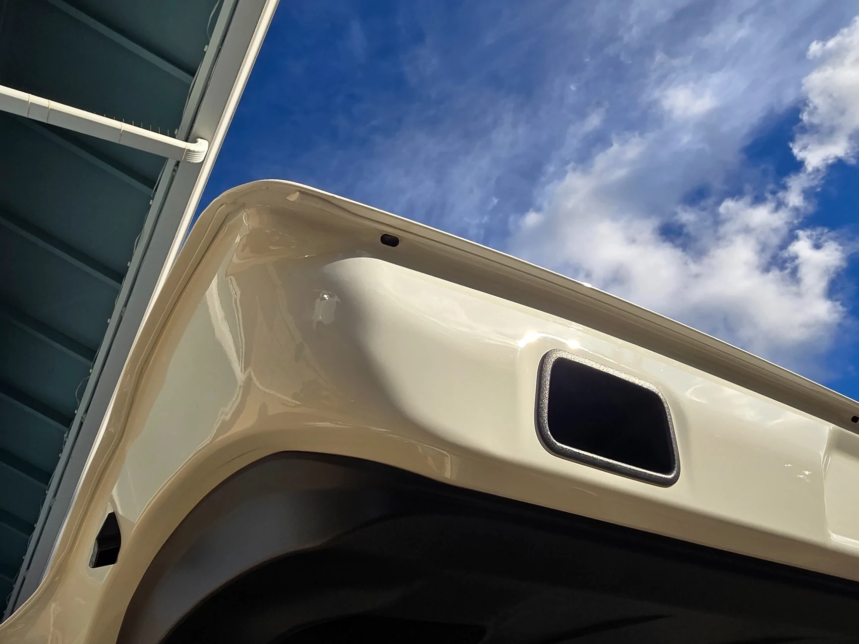

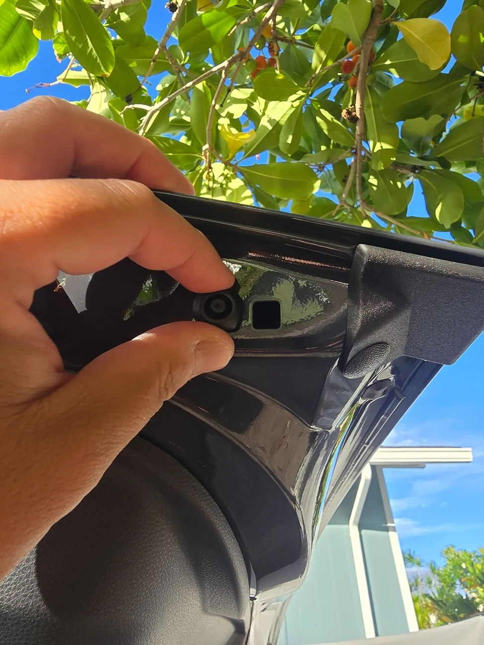

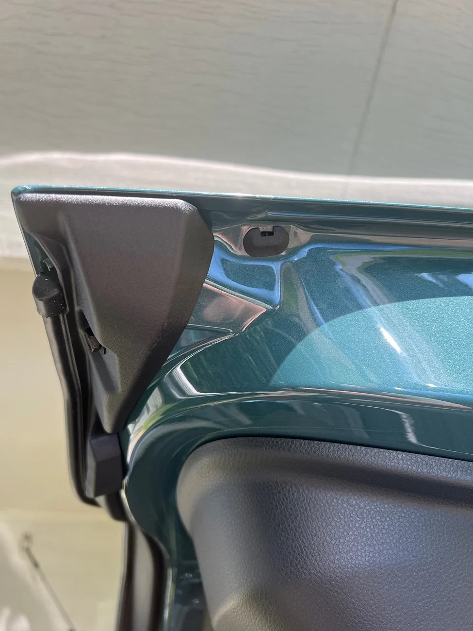

After noticing water collecting in the liftgate again (could hear it sloshing inside) I decided to compare the 6th generation liftgate to my 5th generation, and noticed that the weep holes in the 6th gen have plugs on them. Not sure if by design or by mistake. I removed 3 plugs from the weep holes, and water cam gushing out. We recently had a torrential downpour, so will be reporting back to see if the sloshing still occurs the next downpour or car wash.
These are 3 plugs total that I removed and water came dripping out:
2025 2026 4runner 6th gen Water in Rear Liftgate - Unplug the Weep Holes 1000021324
2025 2026 4runner 6th gen Water in Rear Liftgate - Unplug the Weep Holes 1000021325
2025 2026 4runner 6th gen Water in Rear Liftgate - Unplug the Weep Holes 1000021326
Remove these 3 plugs:
2025 2026 4runner 6th gen Water in Rear Liftgate - Unplug the Weep Holes 1000021327

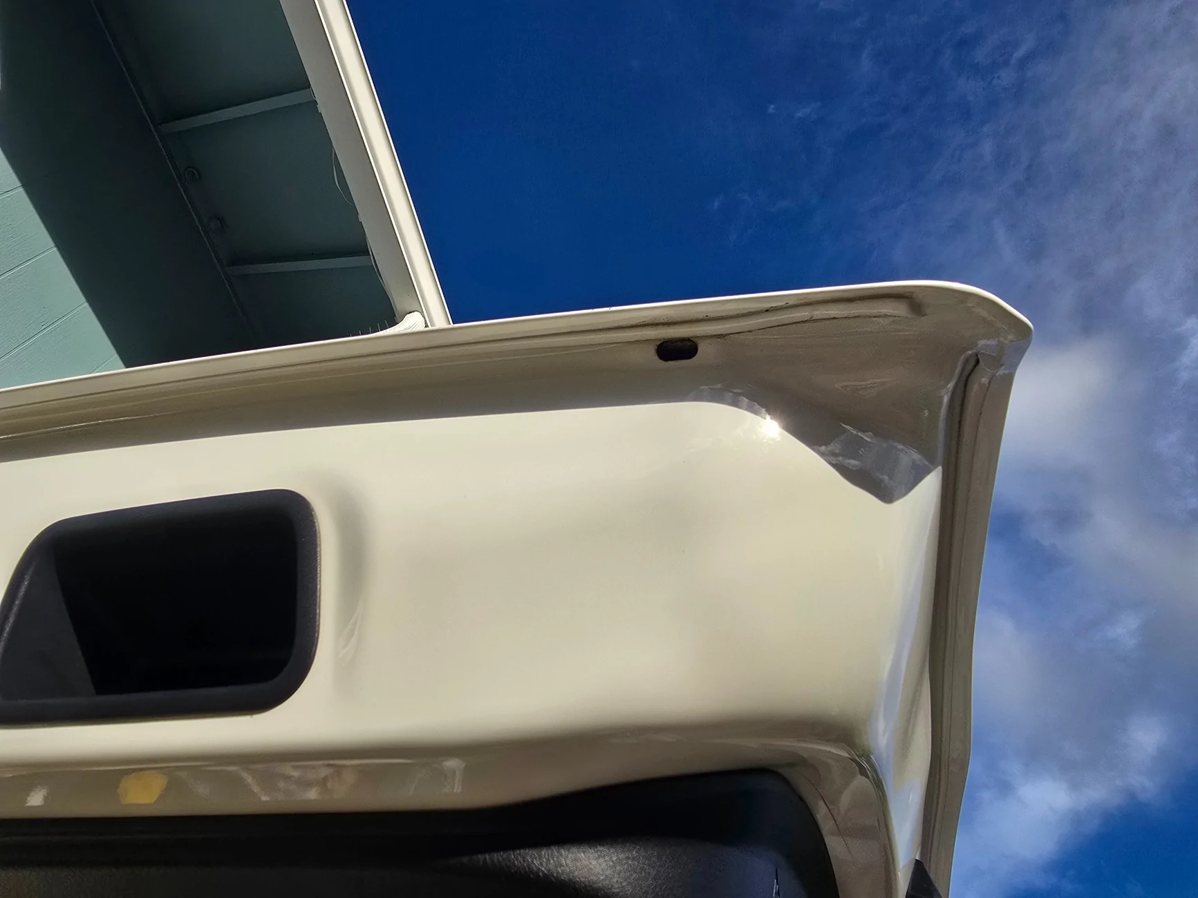

5th gen weep holes not blocked as they dont have the plugs that were on my 6th gen:
2025 2026 4runner 6th gen Water in Rear Liftgate - Unplug the Weep Holes 1000021328
2025 2026 4runner 6th gen Water in Rear Liftgate - Unplug the Weep Holes 1000021329
2025 2026 4runner 6th gen Water in Rear Liftgate - Unplug the Weep Holes 1000021330

um i wouldnt remove that one, that is not a drain cover
um so those big open square holes dont let water drain?

um water came pouring out of that hole
um those "big open square holes" you see are visible because I took out those small rubber plugs that were in them. Does everyone have the plugs in?

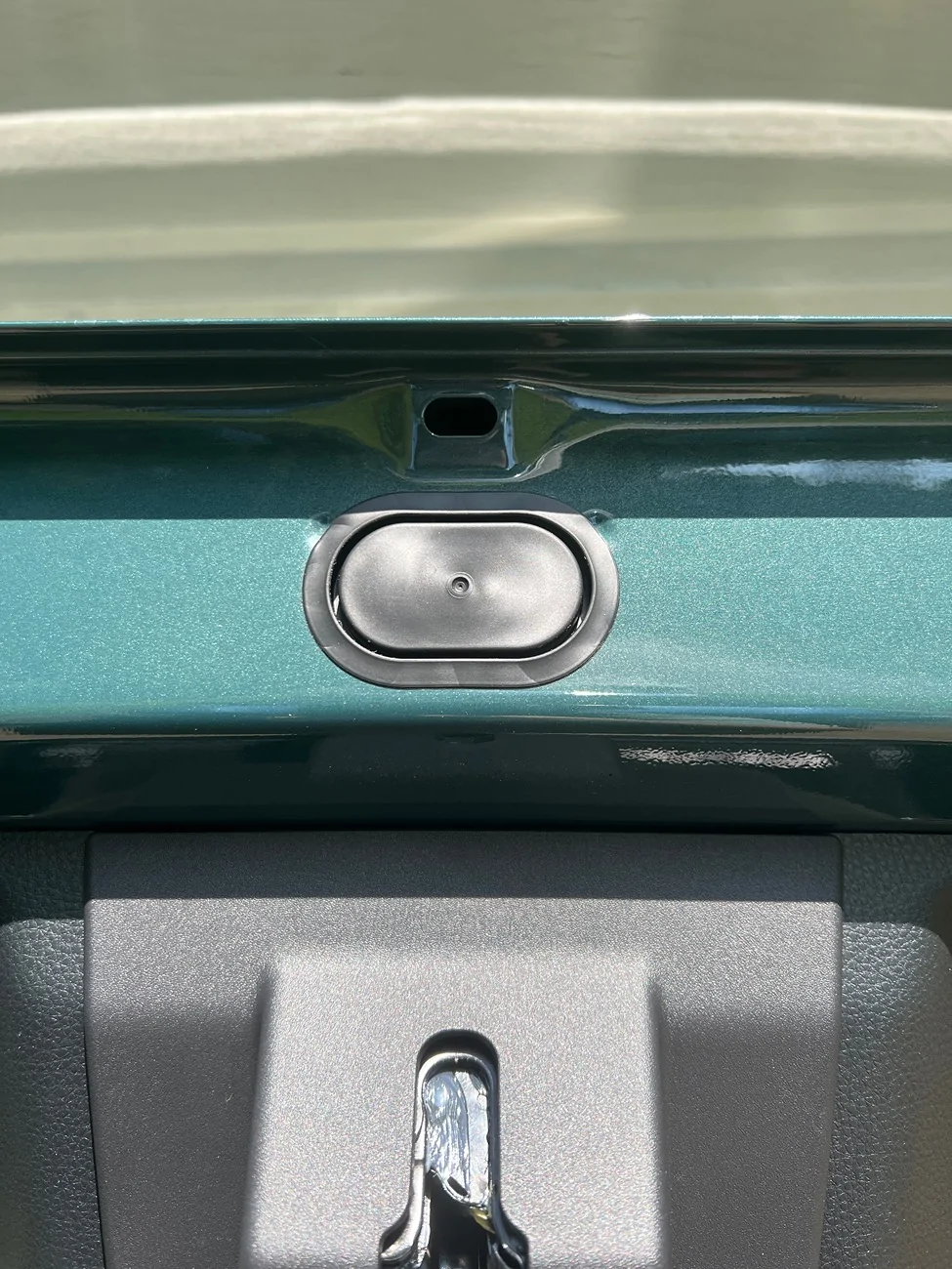

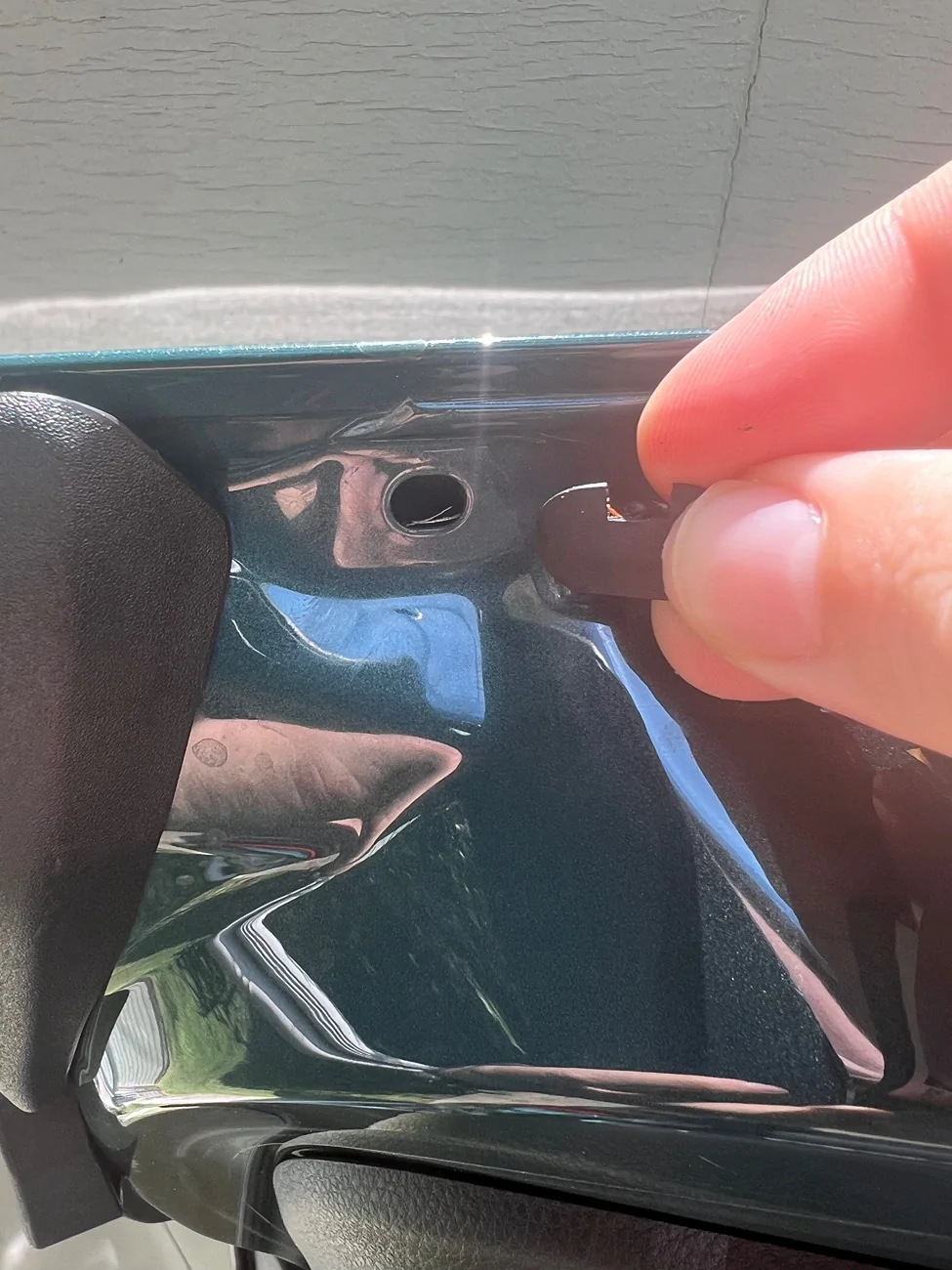

Just checked mine and apparently it’s different than yours, maybe due to it being a power liftgate? My center plug is the same as yours (and I noticed a weep hole above it) but my side plugs are different.
2025 2026 4runner 6th gen Water in Rear Liftgate - Unplug the Weep Holes IMG_0656
the side ones are more oval shaped and close to the same size as the small hole in the middle of the liftgate
2025 2026 4runner 6th gen Water in Rear Liftgate - Unplug the Weep Holes IMG_0657
2025 2026 4runner 6th gen Water in Rear Liftgate - Unplug the Weep Holes IMG_0658
I did pull the side ones out and they had some sand and grass in it so obviously had water in it at one point. I’m planning on leaving them out, but am going to leave the large center one plugged. That seems more like an access hole to me for wiring or the latch.
thanks for the heads up and hope that helps some even though yours is different!
