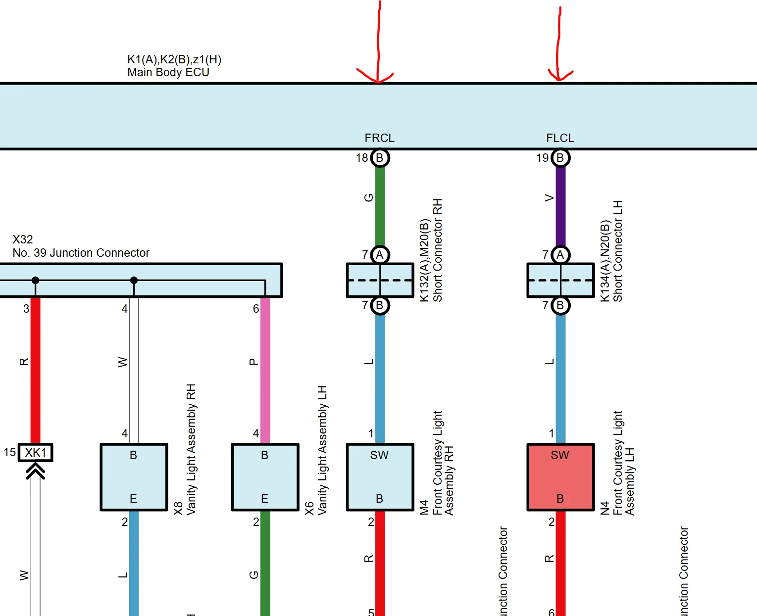

Was able to install the Diode Dynamics D Switch Panel, Baja Designs rock lights and Diode Dynamics C2 2.0 chase lights. First time ever working on electrical and it works!🥳 Does anyone know where I can tap the trigger wires (specifically the parking light wire and the dome light/ courtesy door lights wire) and what color wires they are? Thank you in advance.

courtesy light switches for front doors go to main body ecu 18 green or 19 violet
