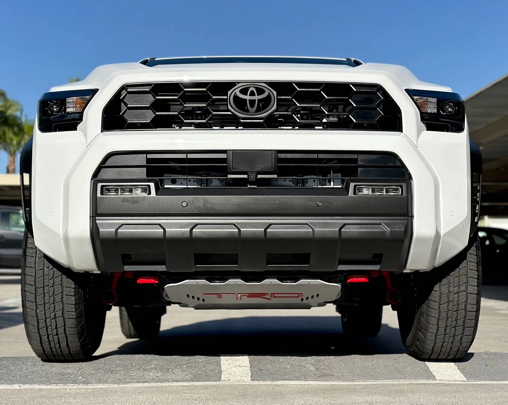

Hey all! Was going to install a TRD skid plate today, but our TRD Sport Premium did not come with the rear “dust cover” that covers the oil pan. And there are no bolts in the holes where the dust cover should have been. So I only have the 4 bolts from the front dust cover, but the TRD skid plate requires 6.
Was I supposed to order extra bolts with the skid plate? Or was my 4Runner actually supposed to come with the rear dust cover (and its 4 bolts)?
