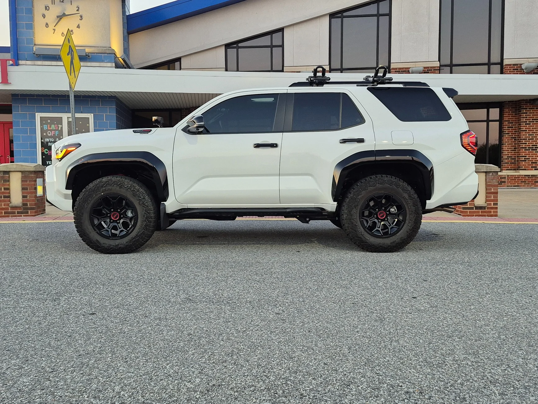

Do you have a picture of the final result? Really trying to determine if 1'' is the size we want for my wife's pro.

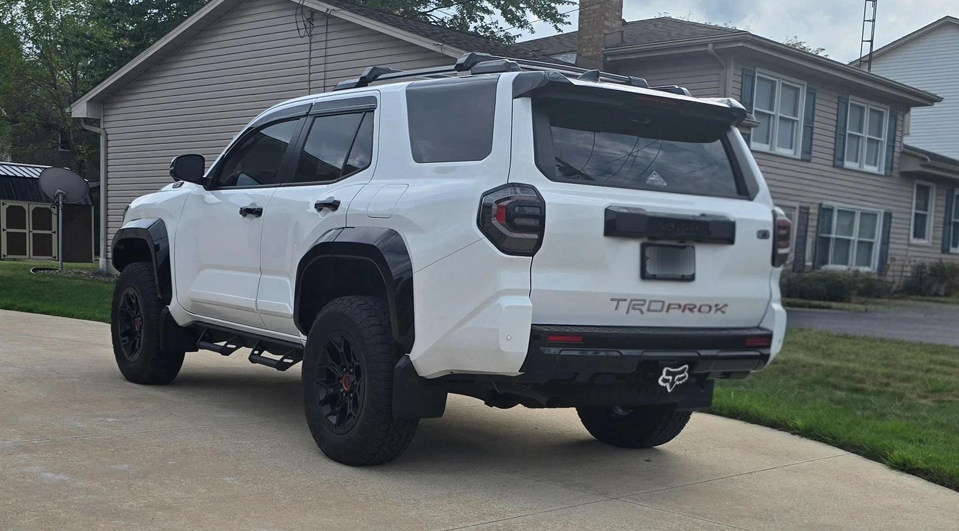

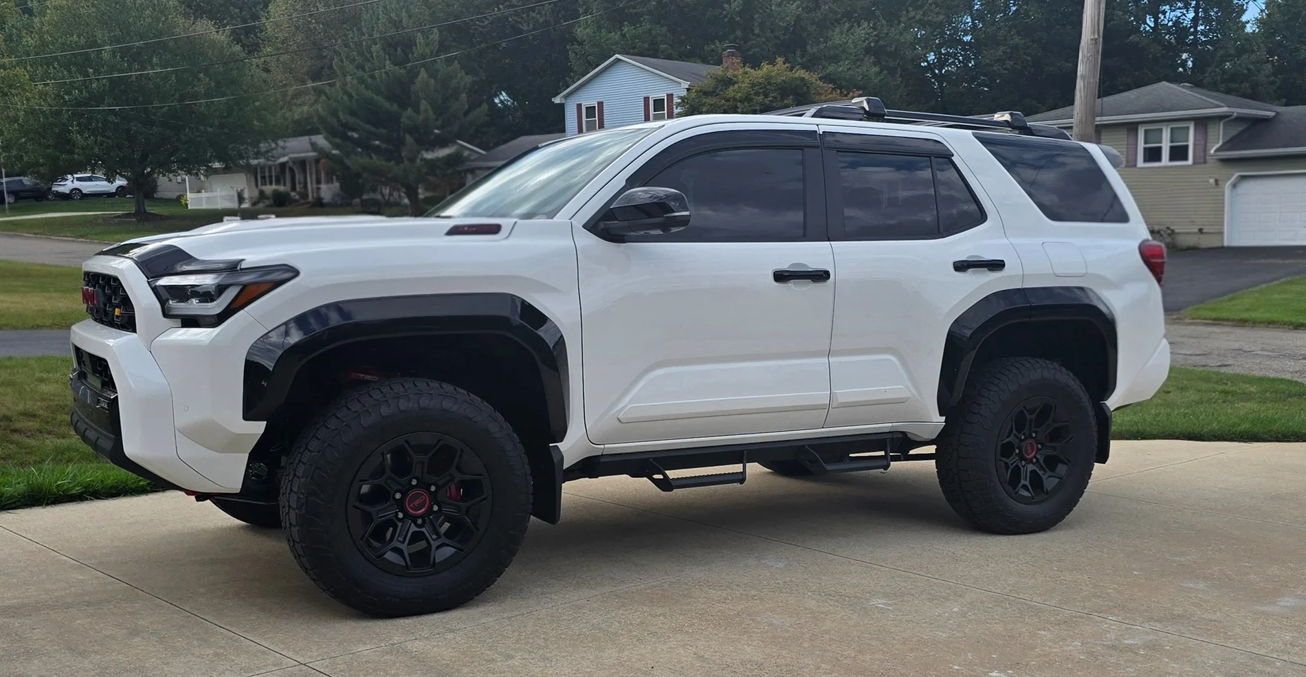

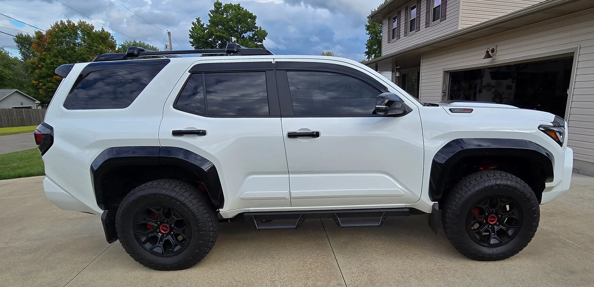

Here's mine with the 2" Torq Lift / Leveling kit, so you have reference for different heights. I'll post pics later today with ProComp Rockwell 18x9 0OS installed.
2025 2026 4runner 6th gen TRD Pro Lift / Level Strut Mount Reclocking 20250925_171656
2025 2026 4runner 6th gen TRD Pro Lift / Level Strut Mount Reclocking 20250925_171612(1)
2025 2026 4runner 6th gen TRD Pro Lift / Level Strut Mount Reclocking 20250925_171556(1)
