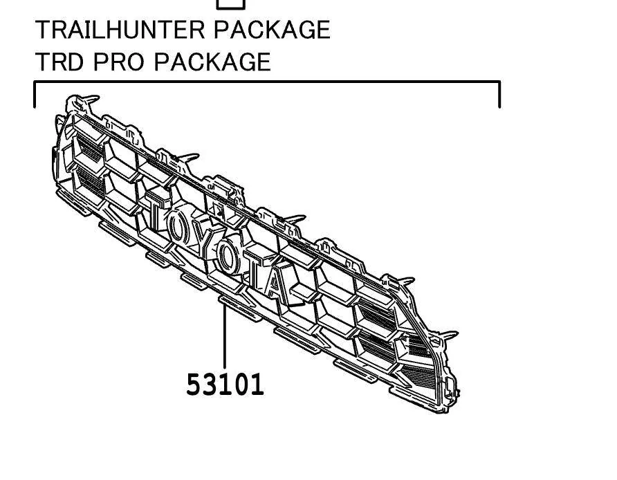

Updated with heritage grille part number and link to parts diagram schematic:
TRD PRO GRILLE PART NUMBER: 53101-35170
HERITAGE GRILLE PART NUMBER: 53101-35160
TRD Pro / Trailhunter grille part:
https://autoparts.toyota.com/products/product/grille-sub-assy-radiator-5310135150
Original post:
I want to get the TRD Pro heritage grille on my ORP and can't find any part numbers yet to order it. Anyone find it yet?

Ok to be clear, this schematic drawing above and on the link that mods added to the first comment doesn't actually specify which version that part number is. It shows both the regular round logo and heritage logo without specific part numbers for each... Not sure how to find that info.
Were you able to find the specific part number for the Trd pro/trailhunter grille?
Nope. The descriptions don’t help at all.
PART NUMBER: 53101-35170 (confirmed by @Ericd6972 in this post)
Original post:
I've called around and unfortunately it looks like it's on national backorder?
I’m just realizing also they it’s glossy black unlike the Off-road grille that’s more matte. So you’d have to also replace the lower one which has the sensors and stuff…. That might be a deal breaker for me. I don’t really like the gloss look.
I did not realize that, I don't think it would look too bad without replacing the bottom
I called and got the trailhunter grille part number and that is 53101-35160. My only concern is the letters being bronze

Both are nationally back ordered. There are many online dealers that list them but
it has been verified that the Trd pro is a gloss black grille and I'm not positive but I believe the Trailhunter grille is flat black but with bronze letters.
I'm going with bronze wheels and would prefer to have the Heritage with bronze letters as well.
No big hurry to get it yet but once the availability loosens up I will add this.
