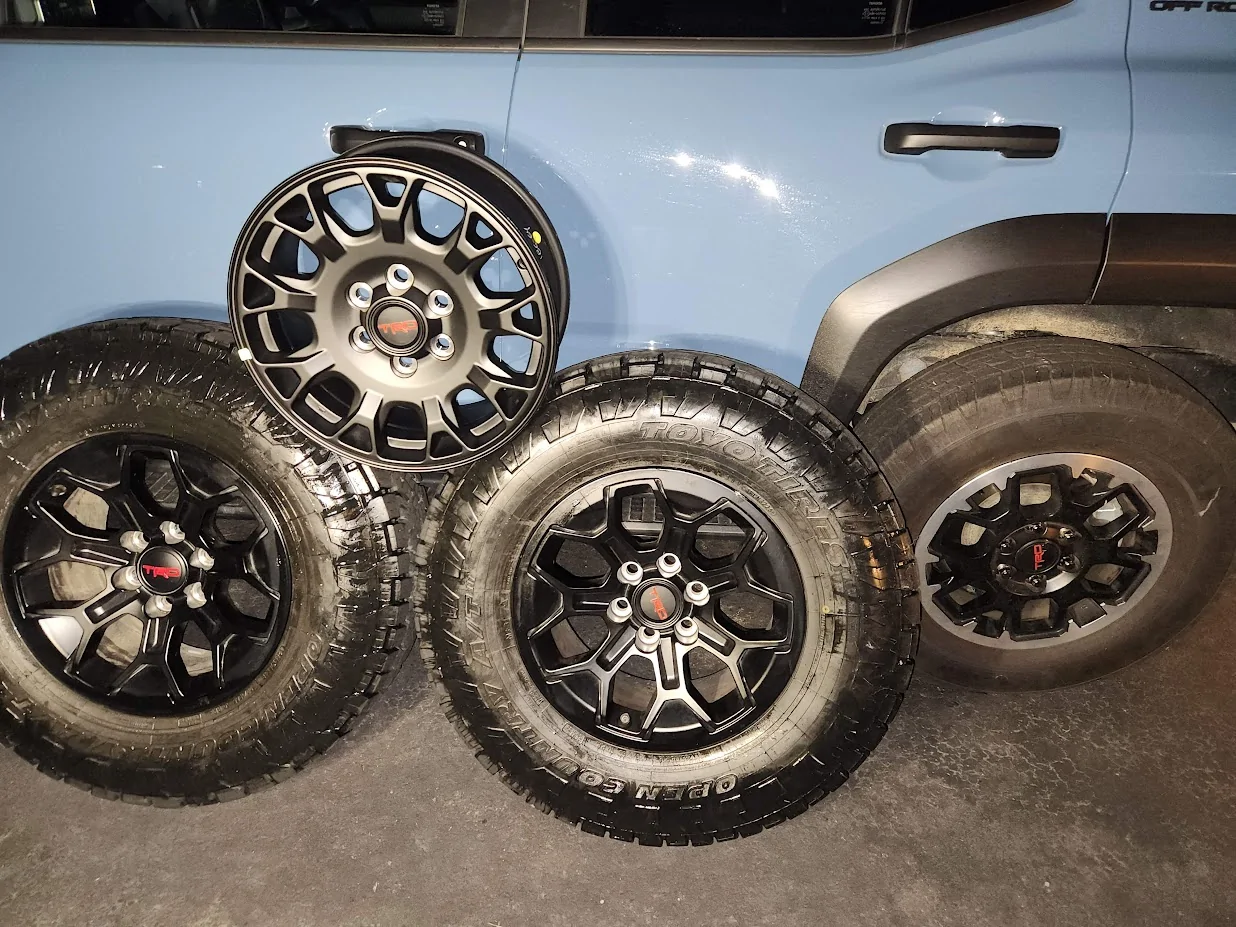

Comparison below. Flat Black is unmounted wheel. 2 TRD PRO wheels w/ 285/80 Toyos. OEM wheels/tires on TRD ORP (those OEM wheels are now on my son's 5G4R with 265/70 Toyos.

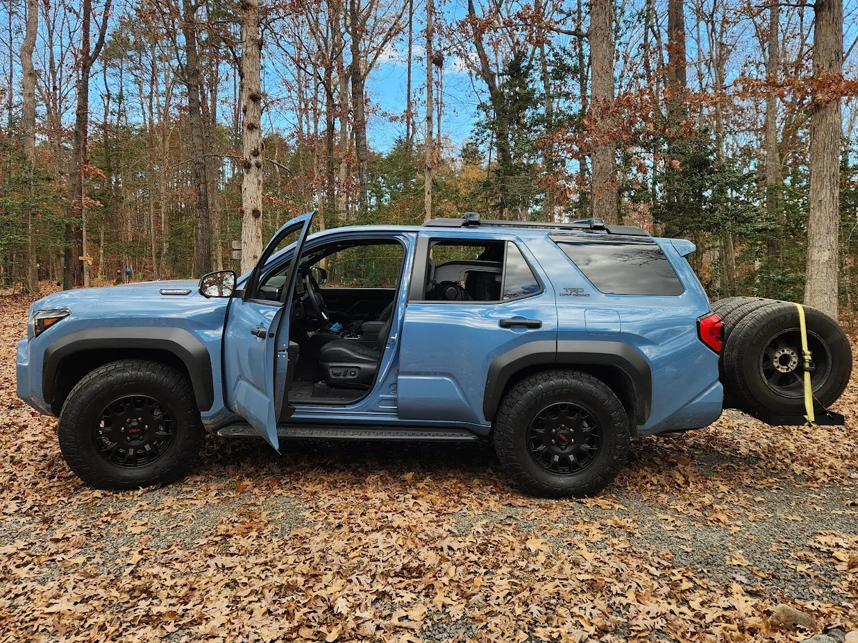

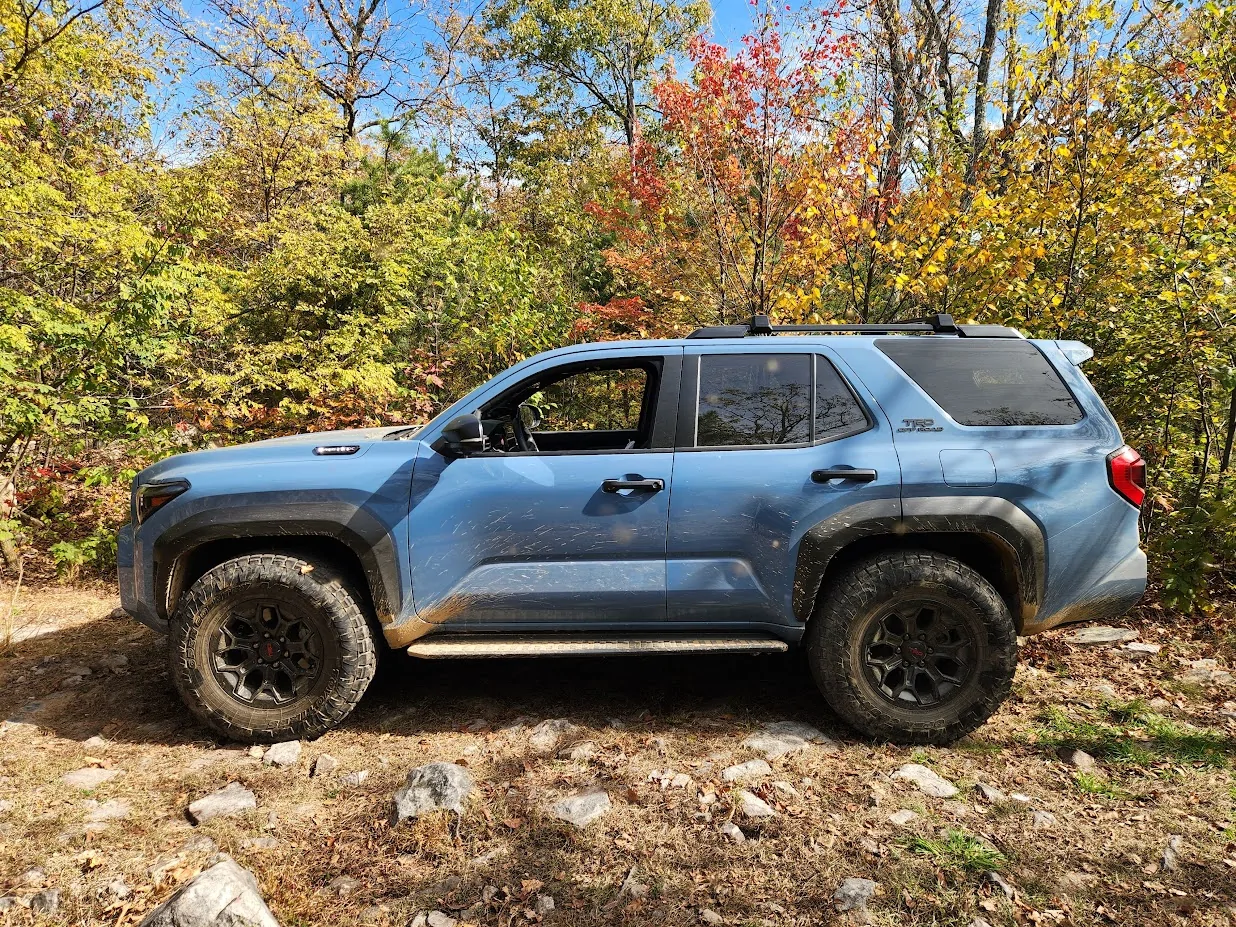

They do look good though: First one is TRD PRO wheels; second is TRD Flat Black option wheels (with OEM wheels with Toyo 265/70s on trailer to be mounted later that weekend on 5G4R)
2025 2026 4runner 6th gen TRD Pro: 35s on OEM TRD Pro wheels 20251018_130457
2025 2026 4runner 6th gen TRD Pro: 35s on OEM TRD Pro wheels 20251116_130211-EDIT
