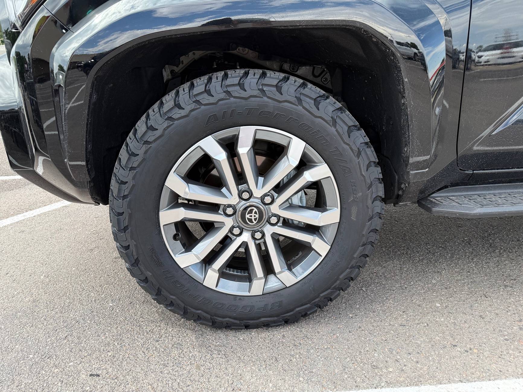

i ended up putting 275/60r20 on my limited, which is a 4.8 percent increase in diameter. 31.5 to 33 ive seen the various posts of other people doing the same.
my question is… is that percentage acceptable im seeing literature saying no more than 3 percent but other literature saying 15 percent is ok for suvs/trucks
or am i overthinking it at this point as they fit and do not rub

Acceptable.......for what? Fuel economy? Driveline wear? Stopping distance?
Largest stock tire size on 4R is 32.6", so as far as I'm concerned you're at +1.2%. I'm not even gonna entertain the 15% percent suggestion
It sounds like you are happy with the fitment, so no problems? If you are only now after the fact worrying, then you probably should have thought about that beforehand considering that anything that isn't OEM spec is, well, not OEM spec. But even heavier tires in the same OE size would be 'not OEM spec' so technically subject to *potential* increased wear, so you're probably overthinking it.

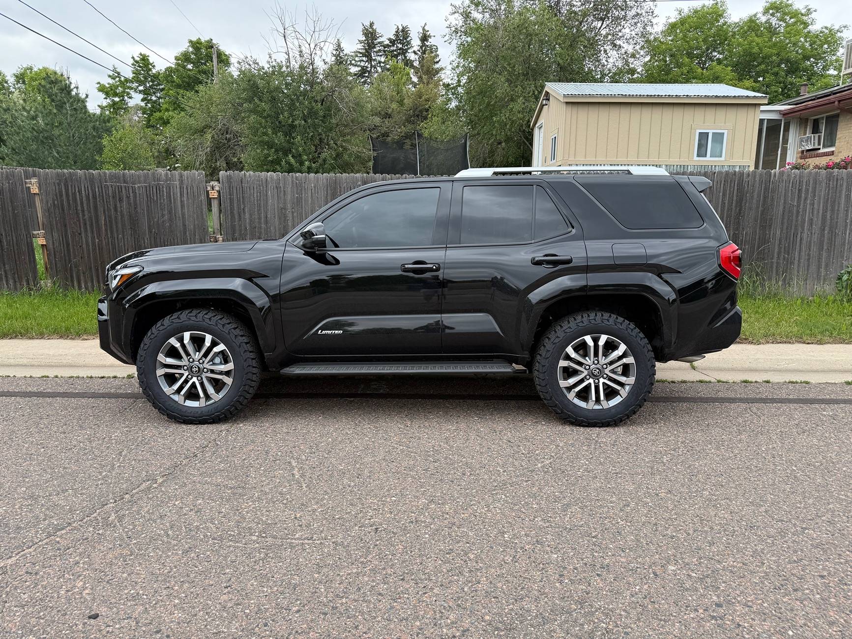

Ive been wanting to see what people do with rim / tire combos on the platinum / limited / sports with the stock 20 rims. Post a pic of the whole rig from the side if you can! Let’s hear your feedback since you went for it! How’s she drive?
@Hobb3s - curious, do you reckon since the stock 20 inch rims come with a slightly smaller diameter tire (by an inch) Toyota built slightly different computational math for all that? I wonder if that’s why you can’t option the TRD 18 rims on those. Sorry if that’s a dumb question.
2025 2026 4runner 6th gen Tire upgrade percentage size? IMG_3592
i want to love it, may go back and put a oe tire back on though.. depend on how much mpg hit there is.. its a d load tire so it could be a pretty big hit

Thanks for posting that. Do share feedback if you keep em on for any length to get a feel for em! It looks pretty good on the side profile there.
im debating a set of the TRD rims with the stock tire size for the limited I have coming with the 20” wheels but that size 275/60r20 on the 20s looks tempting.
my favorite SL rated tire for my purposes is the snow rated cooper road and trail which I have on my 5th gen right now and it looks like it comes in 275/60r20. Kind of the perfect mostly road but sometimes fun tire I’ve found. So sharing this info has already been helpful, thanks!
