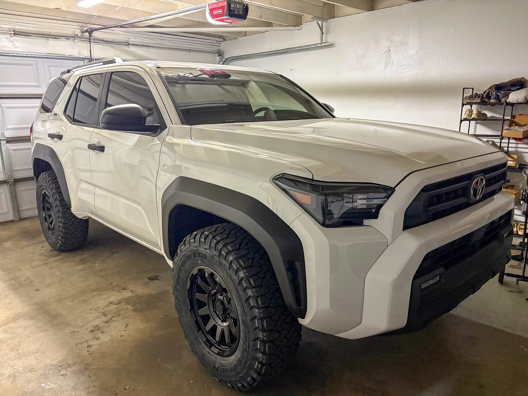

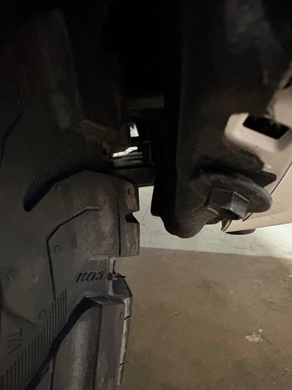

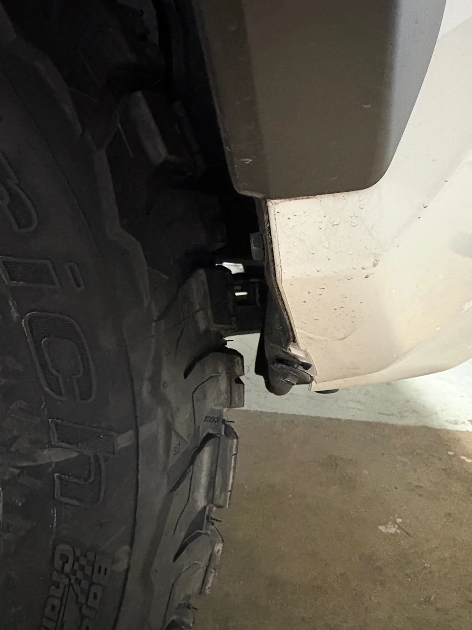

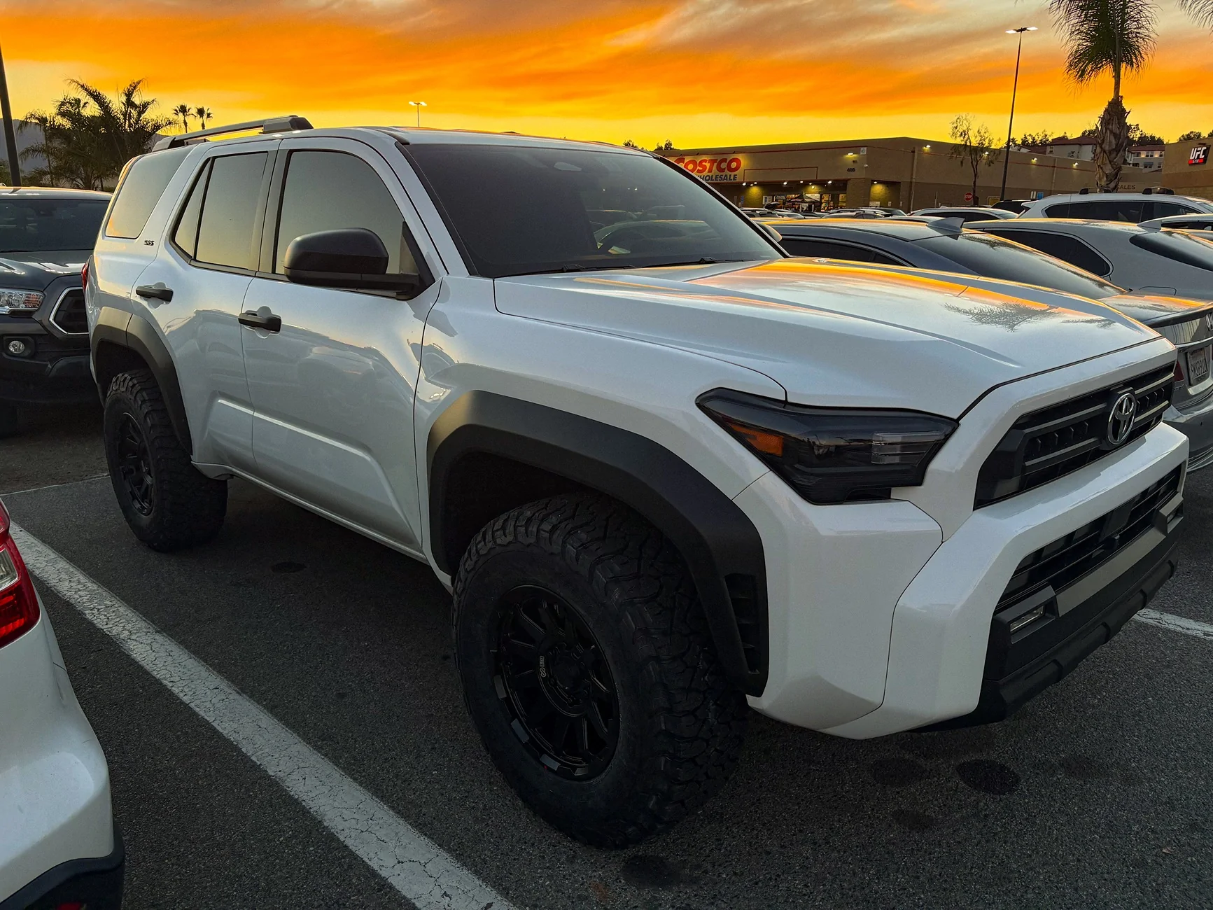

Just put on 285 70r17 C Load ko3s and Enkei Trail Boss wheels +20offset. Some pictures included fully turned, maybe about 1.5 inch of space from rub.
Was wondering if anyone has done the overall calibration to include the increase in tire size? and How?
