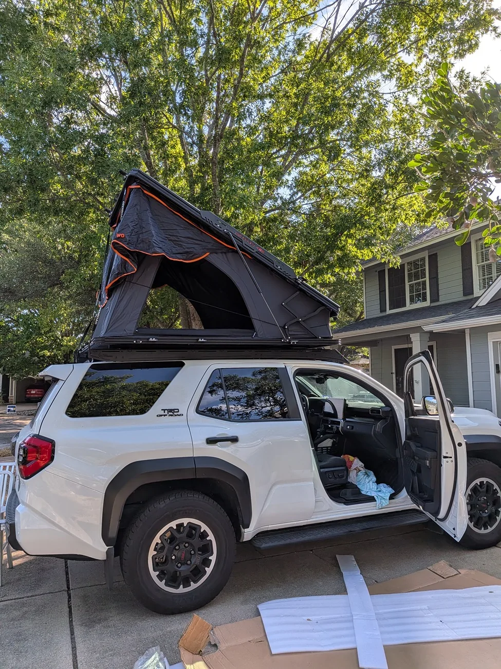

2025 2026 4runner 6th gen Tent on a Prinsu Pro Rack......I'm so confused. PXL_20260819_224749566
Success! Thank you everyone so much for the guidance and help! I did the same setup as everyone else with the two support feet in the middle.

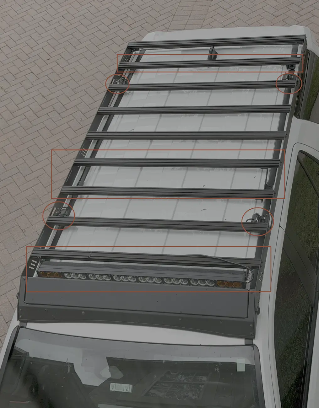

i literally spent 5 hours wasting time trying to install the Sterling RTT on my 4Runner with no success due to the same issue you were having. But in addition, I have the Kammok awning mounted on my Prinsu Pro Rack which added another obstacle. Because the side mount bracket that was purchase separately from the Kammok awning doesn’t even work with the RTT since the side mount brackets sit about 1 1/2 above the beam making it impossible for the RTT to sit aligned with the bolt inserts. Does anyone know how to make this work?
I’m slowly starting to give up on the idea of buying a roof rack after seeing what you’re going through.
I don’t have a sunroof, so my only access would be from the rear after removing the valance. From what I’ve seen, most people take the crossbars off, mount them to the bottom of the RTT, and then reinstall everything together.
The Cali Raised rack makes that process especially challenging, though, since I have nine crossbars and most of them are effectively fixed in place:
2025 2026 4runner 6th gen Tent on a Prinsu Pro Rack......I'm so confused. 1790968155248-7
#1 Can’t move it - the front LED bar is attached.
#2 Can’t move it - side lights are attached.
# 3-4. Can’t move them - the roof rack sits on them.
# 5-6. These seem like the only possible options, but they’re already in the middle of the roof rack.
#7 Can’t move it - side lights are attached.
#8 Can’t move it - the roof rack sits on it.
#9 It’s accessible, but there doesn’t seem to be much point in moving it. I also don’t think the RTT extends that far back anyway.
So I’m trying to figure out whether there’s a practical way to install the RTT without having to dismantle half the rack and lighting setup every time.
I am planning to get Kammok awning, so if that makes thing even more complex, I am going to revert to plan to sleep in trunk, and get my stuff on roof…
