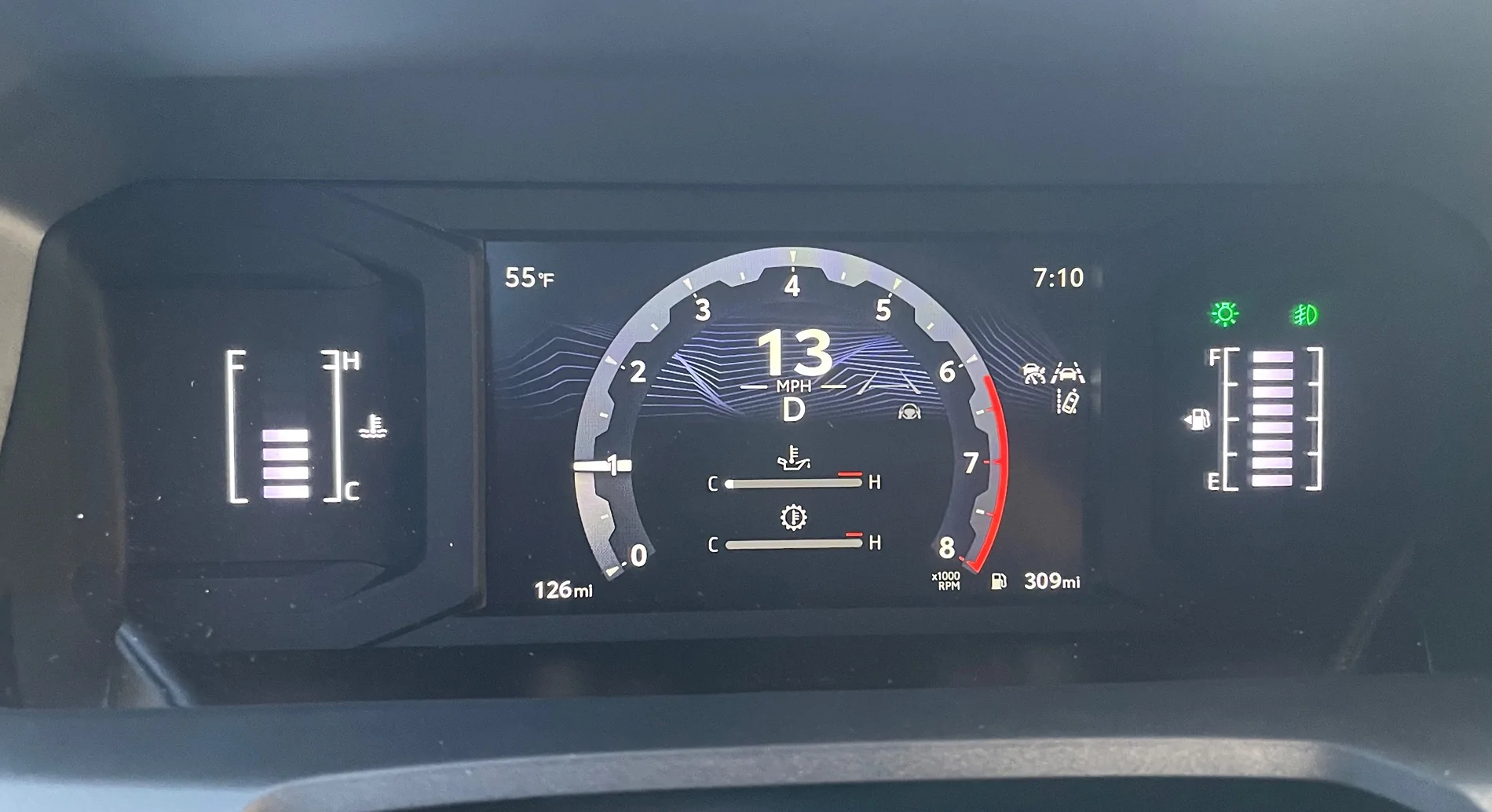

Hey there,
I noticed on my SR5 that there seems to be a bit of a discrepancy between the main engine temp gauge on the left side of the dash versus the middle engine temp display that you can choose to display..
The “bar” display on the left side reads the normal four bars, while the center seems to read much less.
I typically atleast let my temp get up to one or two bars on the left from a cold start before driving off (might be a bit overkill, but it’s always been a habit to let the engine atleast warm up a min or two).
The center display does eventually rise to normal operating temps after some driving, but it’s just something I noticed this morning.
It’s honestly not a big deal to me, but I was just curious if anyone else has noticed this?
Thanks!

Following. I don’t have the canter display showing temp. I too like to warm up in colder temp.
Curious, if that is oil or coolant temp. Maybe they are different???

Yep, I see the symbols now. Was originally looking on a small phone without glasses :)
I have it figured out thanks to a look at the manual - Around page 96.
The large left gauge is Coolant Temp.
The smaller configurable gauged in your pic are:
Top - Engine Oil Temp (NOT COOLANT). Its typical for this to lag behind coolant temp.
Bottom is Transmission Fluid Temp.
Looks like you can display the Oil Pressure gauge and battery too.
I know on my Ford F350, I have a scan gauge permanently installed and I monitor the Coolant Temp versus Oil Temp. There is a very specific delta in the two that you need to watch, something like up to a 7 degree difference at highway speed. if it's not, you have issues.
Hope that helps.....
