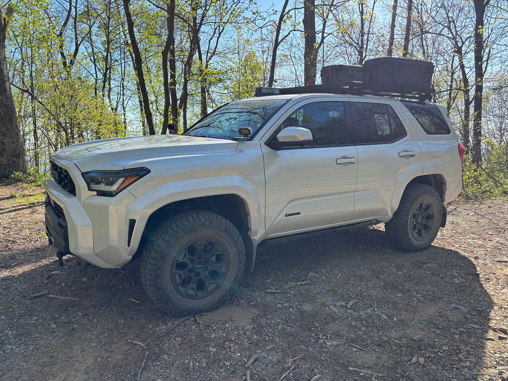

I installed MT64's on all 4 corners and you will not be nose high using the minimum setting of 1.75" as the front lift range is 1.75" to 3". At the minimum setting you'll be 0.25" to 0.5" lower in the front after installation. I also installed the Icon .75" lift rear coil springs and set the fronts to 2.25" which is the third circlip setting from the bottom. Also running 265/70R18 tires which are 32.6".
I suggest measuring the distance from the center of the hub to the bottom of the fender on all four corners before installation, and I believe you'll see the front is approx 2" lower than the rear. One thing to keep in mind, if you plan to add any weight to the front, such as bumper, winch, skid plates, you'll need to take that added weight into consideration when setting the front coilovers. I added the bumper, winch, and skid plates after I installed the coilovers and now I need to adjust them again to attain level.

I’ve been very pleased with my setup. I did 350 miles across north GA a couple of weeks ago and the MT64’s provide a good balance for road and trail.
