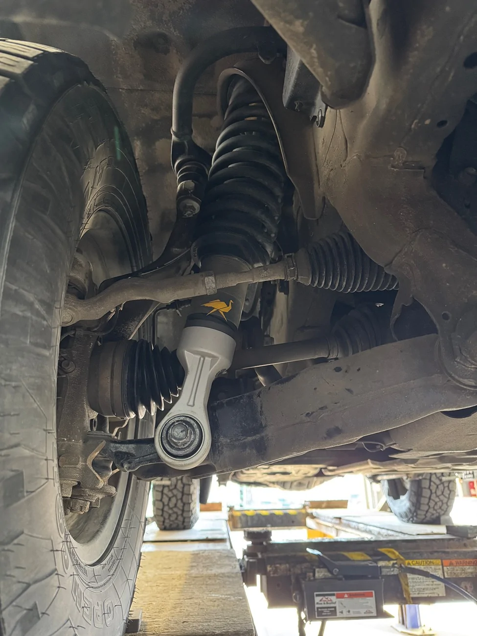

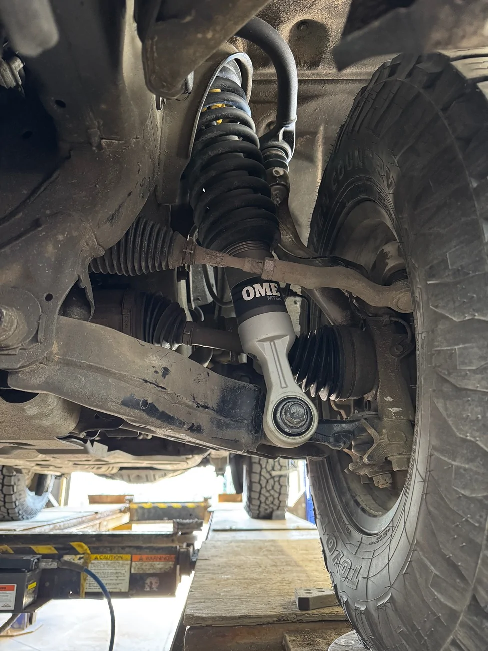

Alright, since we all had so many questions that went unanswered I decided to get to those myself.
Old Man Emu kit number 2135K by ARB
Included parts are as follows as seen in the image below:
  • FK134 Brake Line Spacer Kit 1
  • FK137 Sway Bar Spacer Kit Rear 1
  • MT64601052 MT64 Shock Absorbers Rear 2
  • 3344 Coil Springs Rear 2
  • MT64996013 MT64 Coilover Struts Front 2
  • UCA0037 Upper Control Arms 2 (with ABS spacer brackets)
Now this 2135K kit comes preset at 3" Front and 2" Rear lift

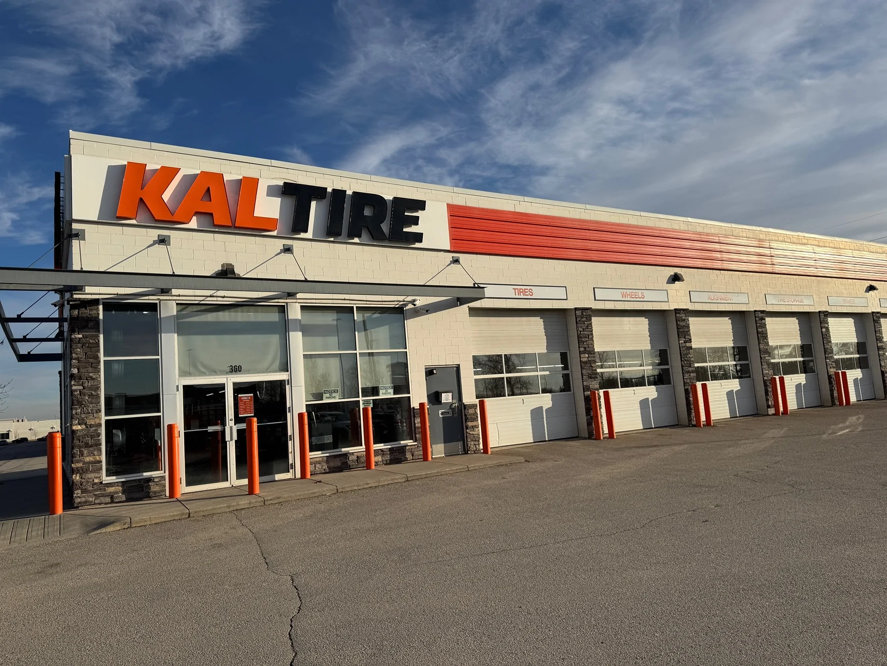

For the installation I opted to go with Kal Tire Shawnessy in Calgary, Alberta for a few reasons, the first being I knew a few folks at the location and felt comfortable with all of it.
Kiran is one of the assistant Managers and Darcy is a Technician with a lot of passion for work like this..
So lets us begin with the installation.
And the original parts video with Old Man Emu MT64 Kit 2135K
Before:
After:
Remaining Parts:
After passenger side on the ground Axel angle.
Total time 4 Hours labour + Alignment. Great work Darcy!
