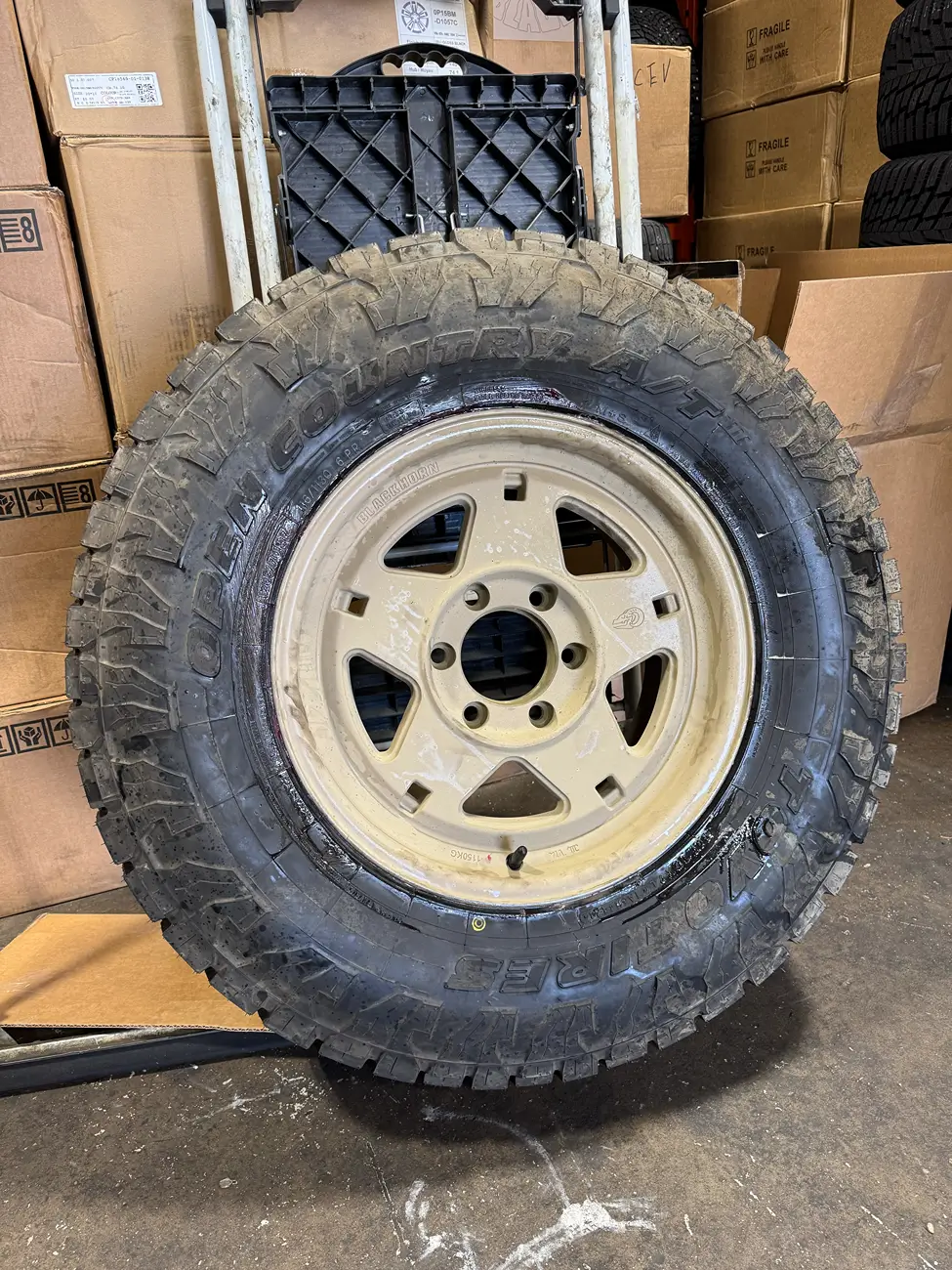

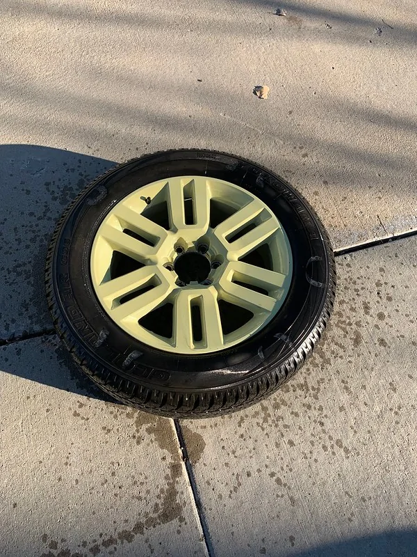

Spare Tire Wheel Arrived Today No Delay in Mounting & Balance!
FDE 17x8.5ET25 6x139.7 Gaining an additional 5MM Poke!
Why FDE its to Remember the Original Yellow Spare we Got with The 4Runner's in The Past

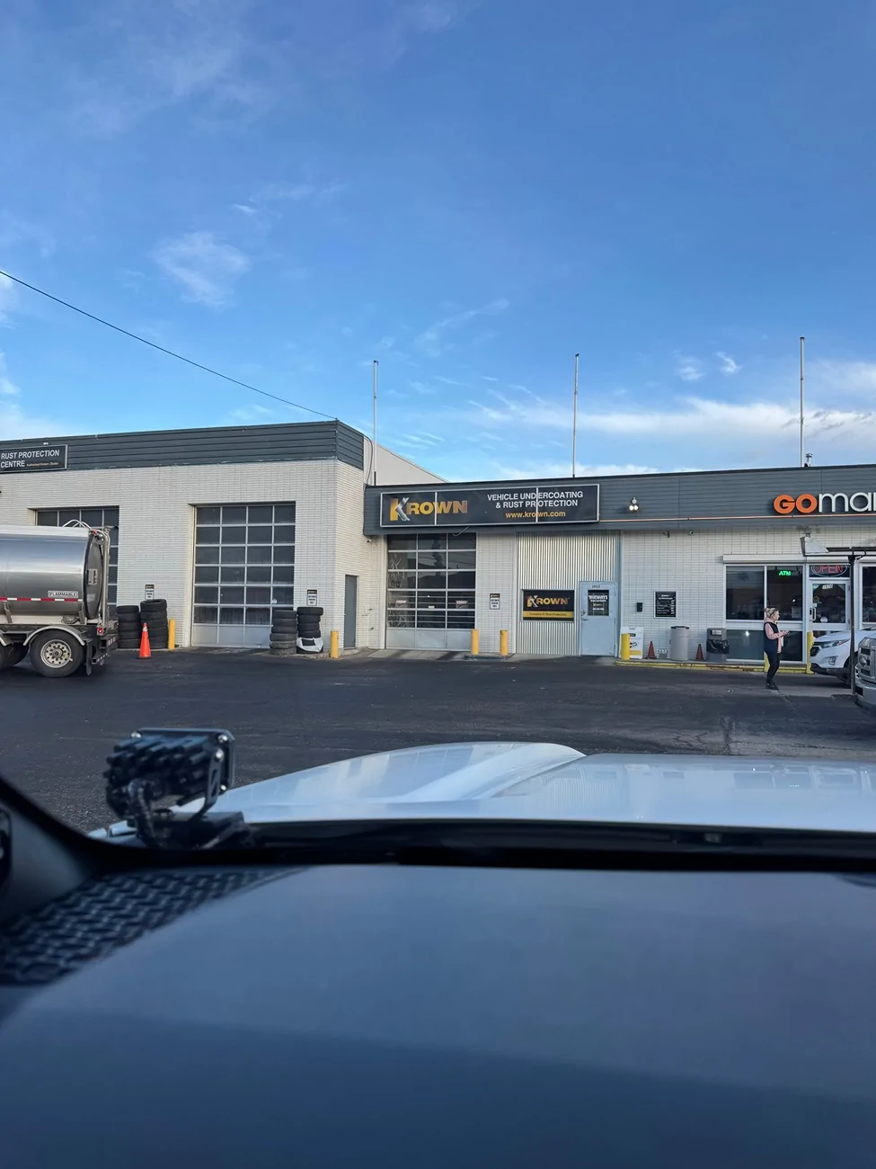

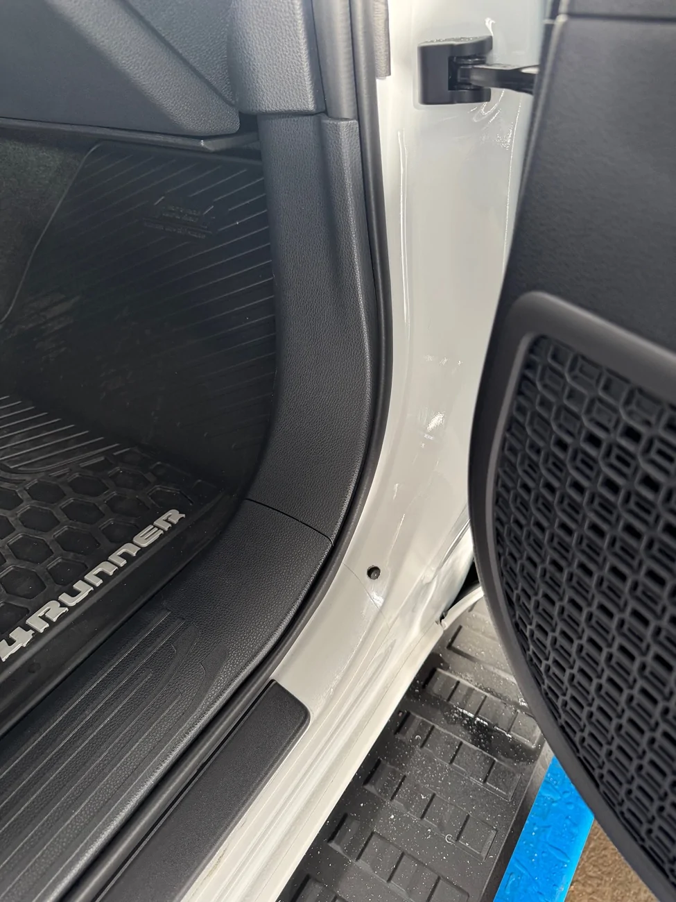

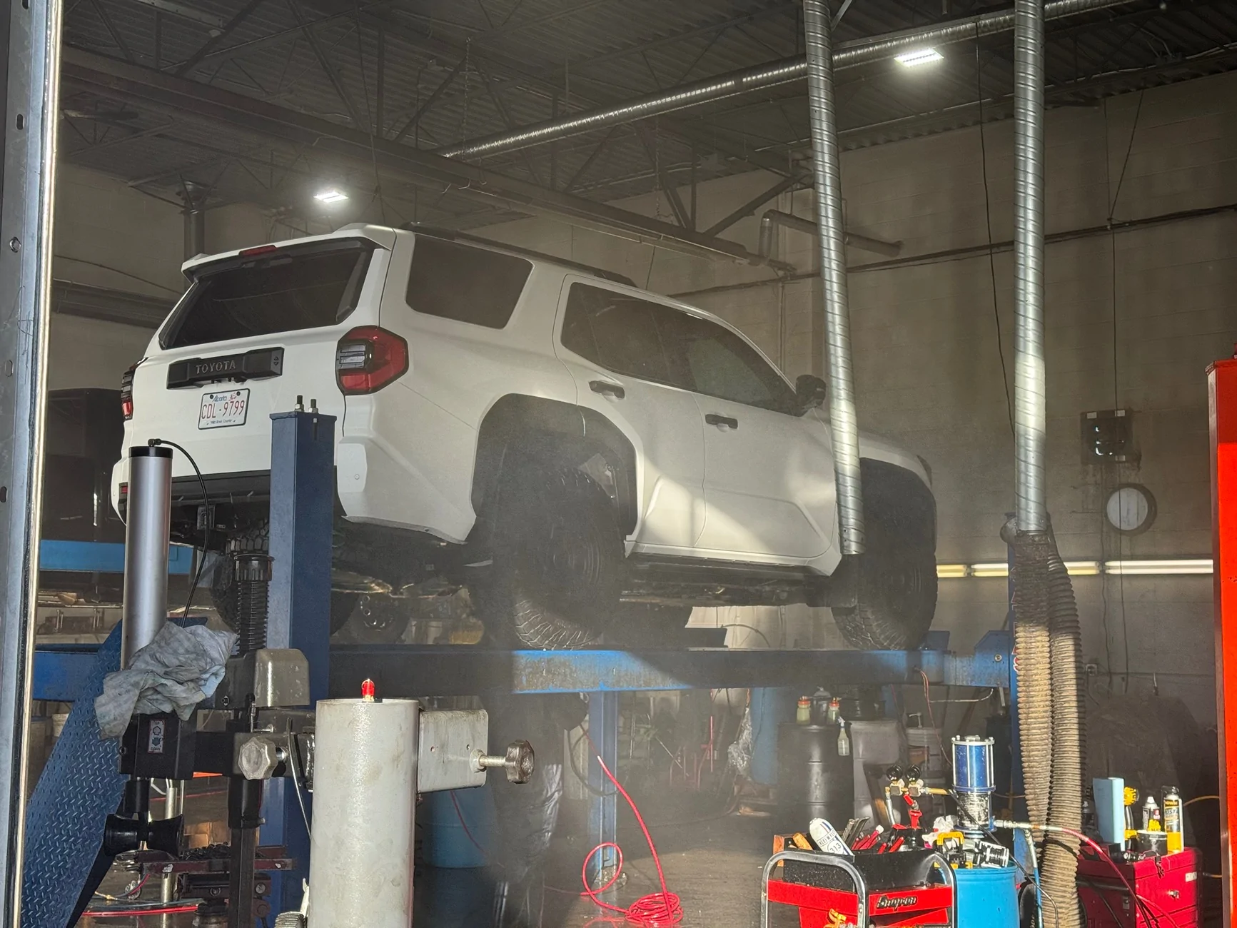

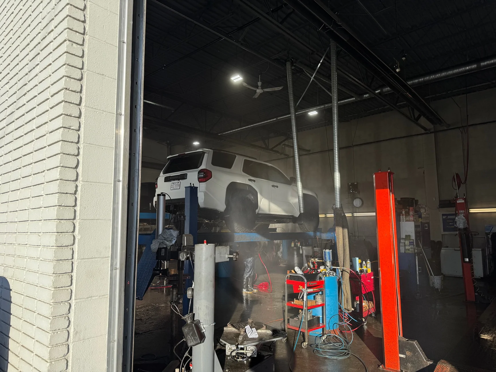

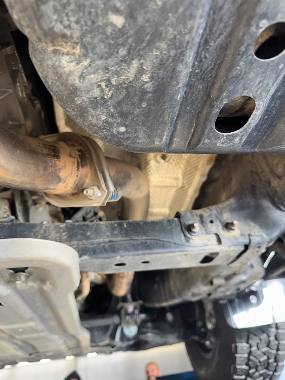

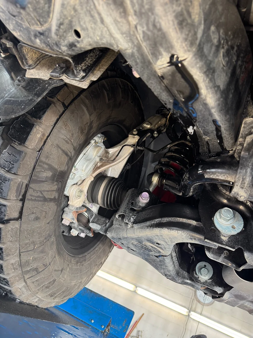

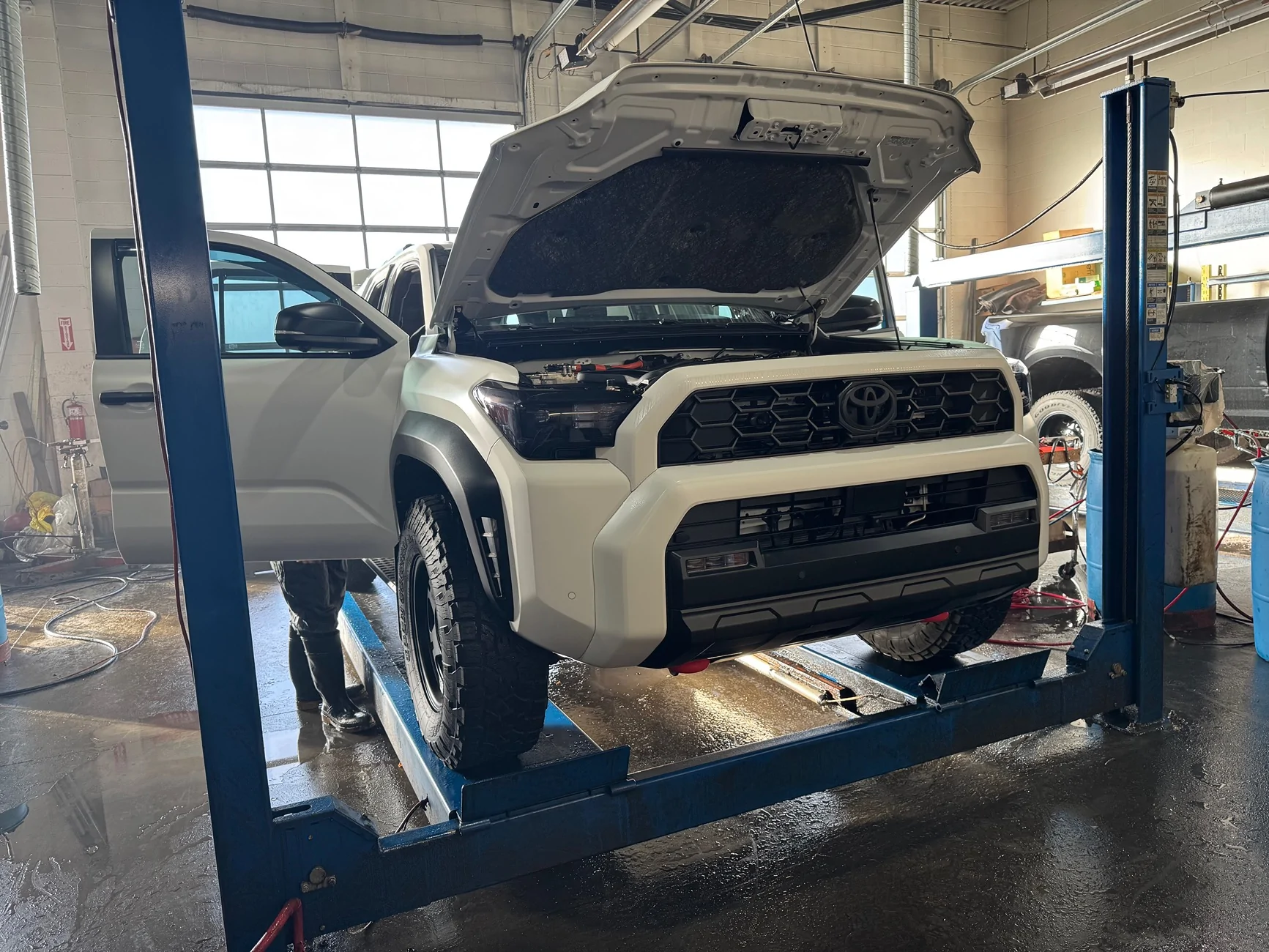

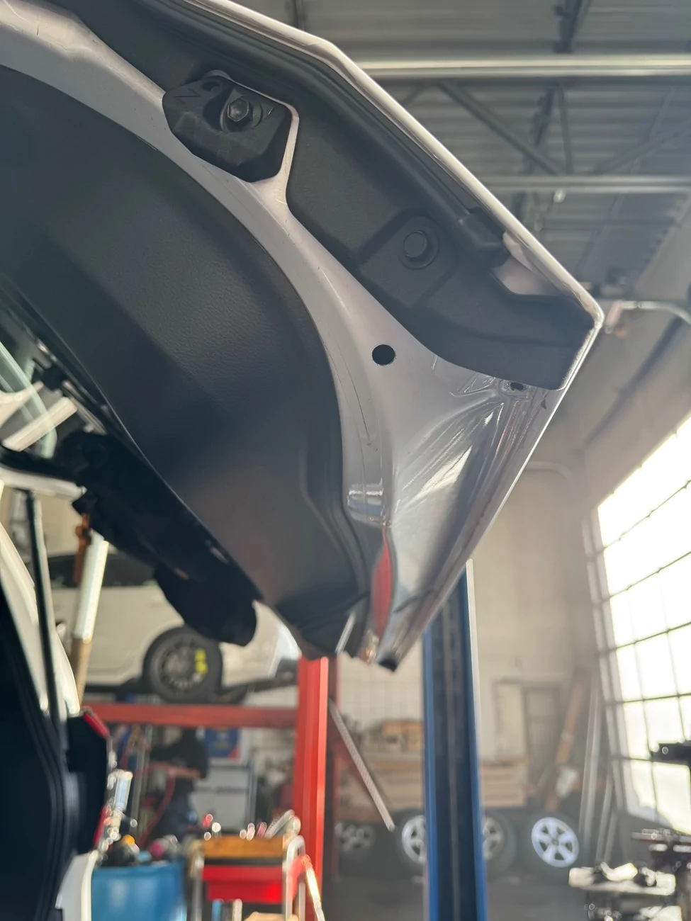

Heading to KROWN tomorrow to get ready for winter and Rustcoat the Stormtrooper!
https://krown.com/en/dealers/calgary-ab-163
Will take video's and images and update in the evening.
Hafiz is a personable and vey calm person to deal with while being informative. Highly recommend his facility.

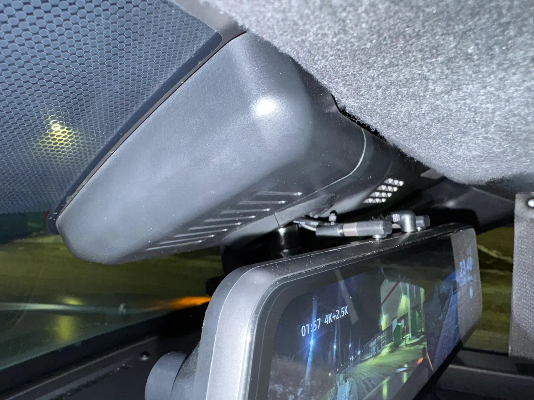

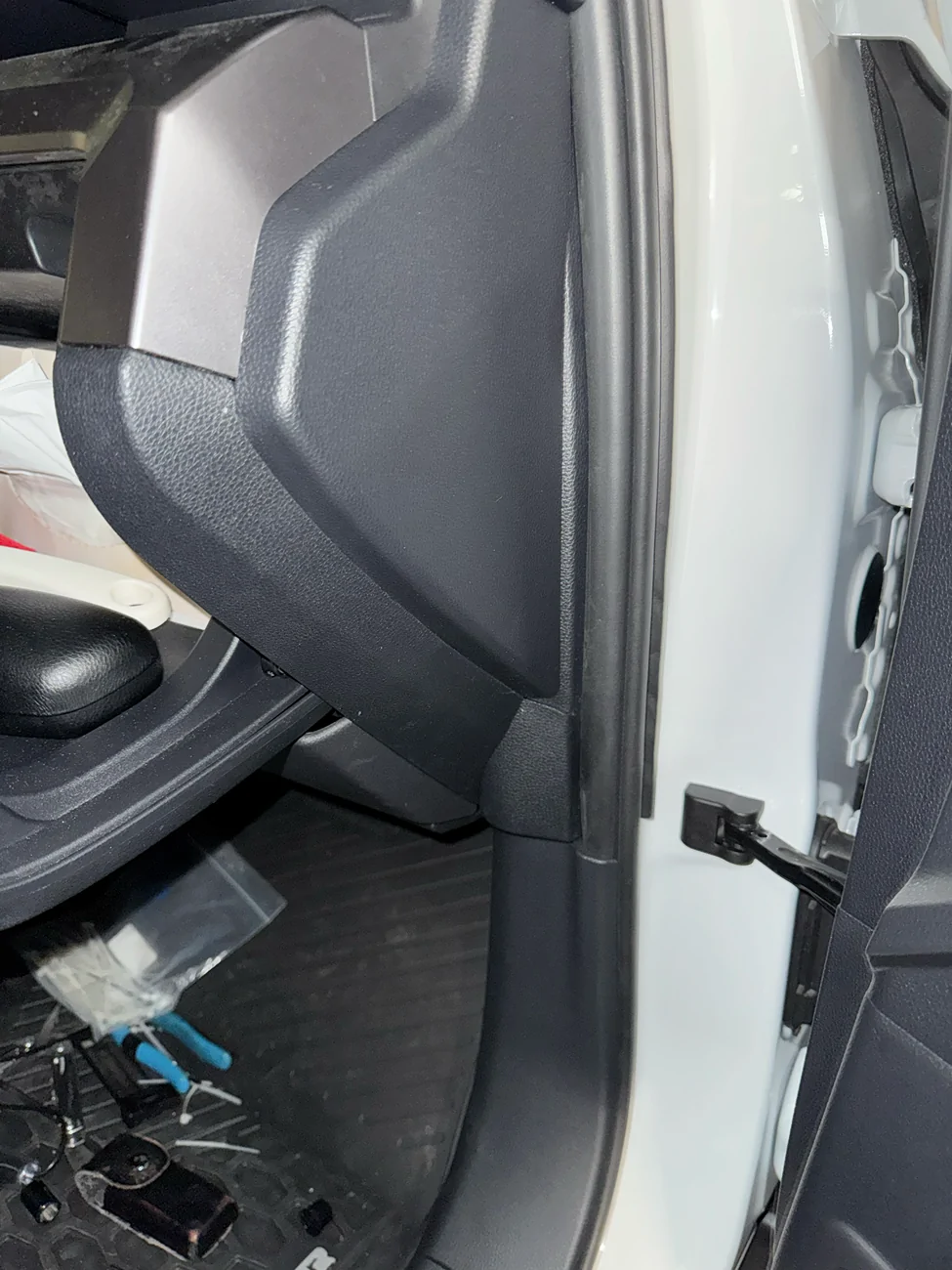

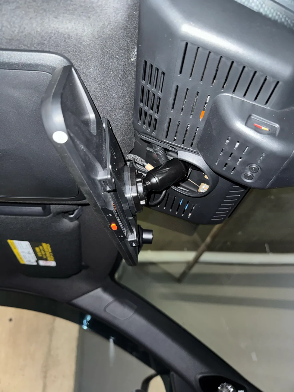

WolfBox G900TriPro Bumper Edition Install
WolfBox Direct Link:
https://hangzhoutanlinktechnologycoltd.pxf.io/3JGYzd
Step 1:
Hardwire Kit
Remove passenger side panels from door side:
2025 4runner 6th gen Stormtrooper by Van-Solo (TRD Off Road Hybrid) tempImageDaD1GU

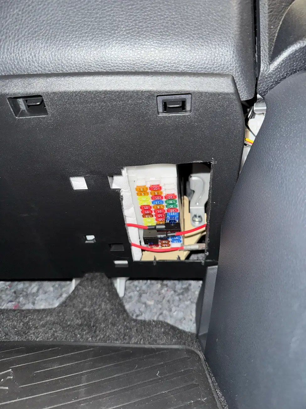

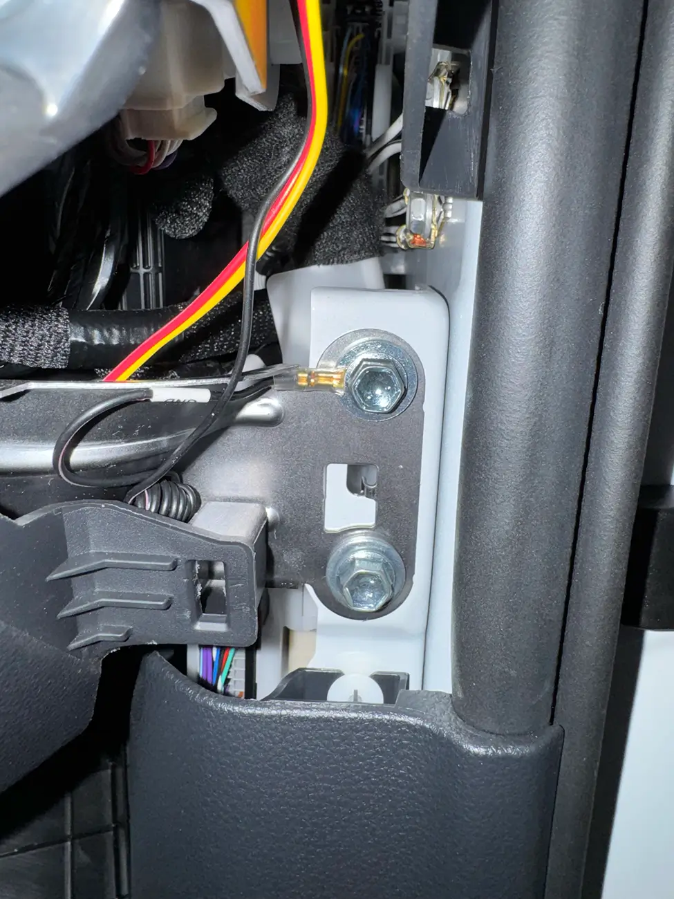

Run Hardwire kit to fuse panel under passenger footwell area:p
2025 4runner 6th gen Stormtrooper by Van-Solo (TRD Off Road Hybrid) tempImageXplvk5
Battery (Constant) Line to Door Lock Fuse (15Amp) (Always On)
Acc+ (Vehicle Switched On) to the 15Amp Power Outlet
Ground is right near:
2025 4runner 6th gen Stormtrooper by Van-Solo (TRD Off Road Hybrid) tempImageFHRA4m

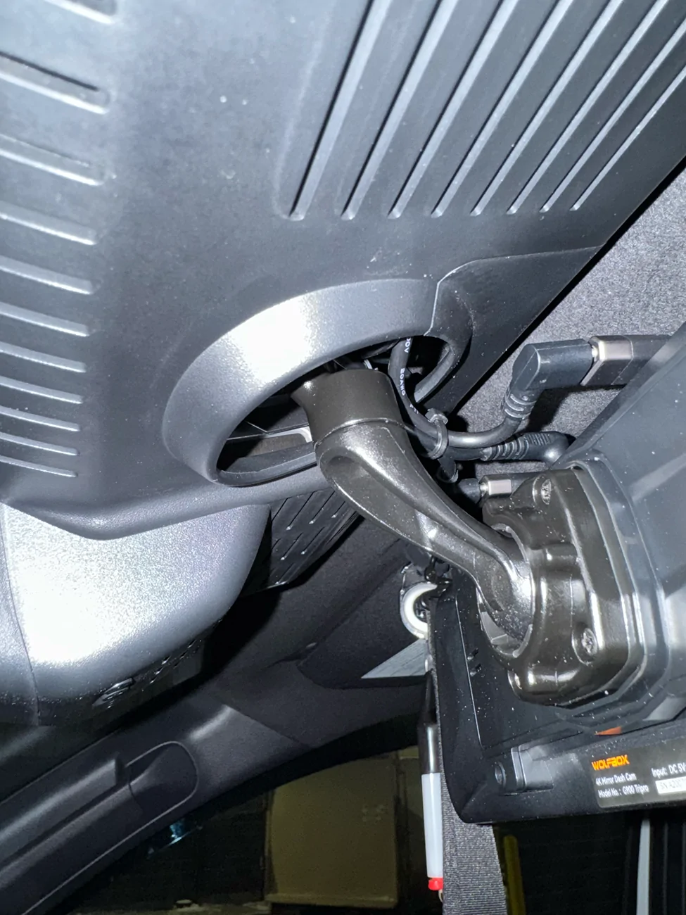

Run the USB-C cable up the passenger pillar to the Mirror Mount:
2025 4runner 6th gen Stormtrooper by Van-Solo (TRD Off Road Hybrid) tempImagevJ3LTl
Next run the GPS up the same Pilar also to the Mirror Mount:
I ran it under the passenger side dash mounted speaker grill and up the pillar to the Mirror Mount.
Now you have activated the WolfBox G900TirPro main unit.
2025 4runner 6th gen Stormtrooper by Van-Solo (TRD Off Road Hybrid) tempImageT7GerP
So Far I have enjoyed the WolfBox G900 Series with its crisp screen and full mirror replacement mount, however I feel the mount could be a bit longer making it sit a bit lower and allowing just a bit more articulation. But it works!
Next we will be activating the rear camera, Stay Tuned!

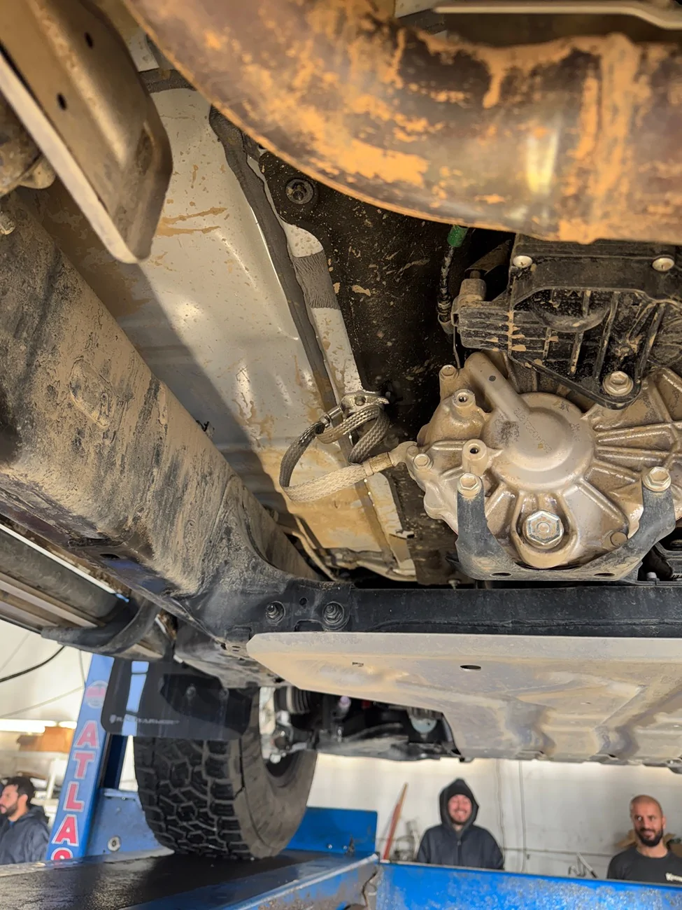

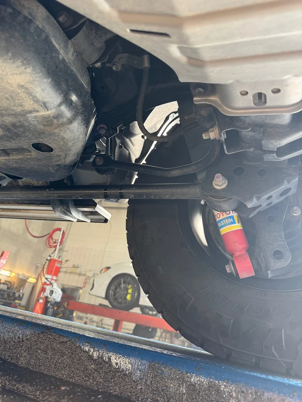

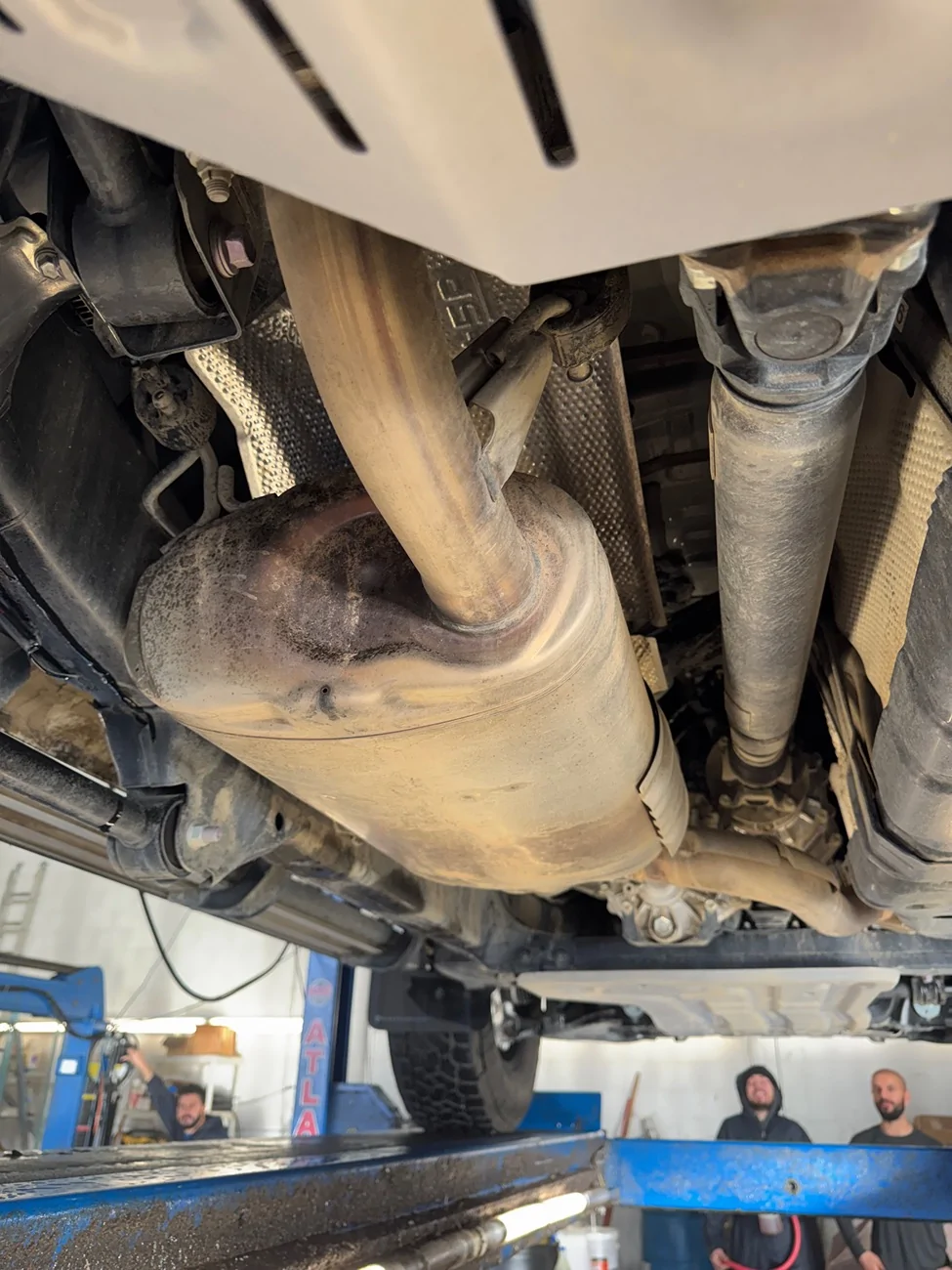

Hello Van,
by any chance do you have the part number for that Toyota skid plate for the transmission engine. It looks like it's one piece, I can't really tell. Thanks in advance
Van Solo
Van Solo
Van
May 20, 2025
441
302
Calgary / Canada
Hello Van,
PT22835247 is the transmission OEM skid plate

We are still awaiting the Wolfbox #190 Bracket to complete our installation as the universal one is not allowing the required articulation.
Amazon says package is damaged? @Wolfbox

Update the WolfBox #190 Toyota bracket is a 100% perfect fit and finish to allow the true OEM look and feel.
@Wolfbox

No need to mess with fuse taps, Toyota already provided you with the right power next to where you need it...
