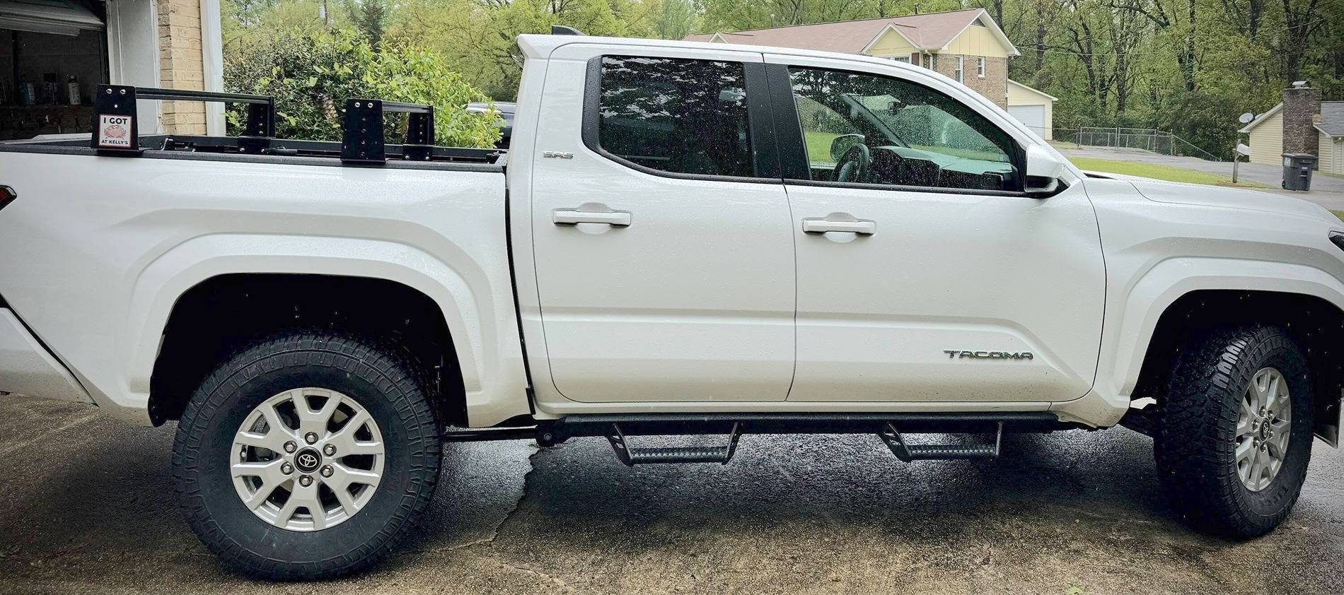

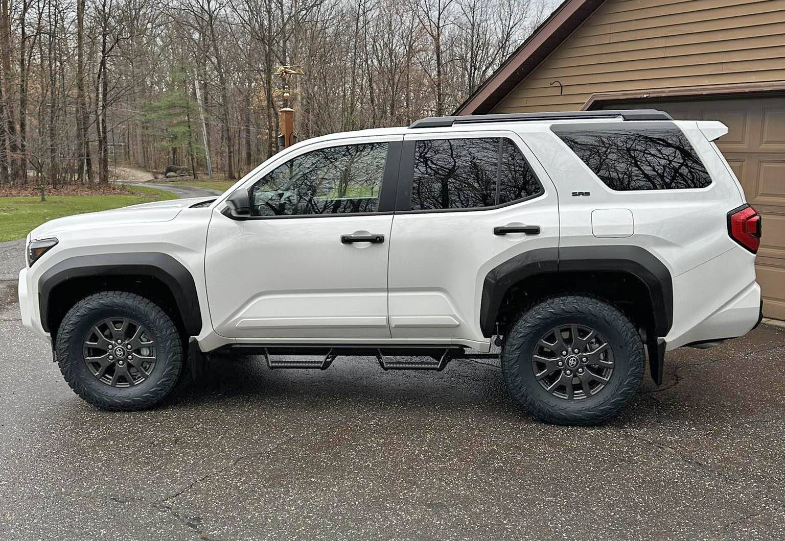

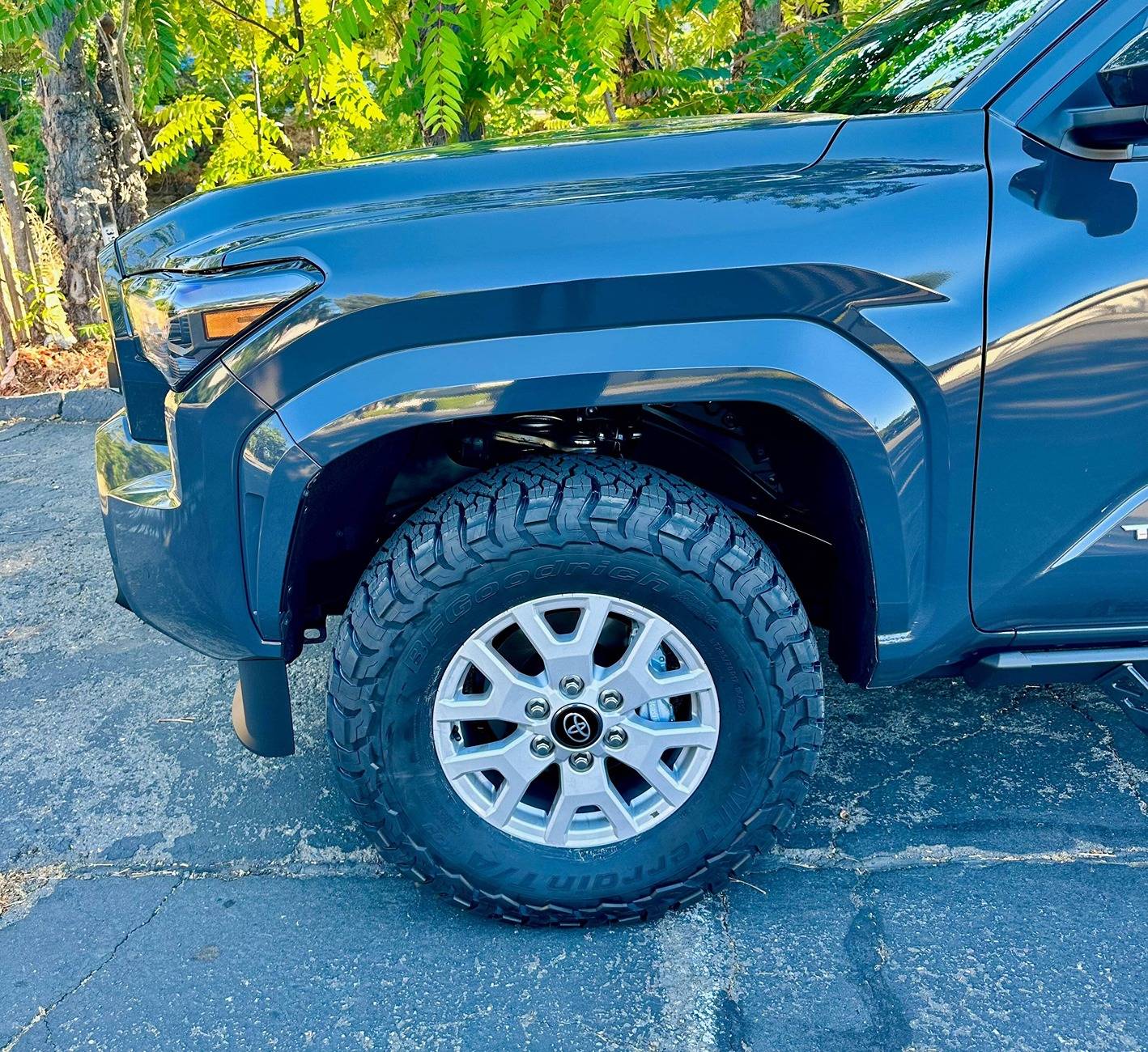

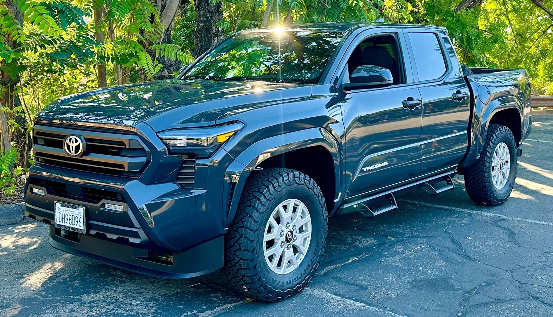

You can fit 33's on factory SR5 17" wheels.
Here's two examples of 33" tires on stock SR5 wheels on 2024 Tacomas (same fitment as 2025 4Runner) without modifications and no rubbing:
285/70R17 BFG KO3 tires (source)

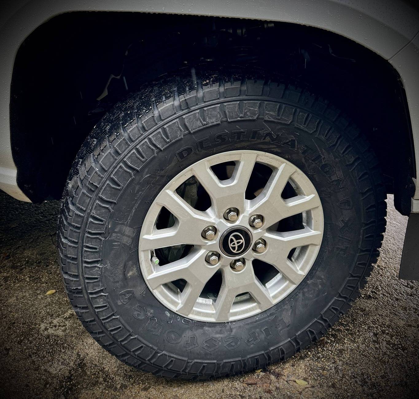

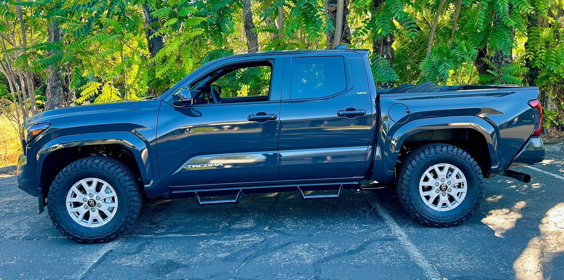

285/70R17 Firestone Destination X/T tires (source)

Thanks so helpful to know for my incoming SR5.
Those 33" KO3s upgrade the SR5's look instantly! ?

Those pics just convinced me to go with an SR5 instead of a TRD Offroad - thanks!

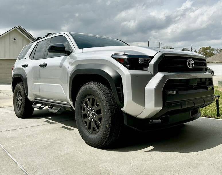

285/70/17 tires (Nitto Terra Grappler) on stock SR5 wheels - no rubbing at all. This one's not mine but thought it'd be helpful to share here.
