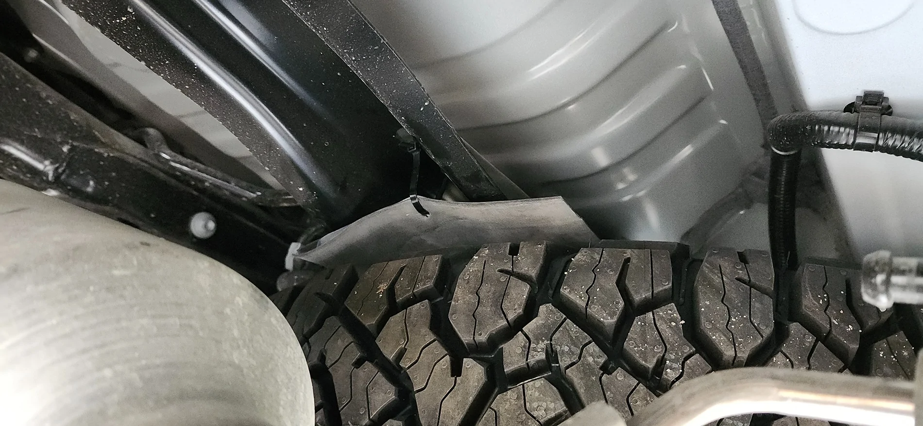

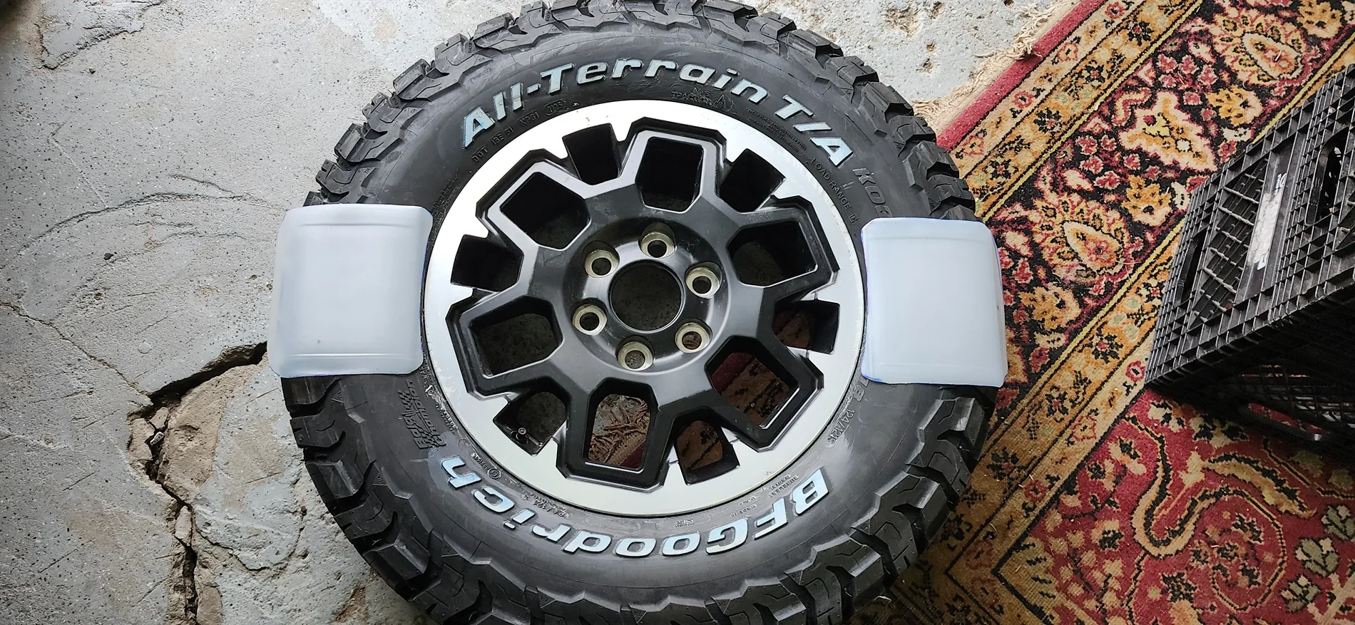

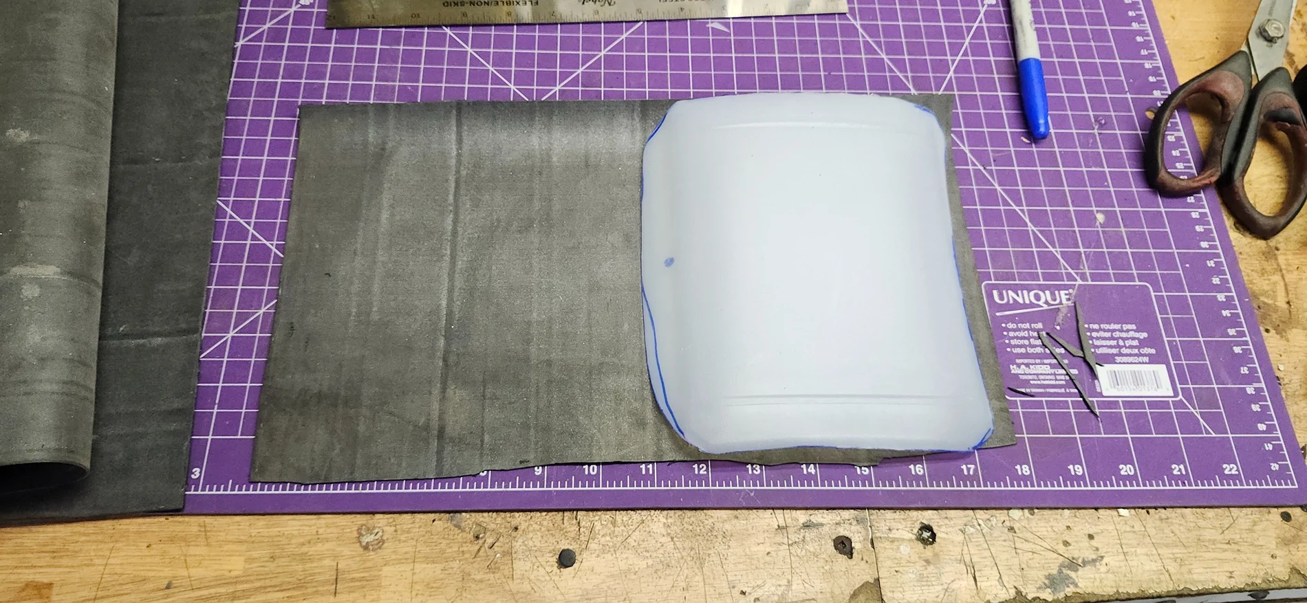

Here's my permanent bushfix. :) I used a windsheild washer container as the material had the perfect ratio of resistence / slipperiness. Added a layer of rubber on each side. Tiewraps to hold it in place (just to make sure...). I will do a few hundred km and do an inspection, but I'm confidend.
