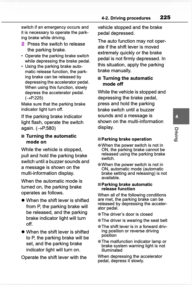

You can also turn off the auto mode, if you wish. You can also still use the switch even when auto mode is enabled.
2025 2026 4runner 6th gen Shifting to Reverse smoothly when parking uphill Screenshot 2026-03-31 at 11.09.23 AM
Parking brake
The parking brake can be
set or released automati-
cally or manually. In auto-
matic mode, the parking
brake can be set or released
automatically according to
shift lever operation.
Also, even in automatic
mode, the parking brake can
be set or released manually.
Parking brake
Thank you.

yes long press down, mid will show auto park disabled
long press up, mid will show auto park brake engaged
at any time in any mode, you can grab the park brake* and
pull up, it will engage.
*don't do this in motion unless it is an emergency
it will jolt you real hard, it cannot be feathered like hand or foot brake
