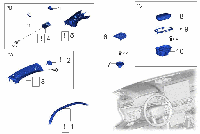

COMPONENTS (REMOVAL)
2025 2026 4runner 6th gen Service manuals? E549517N01
ďż˝
Procedure​
Part Name Code​
2025 2026 4runner 6th gen Service manuals? Z101297
2025 2026 4runner 6th gen Service manuals? Z101188
2025 2026 4runner 6th gen Service manuals? Z101187
1​
FRONT DOOR OPENING TRIM WEATHERSTRIP LH​
62312B​
2025 2026 4runner 6th gen Service manuals? Z101187​
2​
FRONT NO. 1 PILLAR GARNISH COVER LH​
62216B​
3​
FRONT PILLAR GARNISH ASSEMBLY LH​
62212B​
4​
PILLAR ASSIST GRIP ASSEMBLY​
74680​
5​
FRONT PILLAR GARNISH ASSEMBLY RH​
62211U​
6​
NO. 1 INSTRUMENT PANEL SPEAKER PANEL SUB-ASSEMBLY​
55408F​
7​
FRONT NO. 2 SPEAKER ASSEMBLY​
86160P​
8​
NO. 1 SPEAKER WITH BOX ASSEMBLY​
86150​
9​
NO. 3 INSTRUMENT PANEL SPEAKER PANEL SUB-ASSEMBLY​
55474E​
10​
NO. 2 SPEAKER WITH BOX ASSEMBLY​
86150B​
*A​
for LH Side​
*B​
for RH Side​
*C​
for 14 Speakers​
*1​
FRONT PILLAR ASSIST GRIP PLUG​
â—Ź​
Non-reusable part​

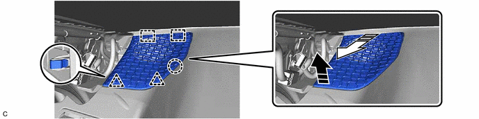

6. REMOVE NO. 1 INSTRUMENT PANEL SPEAKER PANEL SUB-ASSEMBLY
Click here 2025 2026 4runner 6th gen Service manuals? Z101297
7. REMOVE FRONT NO. 2 SPEAKER ASSEMBLY
2025 2026 4runner 6th gen Service manuals? E549518

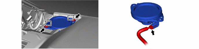

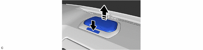

8. REMOVE NO. 1 SPEAKER WITH BOX ASSEMBLY (for 14 Speakers)
2025 2026 4runner 6th gen Service manuals? E549519C01
2025 2026 4runner 6th gen Service manuals? V100135
Push​
2025 2026 4runner 6th gen Service manuals? V113147
Remove in this Direction​

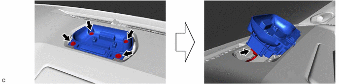

10. REMOVE NO. 2 SPEAKER WITH BOX ASSEMBLY (for 14 Speakers)
2025 2026 4runner 6th gen Service manuals? E549520

here is one part you likely need
42. REMOVE NO. 1 INSTRUMENT PANEL SPEAKER PANEL SUB-ASSEMBLY
2025 2026 4runner 6th gen Service manuals? B730444C01
Remove in this Direction (1)​
2025 2026 4runner 6th gen Service manuals? V113148
Remove in this Direction (2)​
