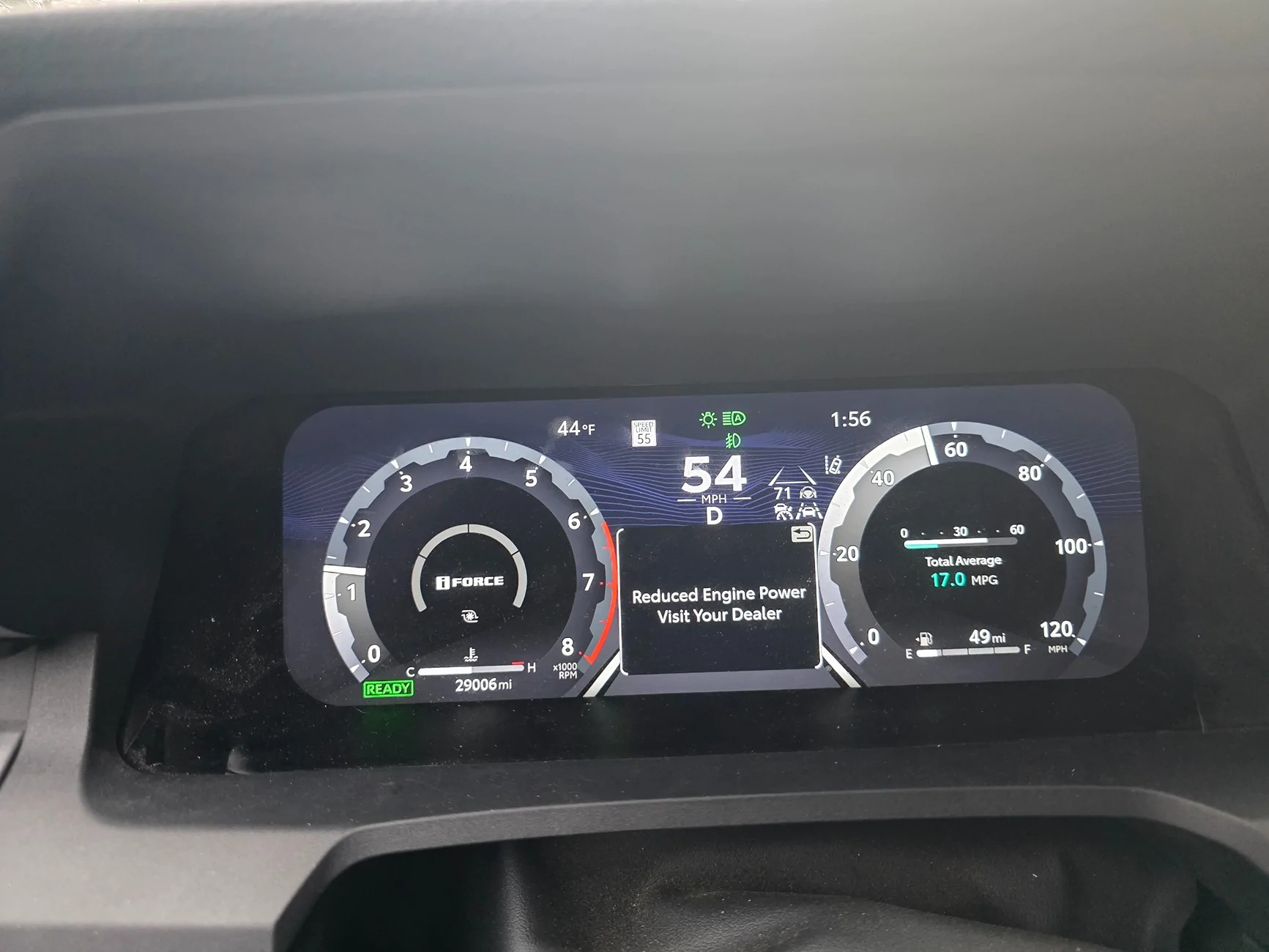

I have a picture of my dash thats it with that reduced power
