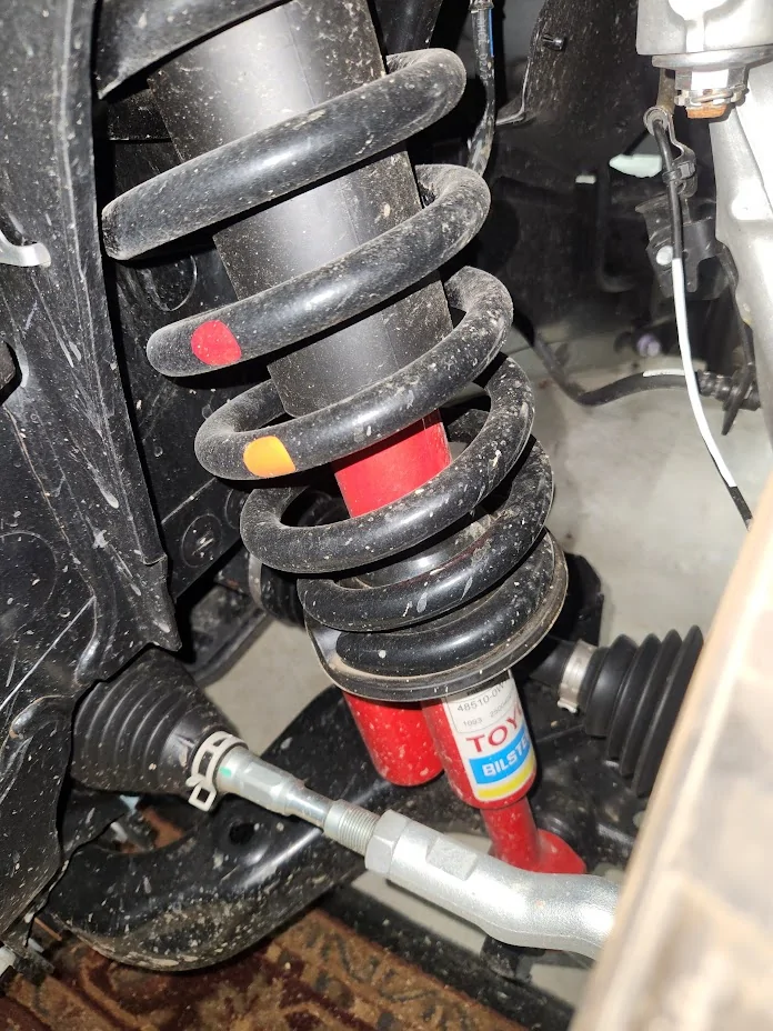

No issue, just a curiosity as I contemplate moving to larger tires and whether I'll need some sort of lift kit. Does anyone know what these marks on my front springs are/were for? (this is driver's side)

I don't know about Toyotas, but I know other manufacturers used colored dots to identify spring rates. Different trims or model years could have different spring rates, so they color code them to identify them in assembly.
2,805
1,583
are the color dots the same for front and rear axle and side to side?
2,805
1,583
the only think i can find is an old ref to a tundra color chart for springs
Stock 4X2 coils
- drivers: yellow-white
- passengers: blue-white
Stock 4X4 coils
- drivers: yellow-green
- passengers: blue-green
TRD 4X4 coils
- drivers: yellow-yellow
- passengers: blue-yellow
TRD 4X2 coils
- drivers: red-yellow
- passengers: purple-yellow

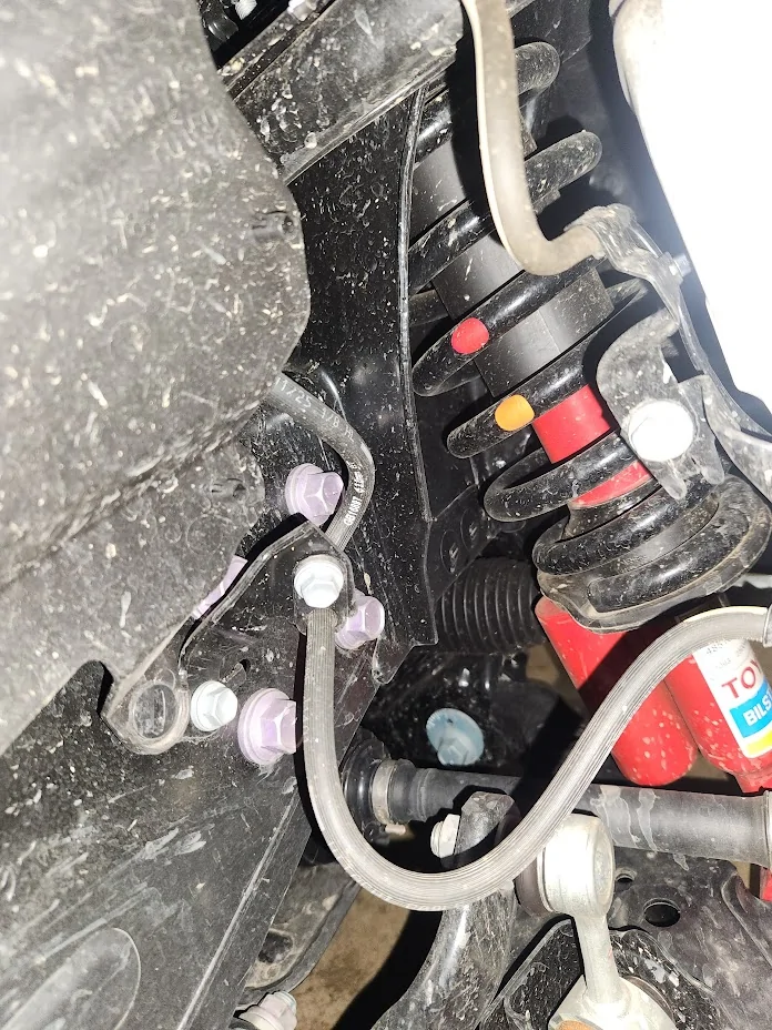

Anyway - the (partial) answer is, for my TRD ORP the passenger side front spring has same red/yellow markings as the driver’s side. (I forgot to check the rear.)
if the rears have different markings, then i would guess they are axle specific.
only way to truly tell is to look at other trims to see if those have different colors per axle than yours.
then that would answer your question of coils being trim specific
