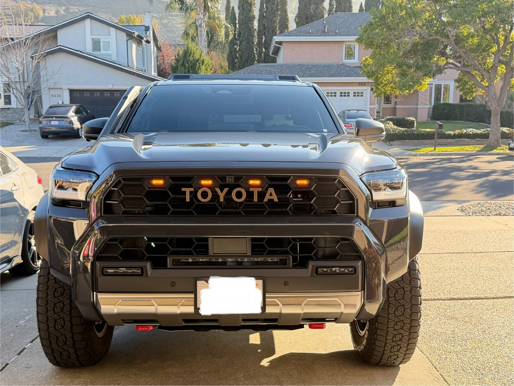

Installed these on my Pro Grille, no drilling. Don't even notice them until you turn them on. Look great.
I used one of the pigtails for the aux switches to make the hookup.
https://www.amazon.com/dp/B0DLL9BQ17?ref=ppx_yo2ov_dt_b_fed_asin_title&th=1
These are the easiest to install and they look great. Mine are hooked up directly to a spare fuse in the fuse box. They turn on when the car turns on, off when the car is off.

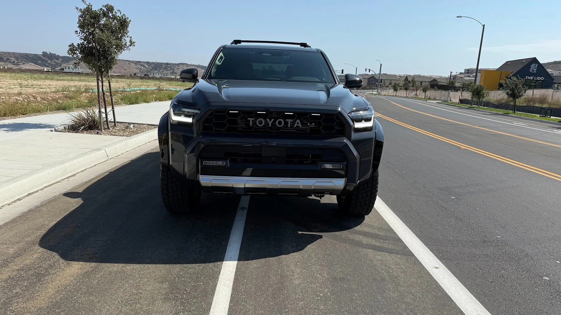

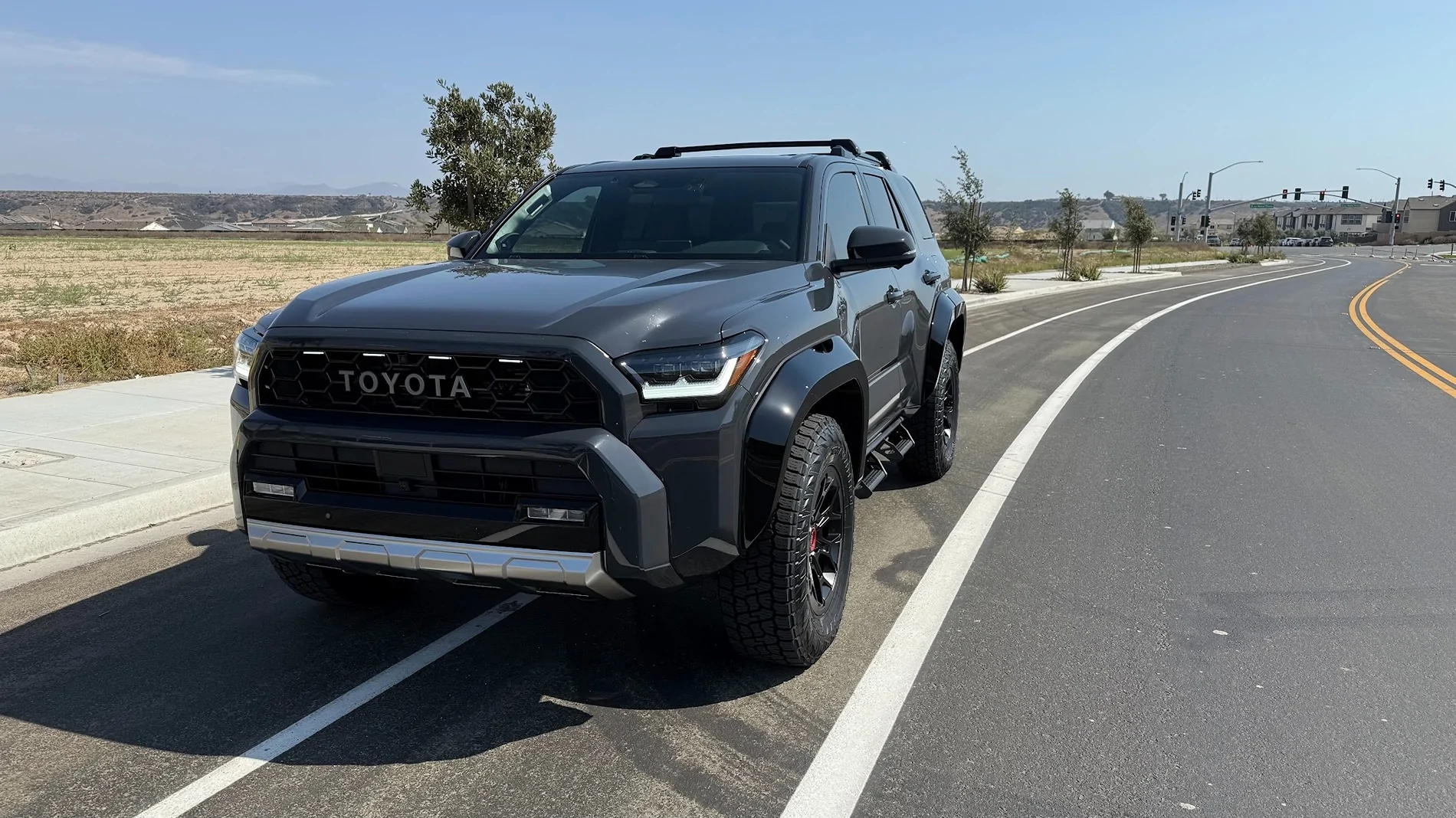

***UPDATE***
Do not buy these if you have a Pro/TH, etc. I just got mine and will be returning them to Hansshow which will take my feedback and revise the product to my needs.
1. They do not technically fit in my Pro grill. They seem loose.
2. The diamond design of the light mounts do not match the horizontal line design of the Pro Grill
3. They are matte and the Pro grill is gloss black, so they stick out like a sore thumb.
4. The light lenses themselves are clear so the LEDs inside stick out. They're noticeable.
Therefore I ordered the versions many of you ordered off Amazon that are smoke and mounted via 3M tape.
Just wanted to give everyone a heads up since I originally posted about them being an option. Not quite...
