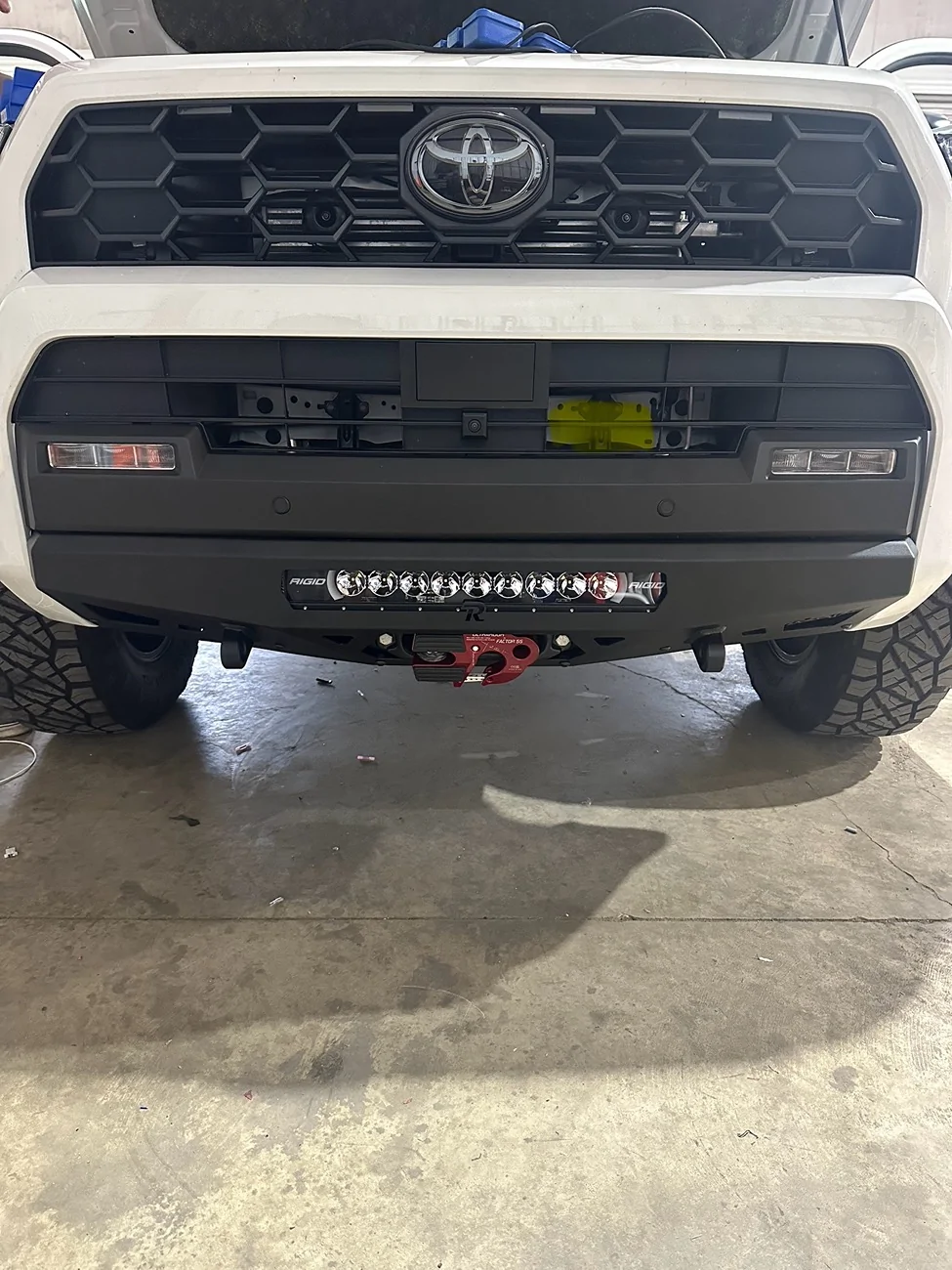

How is the access to the winch?
I have small hand so I was able to get to it thru the front grill. But for someone with bigger wrist, they might have to do a little cutting or trimming that little cross bar. I highlighted the area in the picture
But my warn winch is wireless, so I don’t really need to reach back there.
2025 2026 4runner 6th gen Rago Bumpers (Front & Rear) installed with winch IMG_0204

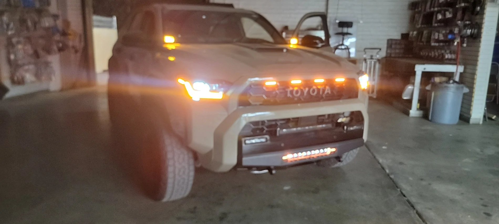

I also have the Rago front bumper with the Rigid light bar installed on my TRD Pro.
Want to go with the Warn 10s winch but I'm concerned about how to reach in there to move the clutch on top to lock and unlock it in place. Even though it is wireless I'm curious how it would work?
Since you have the light bar from the pro also. I’m not sure how. But maybe you can get by the whole next to it
