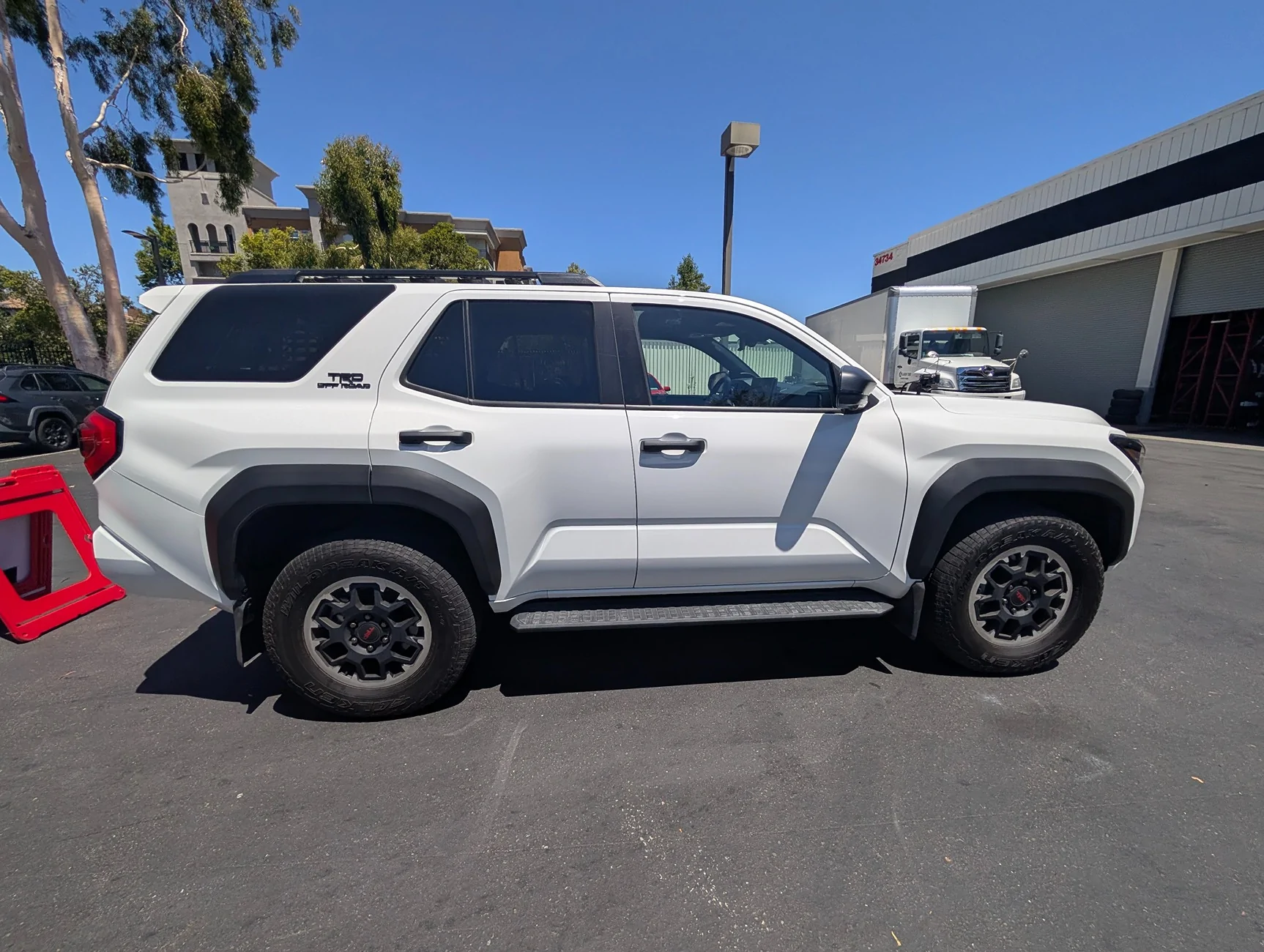

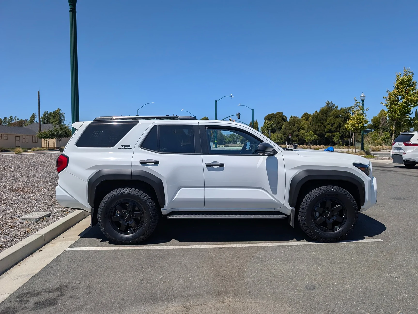

Put on some new shoes today!
As I do mostly easier to lower-intermediate trails and use the 4runner as a daily driver my goal was to stay in the 33-34" range and avoid any cutting/lifting or think about re-gearing yet
Went with the Pirelli Scorpions (LT275/70/R18) and Raceline Addict (18x8, +35mm offset) and this is probably as close as you could cut it w/o making any adjustments
Before

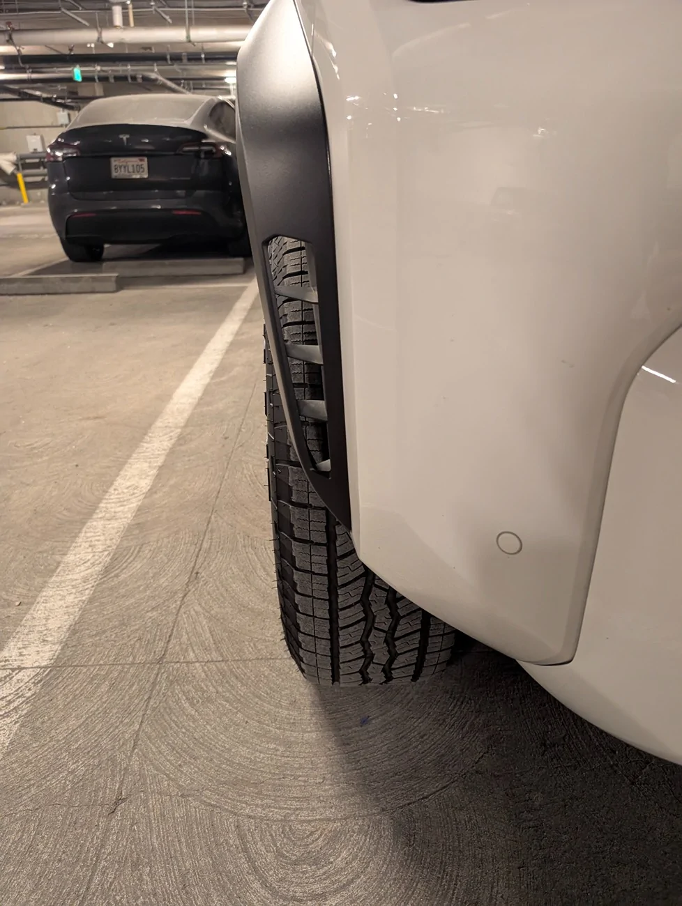

After
2025 2026 4runner 6th gen Pirelli Scorpions (LT275/70/R18) on Raceline Addicts (+35mm) PXL_20260727_213813866
2025 2026 4runner 6th gen Pirelli Scorpions (LT275/70/R18) on Raceline Addicts (+35mm) PXL_20260727_213823420.MP
2025 2026 4runner 6th gen Pirelli Scorpions (LT275/70/R18) on Raceline Addicts (+35mm) PXL_20260727_213829094

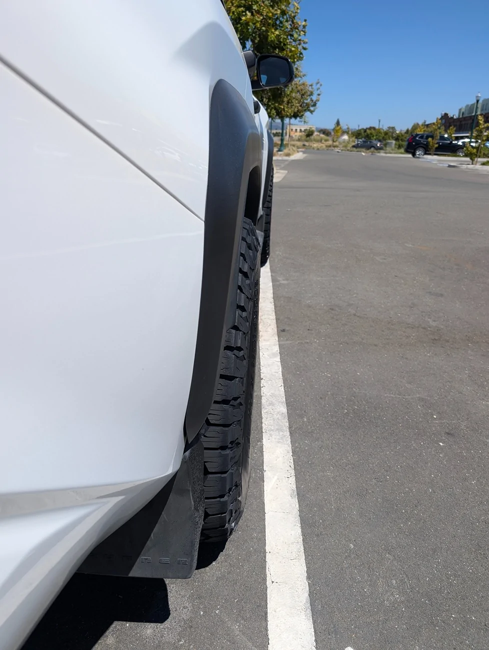

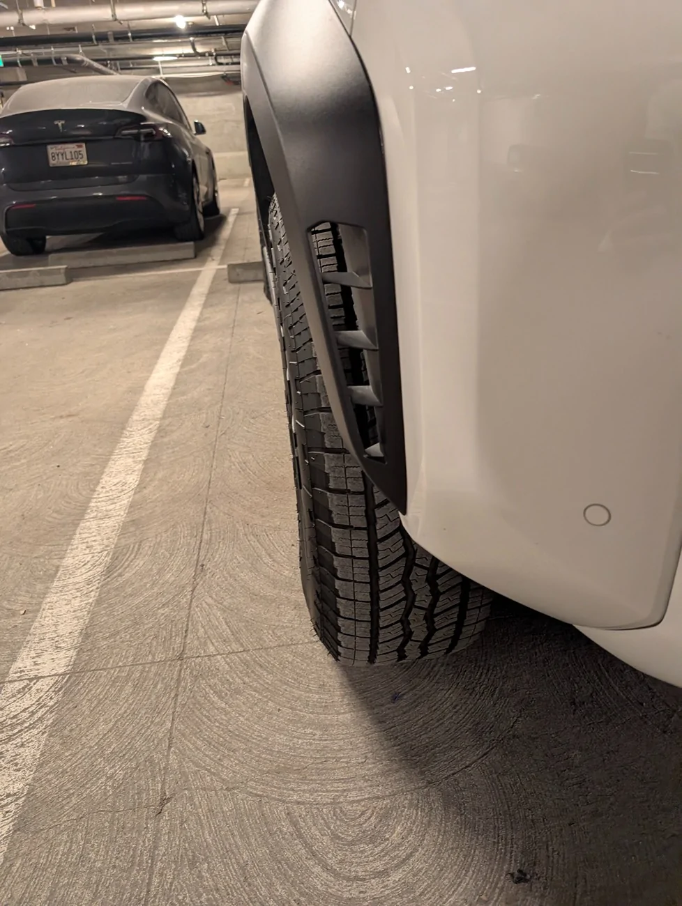

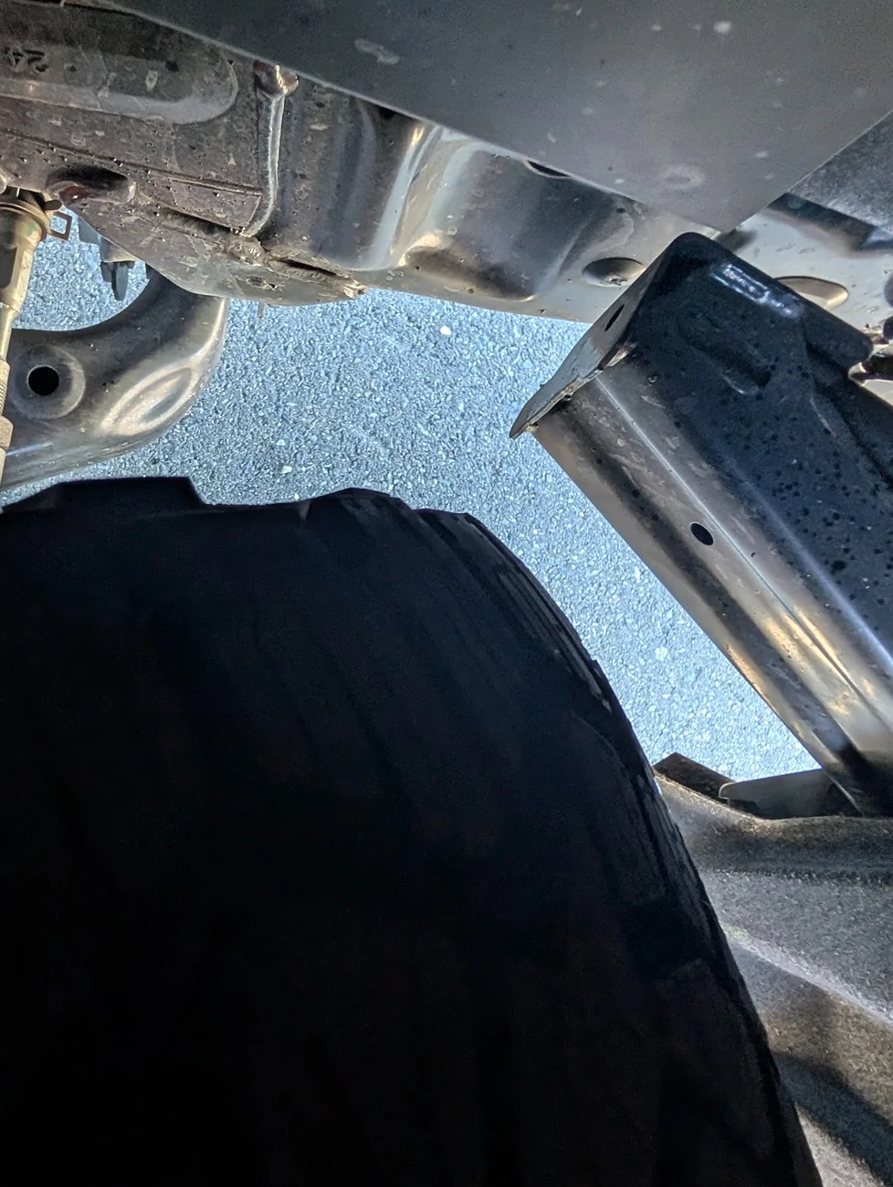

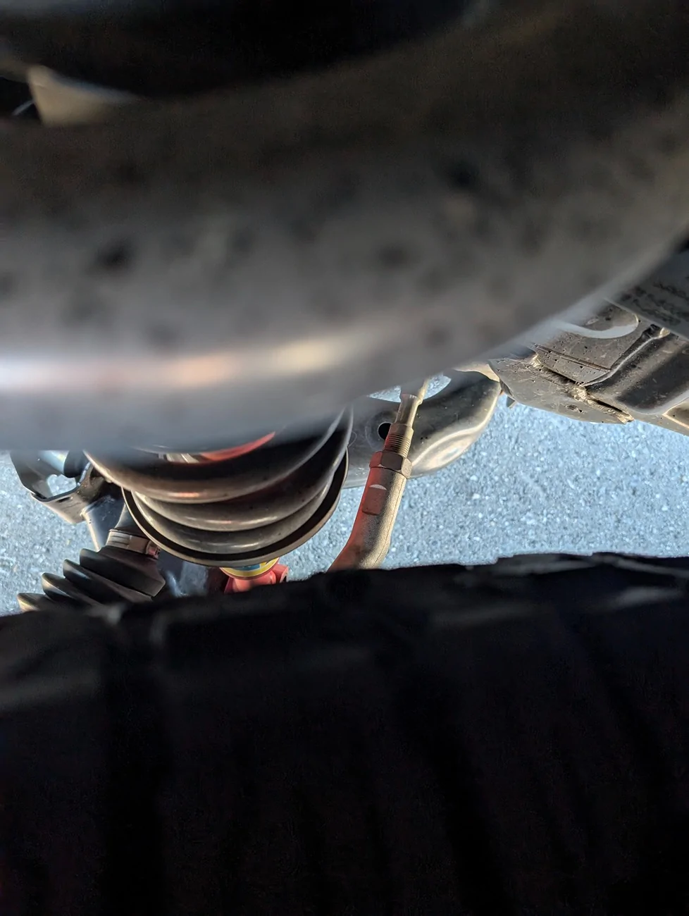

Wheel well shots w/ the steering fully articulated and places where the gap was smallest
2025 2026 4runner 6th gen Pirelli Scorpions (LT275/70/R18) on Raceline Addicts (+35mm) PXL_20260727_213618974
2025 2026 4runner 6th gen Pirelli Scorpions (LT275/70/R18) on Raceline Addicts (+35mm) PXL_20260727_213627740
2025 2026 4runner 6th gen Pirelli Scorpions (LT275/70/R18) on Raceline Addicts (+35mm) PXL_20260727_213644395
2025 2026 4runner 6th gen Pirelli Scorpions (LT275/70/R18) on Raceline Addicts (+35mm) PXL_20260727_213656354
2025 2026 4runner 6th gen Pirelli Scorpions (LT275/70/R18) on Raceline Addicts (+35mm) PXL_20260727_213714647
2025 2026 4runner 6th gen Pirelli Scorpions (LT275/70/R18) on Raceline Addicts (+35mm) PXL_20260727_213703243
2025 2026 4runner 6th gen Pirelli Scorpions (LT275/70/R18) on Raceline Addicts (+35mm) PXL_20260727_205758688

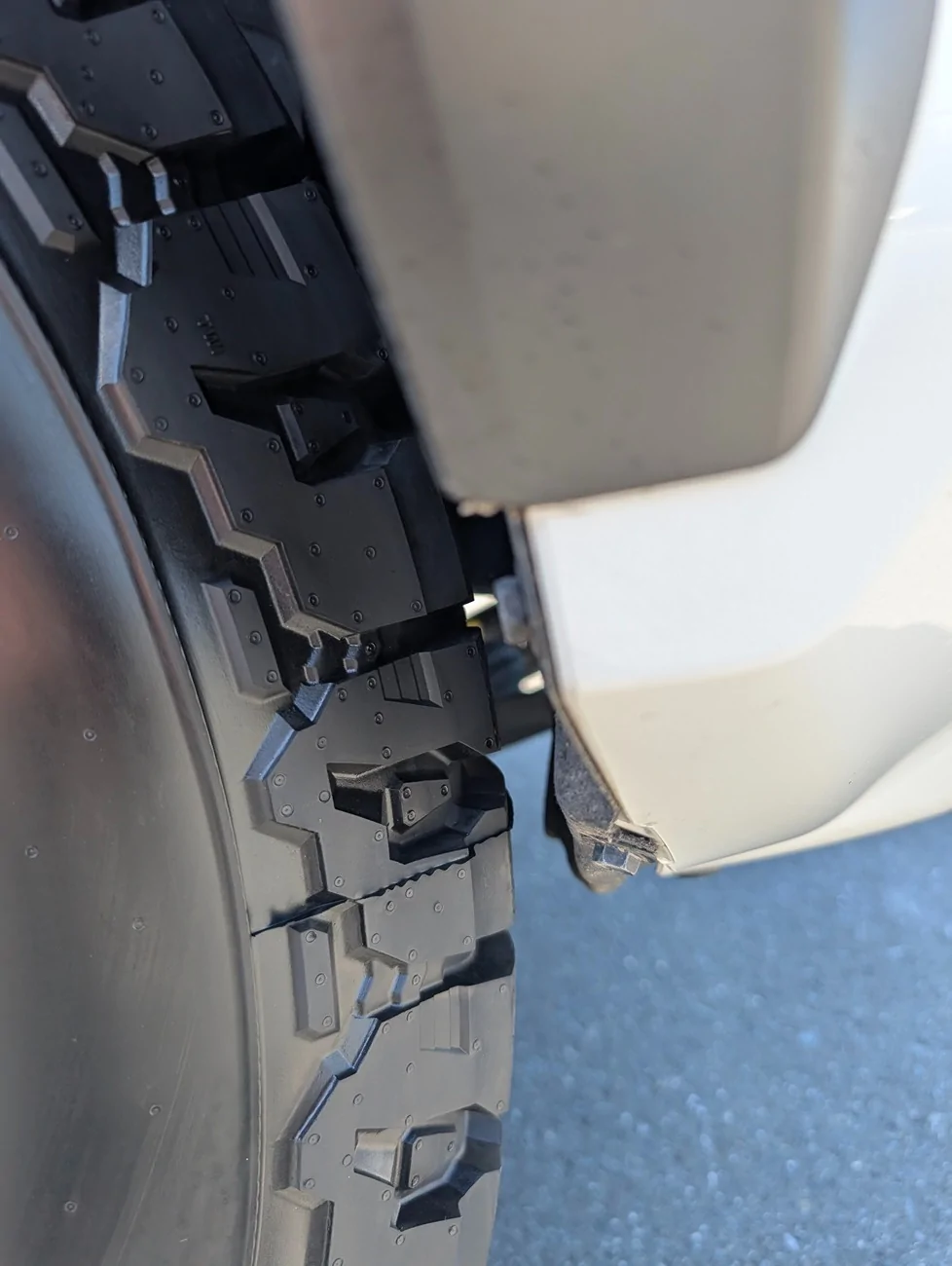

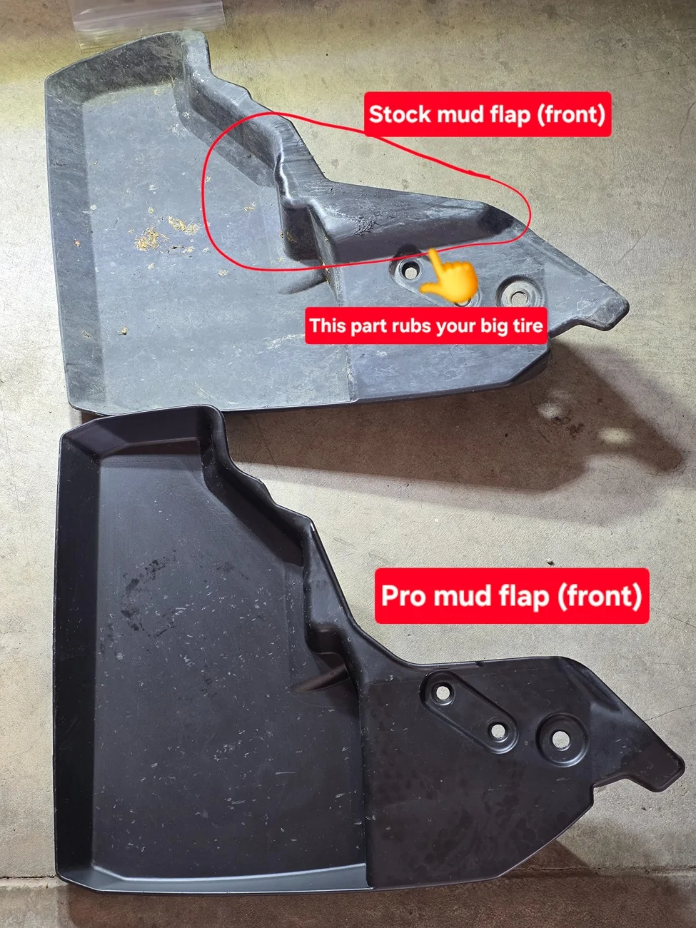

I'd suggest switching to Pro model mud flaps for wider coverage & no chance for rubbing. Stock mud flaps also have a piece that cut in half an inch. It rubs on mine 275/70/18 Falken Wildpeaks AT4W. See pic below.
2025 2026 4runner 6th gen Pirelli Scorpions (LT275/70/R18) on Raceline Addicts (+35mm) 20260604_184042
2025 2026 4runner 6th gen Pirelli Scorpions (LT275/70/R18) on Raceline Addicts (+35mm) 20260604_185942
2025 2026 4runner 6th gen Pirelli Scorpions (LT275/70/R18) on Raceline Addicts (+35mm) 20260604_182206
O amazing thanks for the tip! I'll search for those mud flaps!
BonRunner
Dec 2, 2025
520
606
2026 TRD Sport Premium / WCP

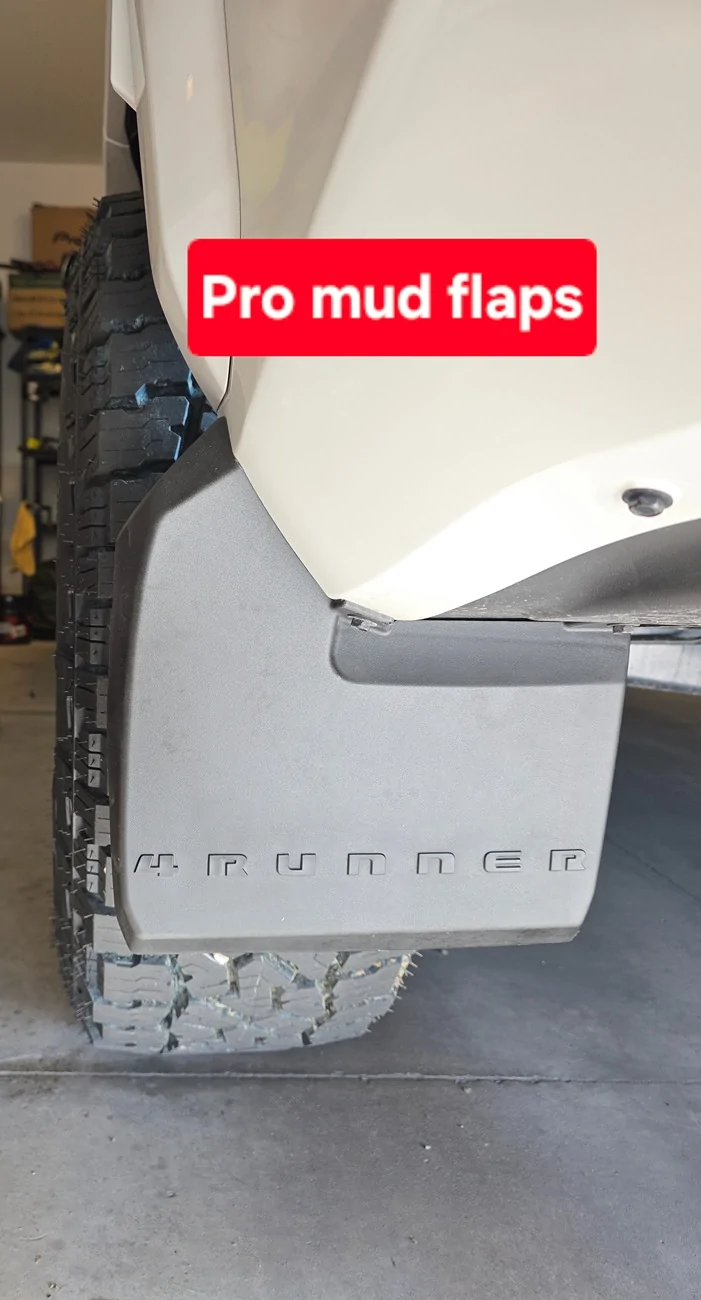

I have a friend who bought this aftermarket extended wide mud flaps on Amazon: https://amzn.to/4fXSaUL
I compared them to my TRD Pro wide flaps and they are 99.9% the same!! All the bolts line up perfectly. Only thing that difference is the rear flaps don't have the word "4RUNNER".. hence the $58 price. My Pro flaps cost over $200 🤯

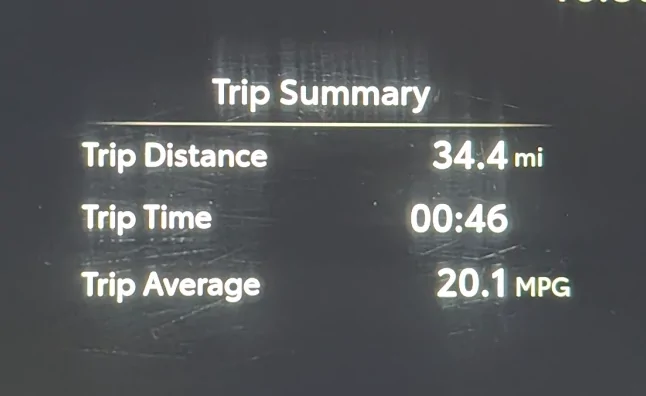

5. MPG - I've only done one longer drive day which is my usual commute (~60miles/shift round trip) which I would say is 70% highway/30% local and so far have noticed the expected 1-2mpg loss. This is on normal mode and I'm fairly light on the pedal. A snip below from my drive back w/ minimal traffic
