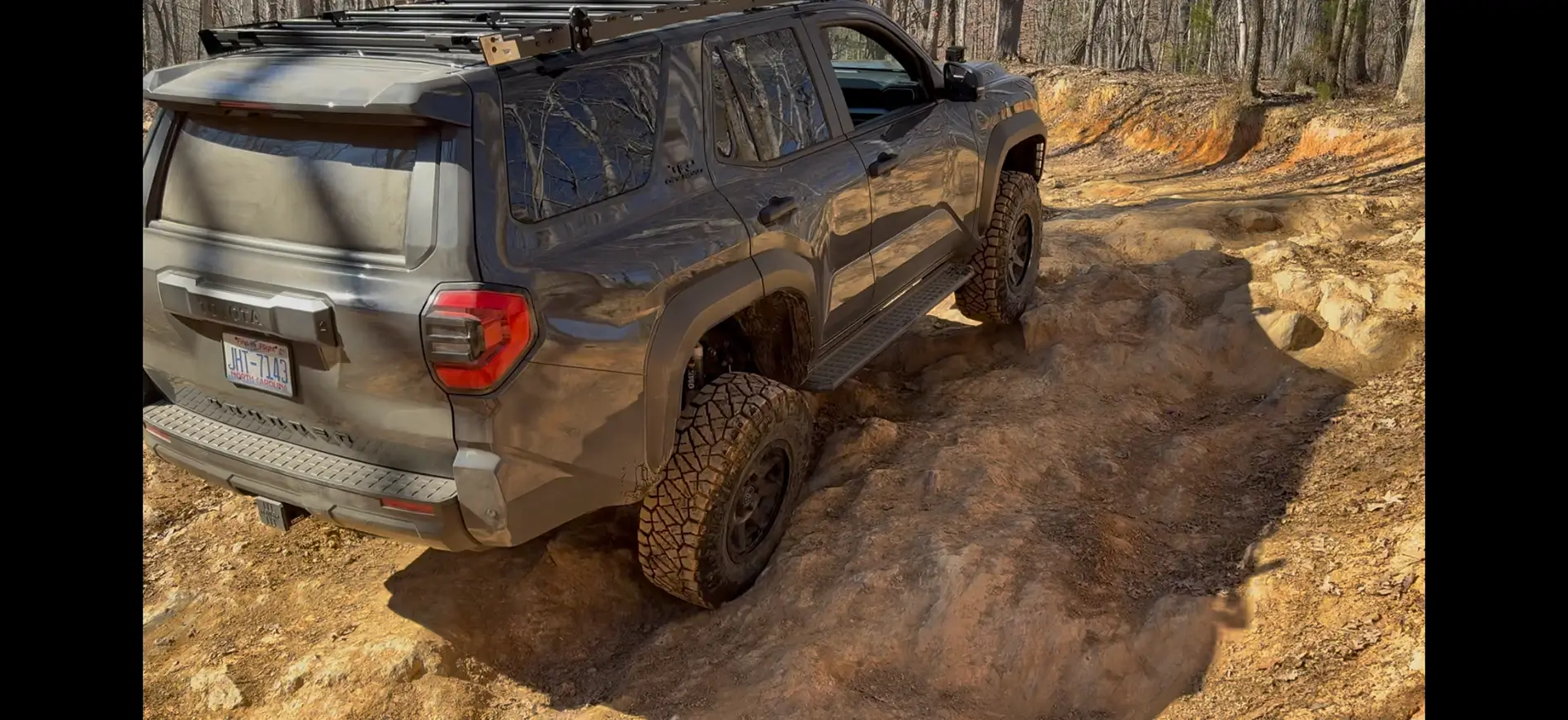

Nice build! What modifications did you have to do to fit the new tires? Did you need to remove the crash brackets?

It was a tight fit with the brackets so I removed them for a lot more clearance.

Very nice looking 4runner!...quick question regarding the OME MT64 installation, did you have to buy/add additional parts besides what is coming with the kit? One dealer is telling me here that in order to use the OME MT64 kit for the 4runner, it is recommended to add Front/Differential Drop kit, Tubular Lower Link Kit, Rear, Tubular Upper Link Kit, and Billet Adjustable Track Bar Kit from another brand (icon). I thought OME MT64 contained all needed to do the installation.

I did not install anything other than what comes in the kit.
2025 4runner 6th gen Old Man Emu (OME) MT64 suspension w/ Upper Control Arms (UCA), Icon +25 offset wheels, Nitto Trail Grappler 285/75/17, RTT on TRD ORP IMG_1780

I asked ARB about a diff drop or a pan hard bar. They said that neither were needed with their kit. Since they did the suspension for the trailhunter, they probably know the platform fairly well.
