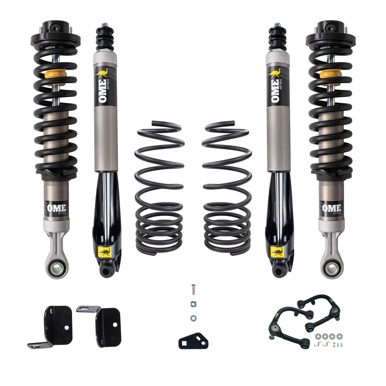

Old Man Emu kit number 2135K by ARB

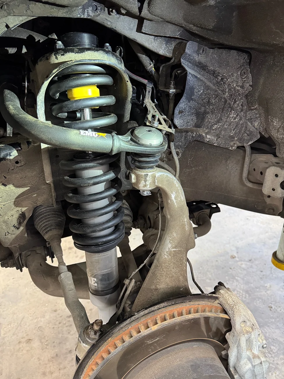

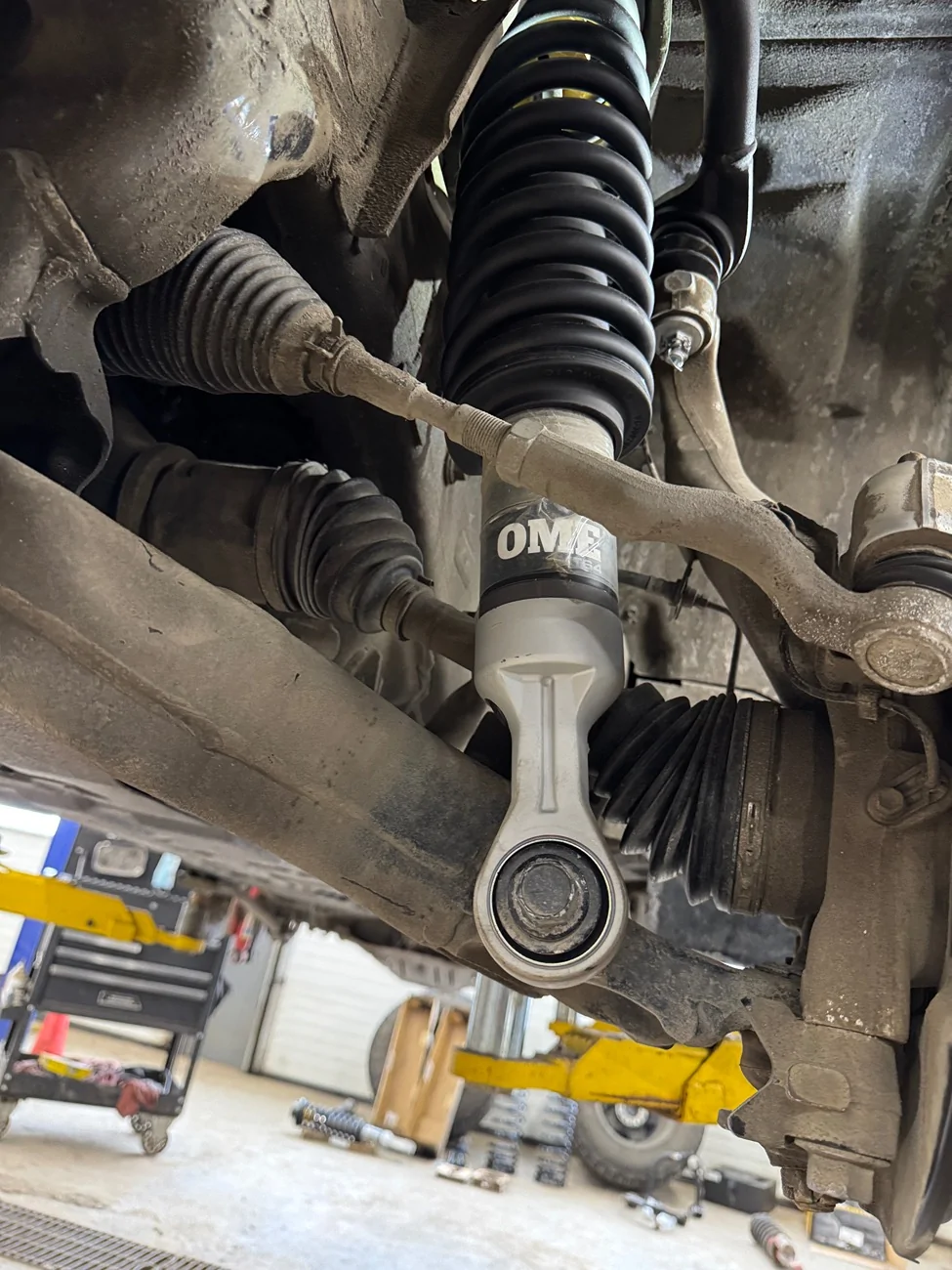

Included parts are as follows as seen in the image below:
- FK134 Brake Line Spacer Kit 1
- FK137 Sway Bar Spacer Kit Rear 1
- MT64601052 MT64 Shock Absorbers Rear 2
- 3344 Coil Springs Rear 2
- MT64996013 MT64 Coilover Struts Front 2
- UCA0037 Upper Control Arms 2 (with ABS spacer brackets)
Now this 2135K kit comes preset at 3" Front and 2" Rear lift

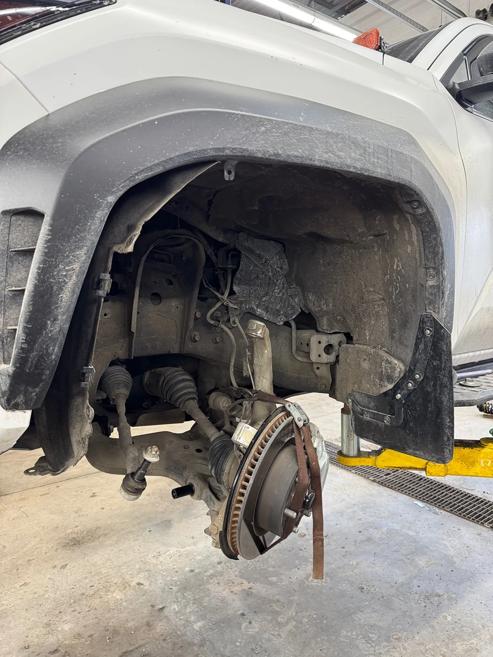

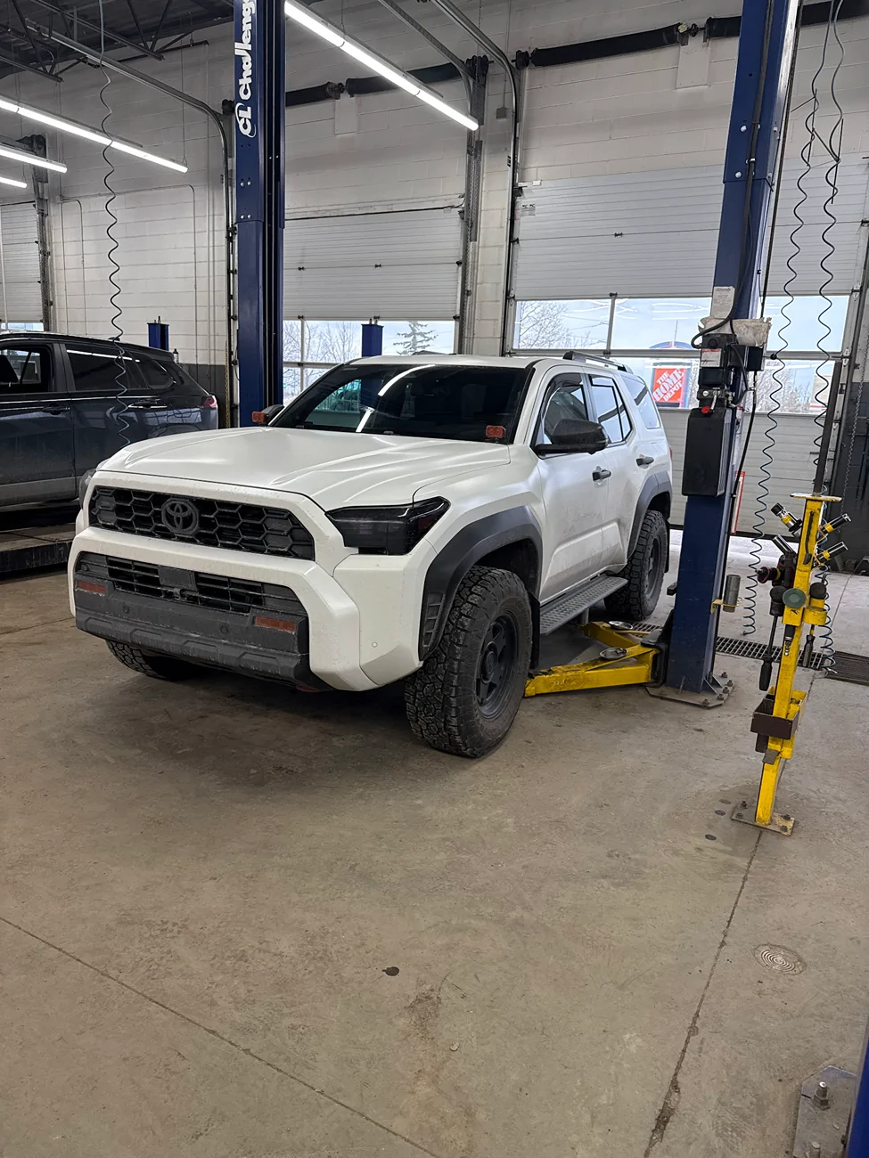

For the installation I opted to go with Kal Tire Shawnessy in Calgary, Alberta for a few reasons, the first being I knew a few folks at the location and felt comfortable with all of it.
Kiran is one of the assistant Managers and Darcy is a Technician with a lot of passion for work like this..
So lets us begin with the installation.

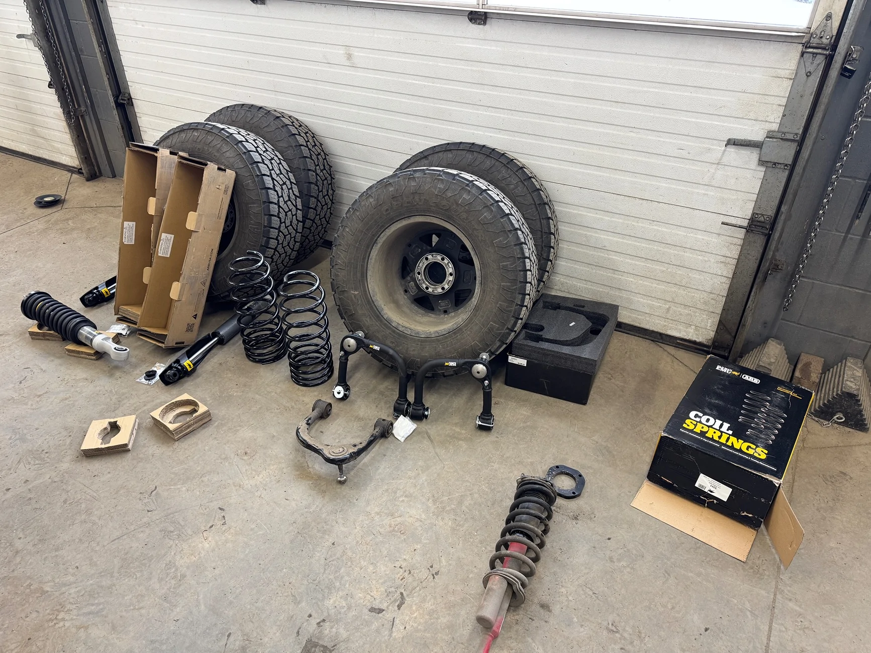

And the original parts video with Old Man Emu MT64 Kit 2135K

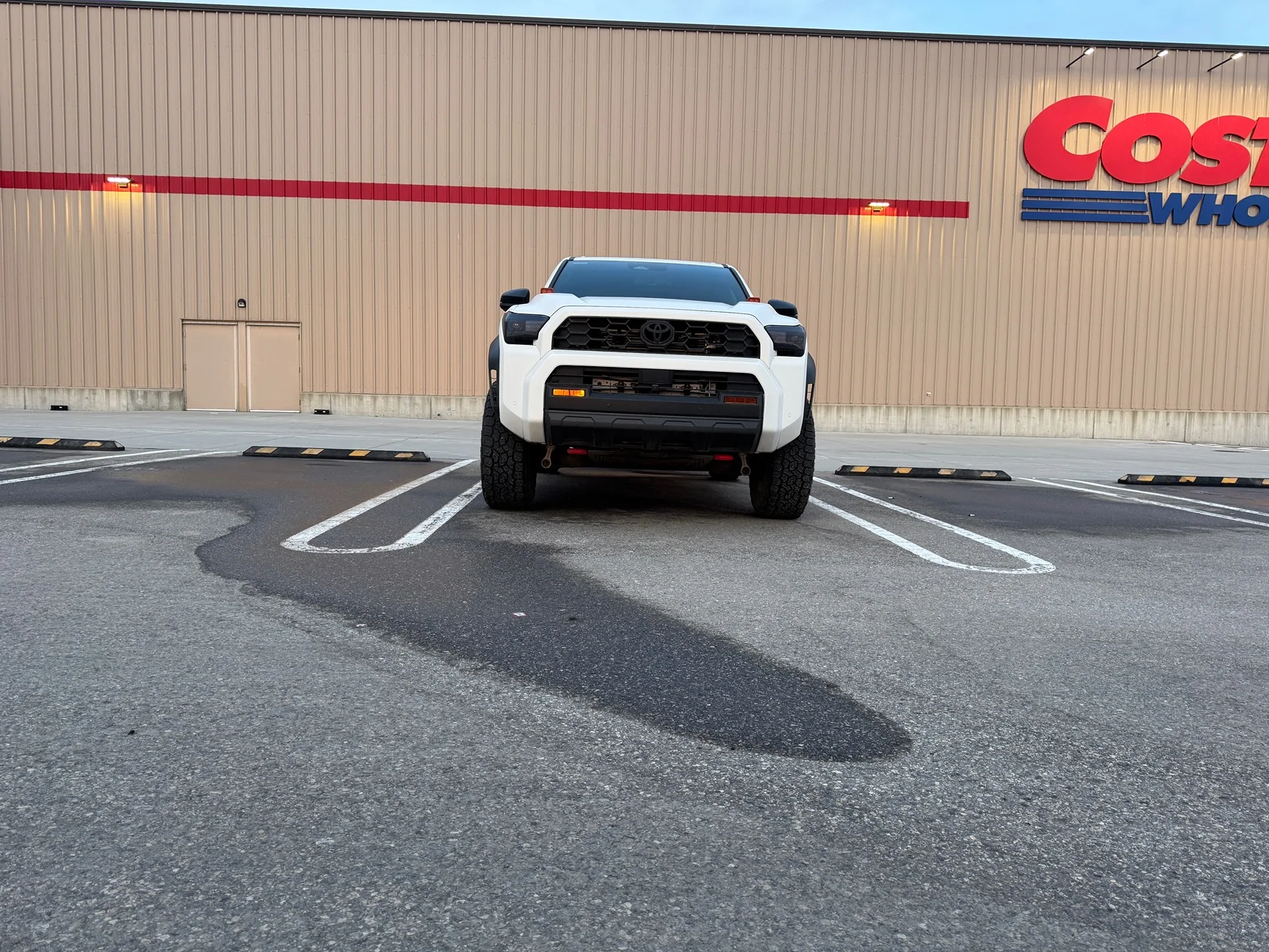

Before:
After:
Remaining Parts:

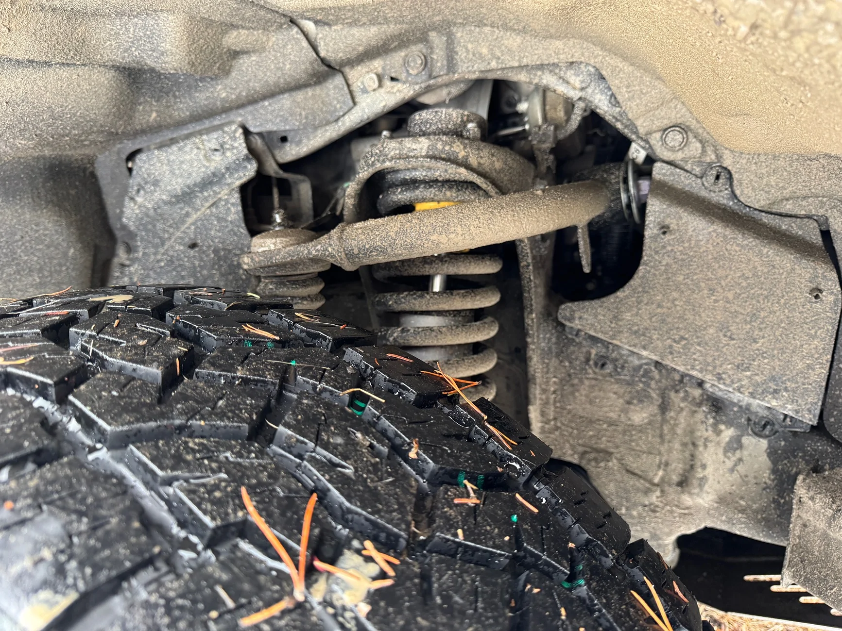

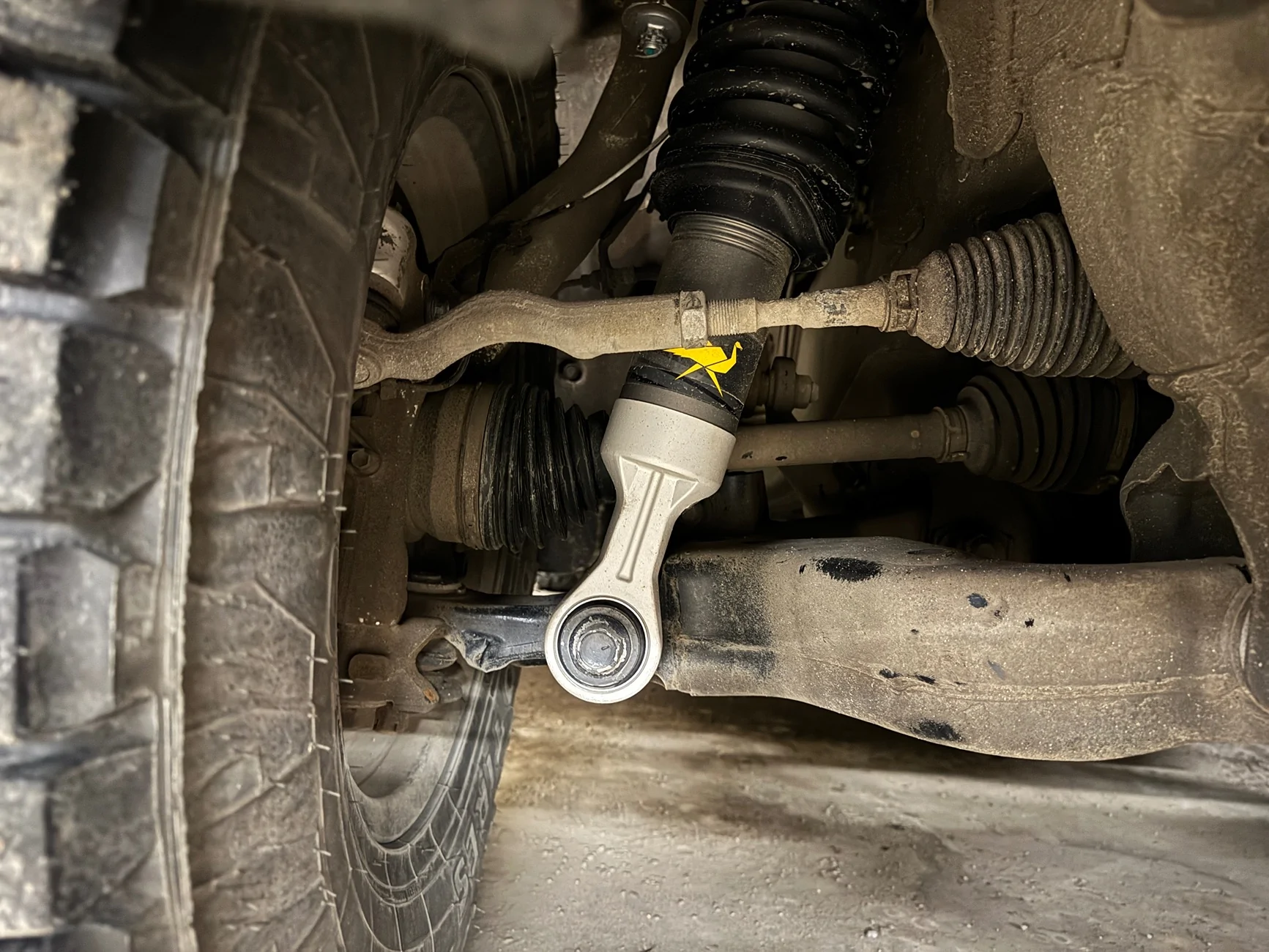

After passenger side on the ground Axel angle.
Total time 4 Hours labour + Alignment. Great work Darcy!
(Remember this vehicle is coated in Krown Rust Proofing here in Calgary, Alberta so everything remains rust free and protected and easy to work on)

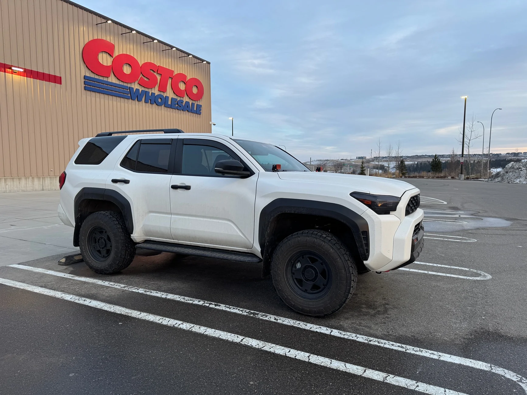

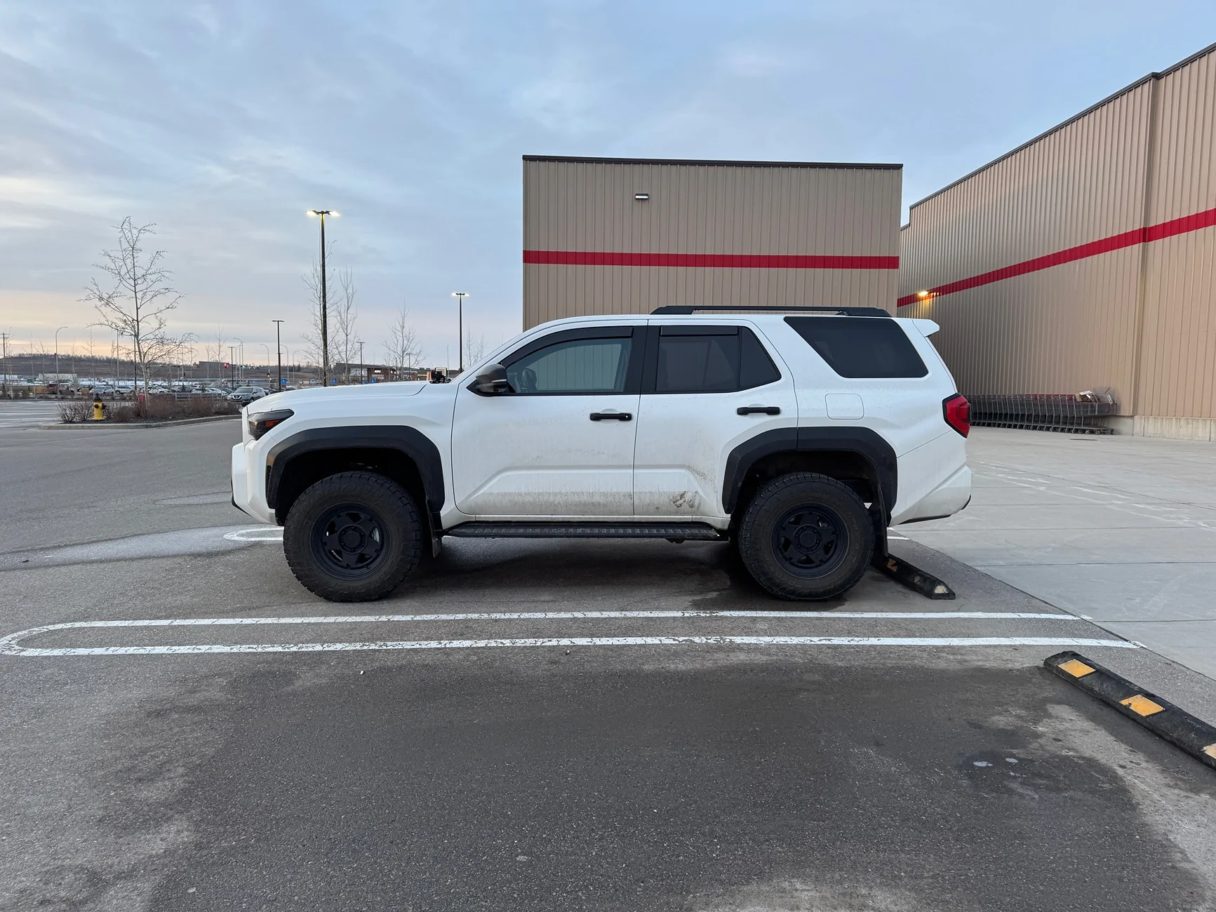

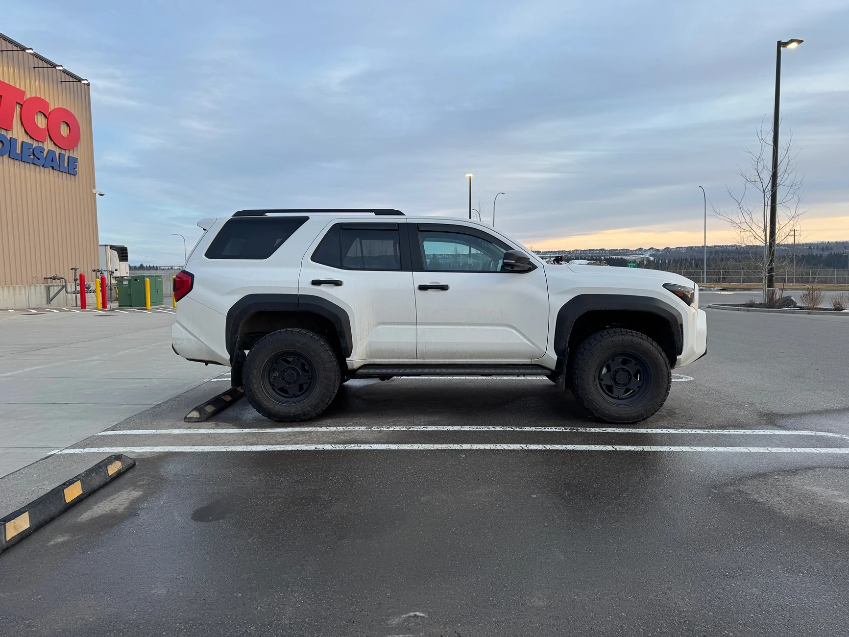

Now I have driven a bit on these before we head back to the shop to lift it up and check those questions off.
Ride Quality: Better than stock in many ways and we are running 285/70R17 Wrapped in Open Country AT3 C-Ply set at 37 PSI.
1. Sitting higher feels better
2. Speed Bumps, are much smoother
3. Driving off curbs, So much smoother
4. Calgary Roads, in general smoother less Stiff
5. Turns, No issue at all (Body Roll)
6. Speed, No difference at all
Axel Angles are looking good and zero vibrations 0-125Km (Just have not exceeded 125Km yet)
