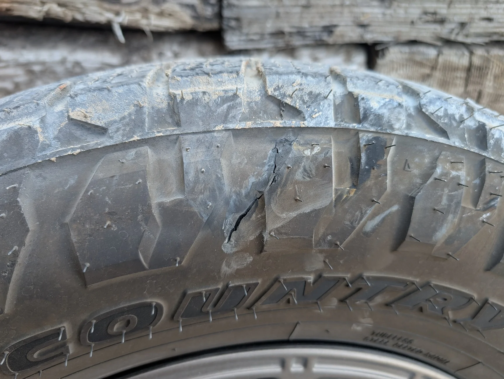

1. ) Driving in my neighborhood (road is under construction) and ripped sidewall out of a tire. Very surprised tire could not handle rocks.
2.) Disappointed Toyo Open Country A/T III only have 13.4/32" tread depth when new.

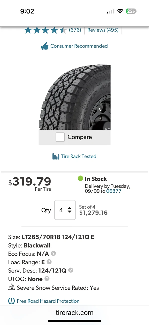

Would like to replace with KO3 (265 70 18) but they are not available in C rating. Suggestions?
Thanks

Well keep in mind the OE Open County is just a p-metric tire. The LT tires is an E-load tire w sidewall reinforcement

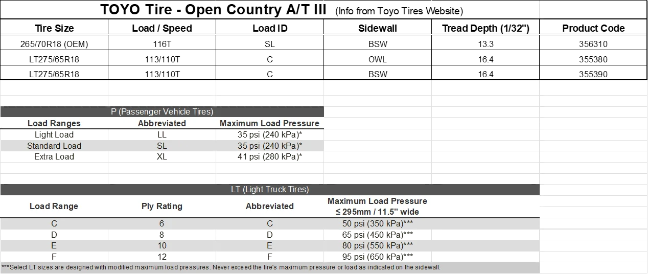

I wouldn't be too scared of an E-rated tire (which is what the OE sized LT-version of the OC3 is) because while The Internet points out they ride worse, the sidewall reinforcement is a "rating" not a fact of life. As the ply rating goes up, so does the load range, and so does the pressure that load is measured at. People who get a much higher load rated tire and then run it at the same pressure as stock probably DO have a harsher ride.
SizeLoad Index2427303336
P265/70R1811619822178239225792668
LT265/70R1812425382788306432963527
LT275/65R1811318242004220523702535
Using the data here you can see that the OE load at set at 2579lbs per tire (which is why the pressure is set for 33psi.) Going up to an E rated 124 load index tire (the LT version of the OC3s or KO3s) raises the load rating so much higher that to maintain the load capacity you would want to drop down to 24psi, and if you did a C rated 113 load index tire you would need to go up to 36psi.
Personally, I think an E rated tire at 24psi gets you a lot more sidewall reinforcement, while also maintaining a decent ride. I totally get where ppl put them on and maintain the stock pressure and get beat up. To be clear, I have no dog in the fight for an OC3 or KO3, its just that all the OE sized rugged ATs are E rated and the same load range, they're all in the same boat

Its tricky. ETRTO has guidance that says for every 10% from the maximum pressure, you should reduce the speed rating 10%. So that would work out:
TireRatingSpeedMax PressureLoad PressureReductionSafe Speed
P265/70R18T118mph443325%89mph
LT265/70R18Q99mph802470%30mph :eek:
LT275/65R18T118mph503628%85mph
So, ETRTO says maybe air those E loads up a bit...
Doing the math backwards, and saying what pressure would you need to be at to maintain the same effective safe speed as OEM (which as an aside is a little low to me) would be 64psi which seems unlikely that most ppl who run E loads on the highway actually run
If one were to slap some Q speed rated E loads on and put them at the OE 33psi, it would still only be safe to 47mph. I think thats a pretty common scenario, and I don't see tons of blow outs (yet!)

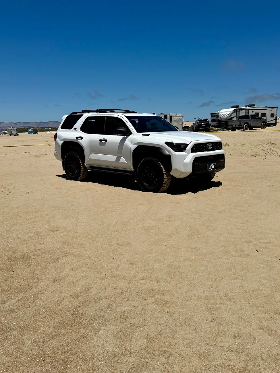

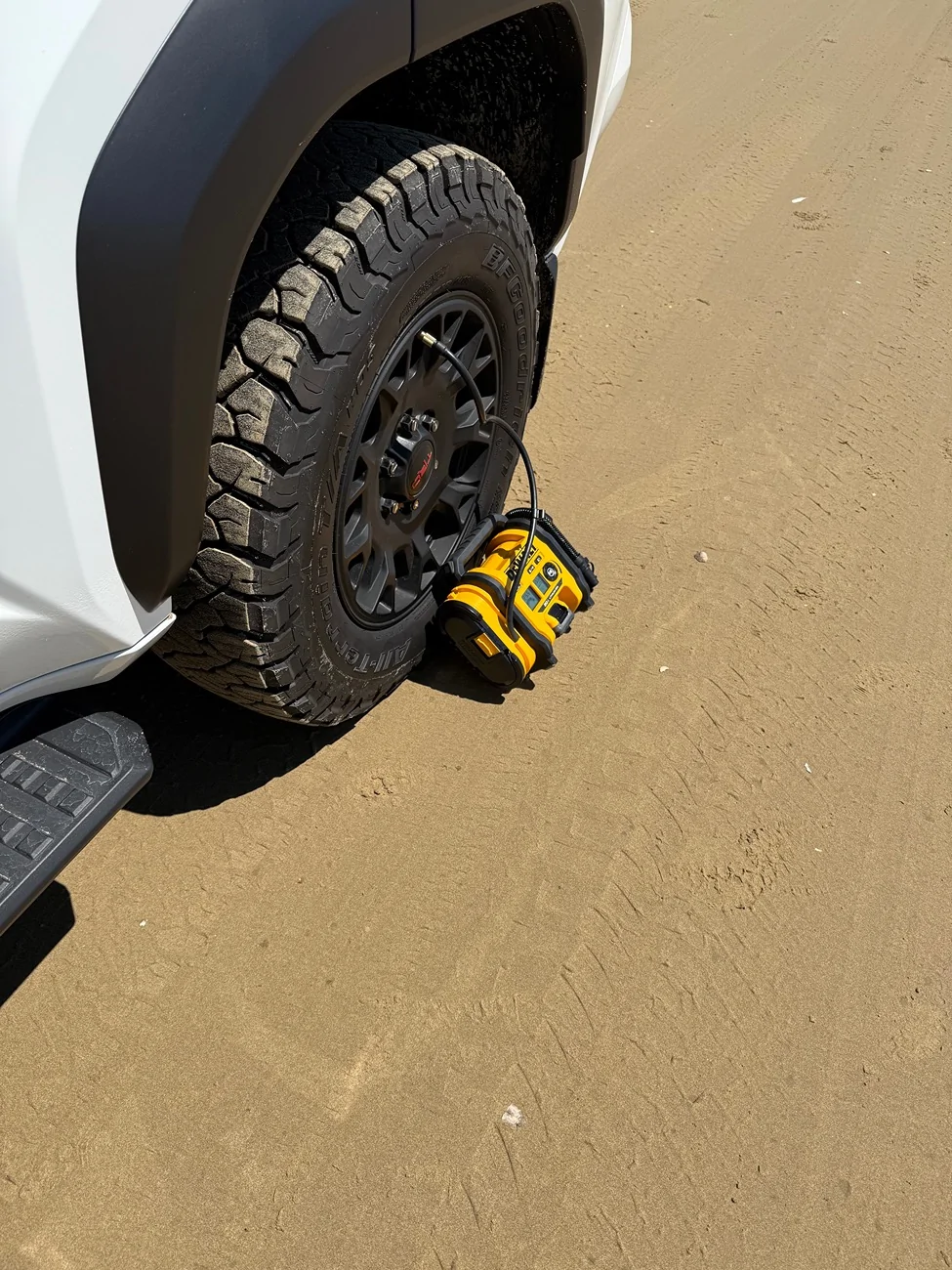

I have KO3’s, 265/70/18 on TRD pro wheels. Run at 35 PSI all day. No issues at all. Air’d down to 20 psi on beach, no issues.
