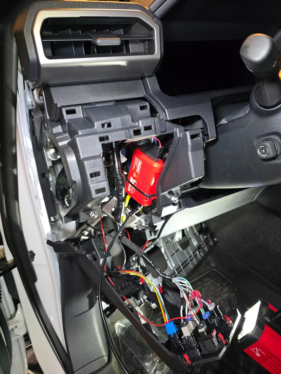

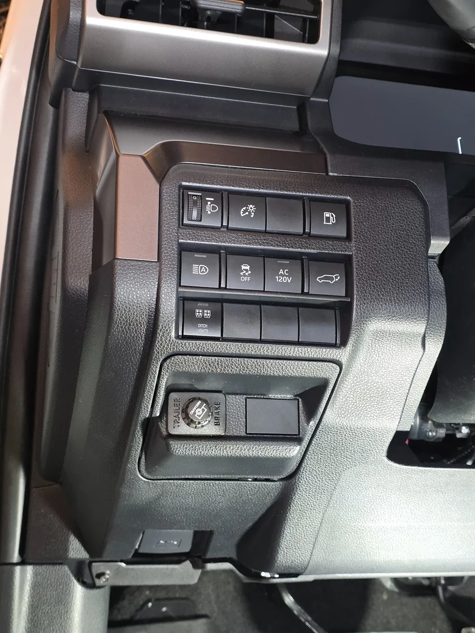

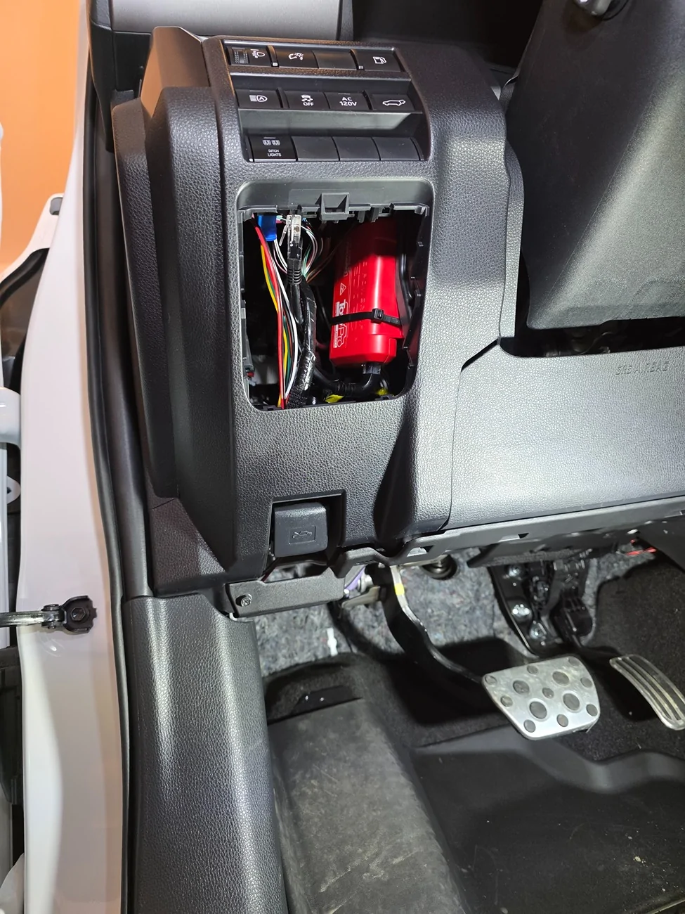

BonRunner
Dec 2, 2025
468
540
2026 TRD Sport Premium / WCP
How did u install it? Below is my setup. I got it working fine. Just follow the manual for setup. No issue towing 3k lb camper.
2025 2026 4runner 6th gen New Redarc brake controller install 2026 TRD ORP not functioning but steady blue light 20260628_144041
