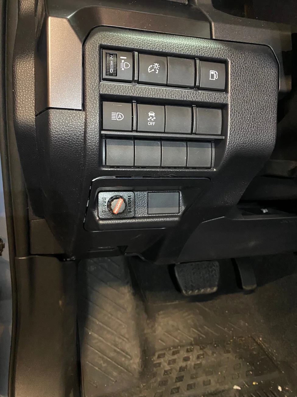

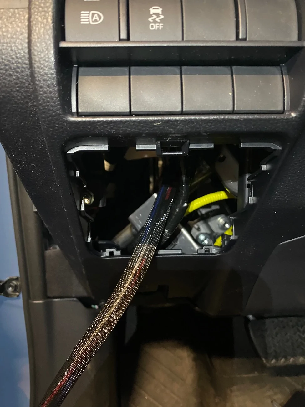

Dont actually have a trailer with brakes yet but it seems to have power. Was a bit of a tight squeeze, ended up just using zip ties to anchor it to the metal bracket behind the weird circular comportment. The plastic piece that came with the elite seemed to fit best into that little tray, ended up not using the two extra that came with the kit

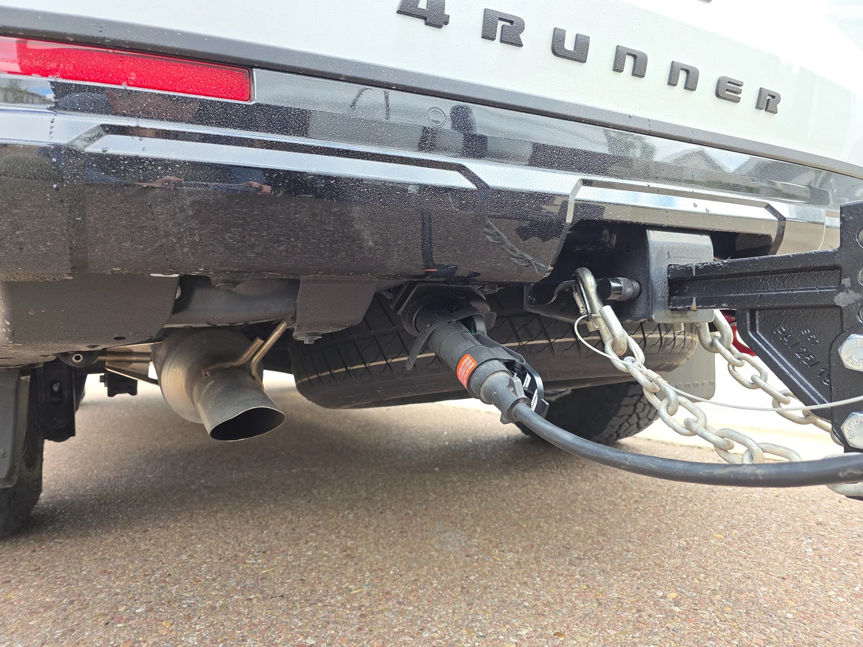

Nice! Going to install this soon, although it's the Liberty model, for under $200. I'm only towing a trailer camper. Everything looks easy enough and thank you Toyota for included the plug-and-play harness adapter on all trims for trailer brake controller.
I used the Bluetooth Curt Echo trailer brake controller few days ago for my 3k lb camper but didn't like it. The app is funky, has many annoying pop ups/warning. The strap sucks! Plus the adapter is too long and hangs too low for our 4Runner. I prefer a manually controller & not messing with any app.
