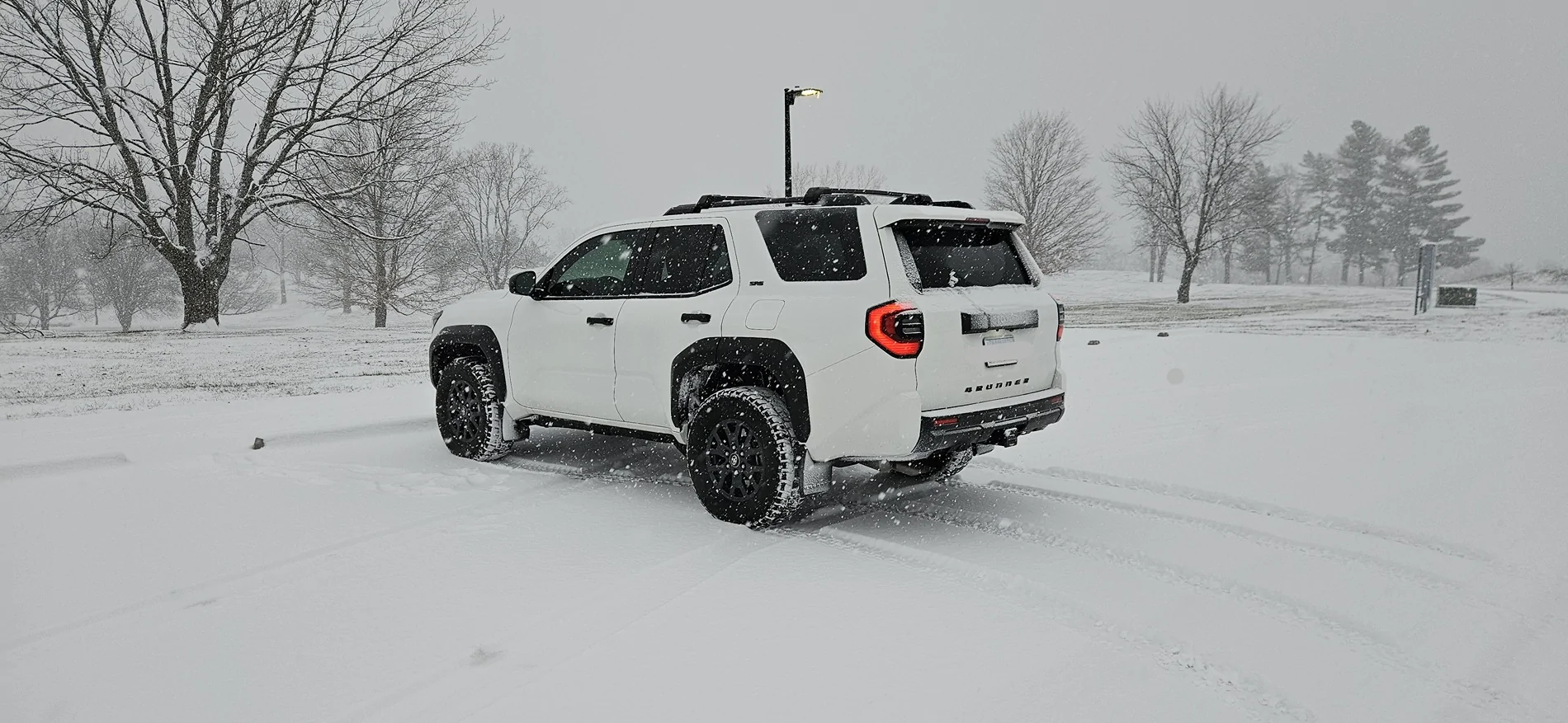

My 2025 T4R SR5 with the MT Baja Boss 265/70R17 Tires Fitted

Any more road noise than the stock SR5 rim?
are the better at at absorbing road bumps and potholes?
Hardly any additional noise with these tires. But I've only had them for the last 100 or so miles. I'm definitely happy with the upgrade and will not be substituting the OEM SR5 rims with an aftermarket option. What is noisy is the OEM rooftop crossbars. They will have to come off soon and only placed on when the need for an overhead compartment is called for.
Discount Tire had the tires inflated to 42 PSI. After brief research, I reduced the pressure to a cold 32. The tires feel more compliant at this pressure and not so hard. After driving for 30 minutes or so, the pressure would reach 35 to 36 PSI. We'll see how these perform in the snow this winter.

Looks nice ... IMO 265/70R17 tire size is what should have been on the SR5 from the factory versus the 245/70R17 tires. To me the 265's look proportionally correct for the 4Runner and properly fit the stock SR5 17" x 7" wheels.

Thanks! Agreed!

Any issues with those tires and the 7" OEM rims? I keep reading comments that say you should not go much larger on that rim cause it can cause bulging and it's not safe? I too am looking at the same size but unable to get a concise answer from tire shops or tire rack,

No issues whatsoever. Quite honestly, I wouldn't go any larger than that on the stock rims. They do indicate a rim width range of 7-9 inches for these tires. I've no unusual handling characteristics to report and run them at 32 PSI cold.
I patiently await the snow and ice to see if they're just as good as the Michelin CrossClimate 2s I have on my Subaru.

Looks great! Do you have a lift kit?
Thank you. No lift kit at the moment. However, I am considering some stiffer springs from Alldogs Offroad Coop that would provide a little lift (1.5 to 2"). They released a good video detailing the installation of the springs on their project 2025 SR5. I believe it would help mitigate the front end dive during aggressive braking.
