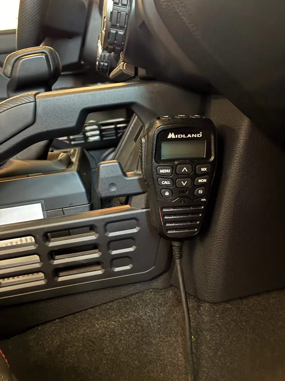

I used the grommet in the firewall to run the coax from my roof rack antenna mount. I used the in cab pigtail in the drivers side footwell to power the box. I have it mounted underneath the passenger side seat with a midland magnetic mount for the mic.

I am also running a Midland MXT575 with a NPT Thread hood mount. Using the 3dB antenna Im getting over 7KM talking range in city and much more then 30KM on open highway. I also run a 6db antenna that i keep in the rear trunk compartment if i need to get further range, but honestly the range im getting right now is unbelievably good with the 3db stubby.
I installed mine under the drivers seat and ran the mic hand held along centre console with mic holder very similar to how TurnerXC mounted his (but on driver side rather then passenger side). The install was easy and fast and there was more then enough room to go through fire wall on coax cable running.
