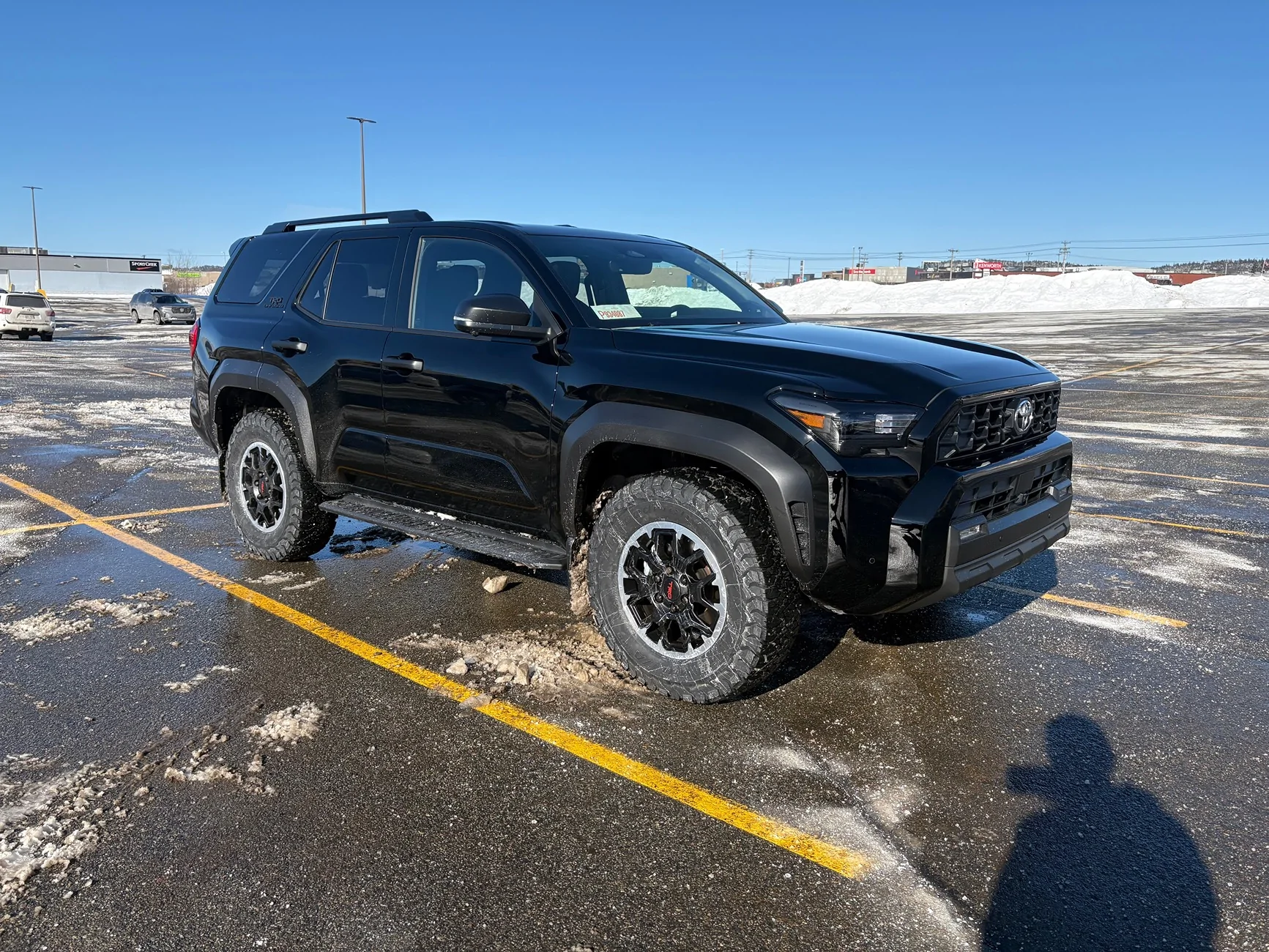

Picking up my new 4runner this week and doing tires right away but not sure on sizing yet. I dont plan on doing a lift right away because im not sure I want that. Its an ORP and going with a set of TRD pro rims as well (PTR56-35242-F1), any advice on how big I can go for the tires? Dealer is telling me 265/70/18 is as big as I can go without rubbing but have read some things online saying I could do a 275.
Thanks!

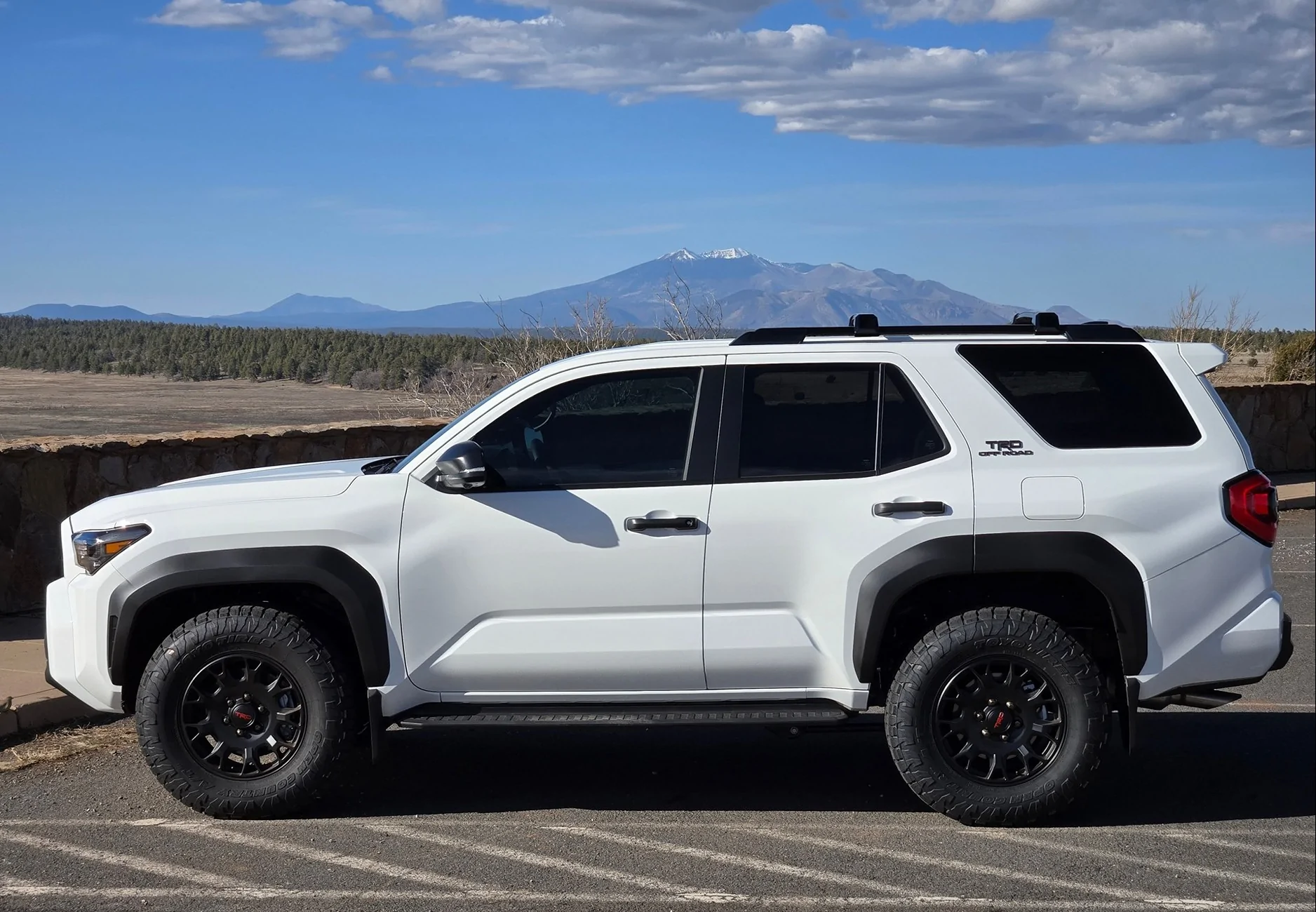

The part number is for the TRD Flat Black Option wheels (NOT the TRD PRO wheels). I have both and you CAN put 285/70s on those wheels on TRD ORP - with just the removal of the crash plate in rear of front wheel well**, This wheel has +45 offset. The TRD PRO wheels has +20 offset and will rub on front felt and on air dam screw tab. I believe 275/70 will fit just fine on the TRD PRO wheel (which in my opinion looks just a bit better).
**might not rub on the crash plate - I’ve not tried to reinstall since switching from +20 to +45 offset wheels - but there is more clearance so maybe. I’ve got the OEM tires (265/70 Michelin’s) on the PRO wheels which I will run for long trips without off-road excursions because MPG/range MUCH better (>4 MPG) with the lighter tires.

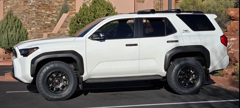

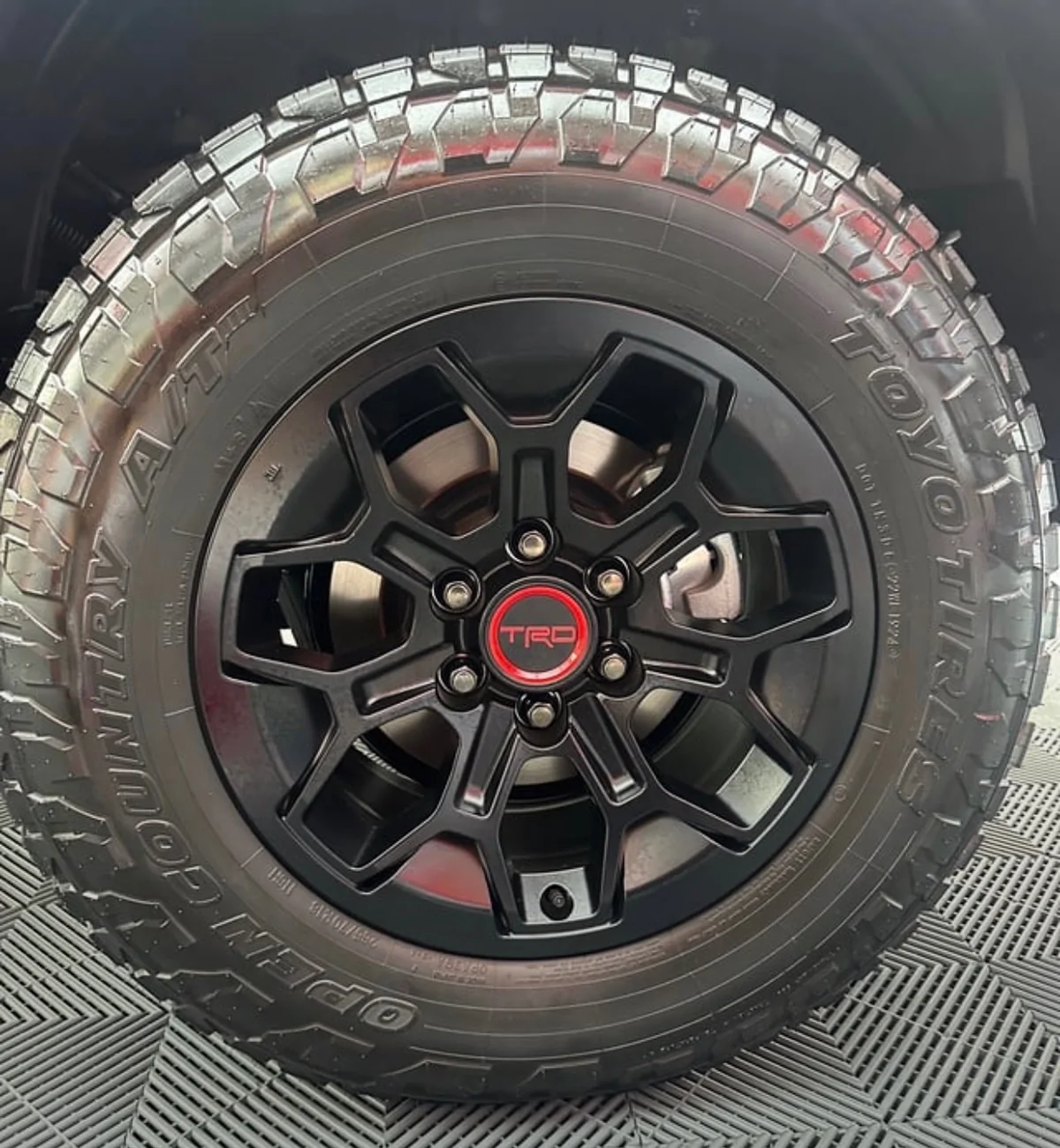

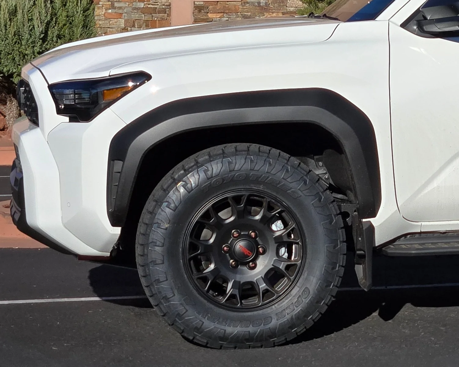

If you're asking about the TRD Flat Black Option +45 wheels (not TRD PRO), I have an ORP with stock suspension (for now). Running five Toyo Open Country AT3 E-rated LT 275/70 R18. Not sure if a 285 in this tire would rub, but this Toyo 275 (33.2") appears to be the limit for stowing the spare without mods or deflating.
Check the actual diameter for the tires & sizes you are considering.
