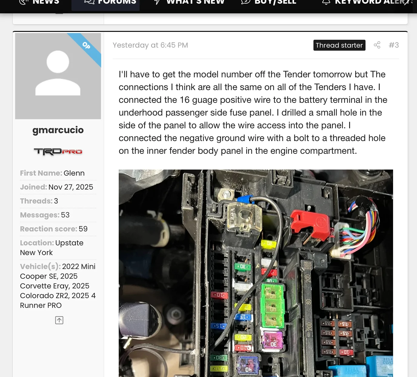

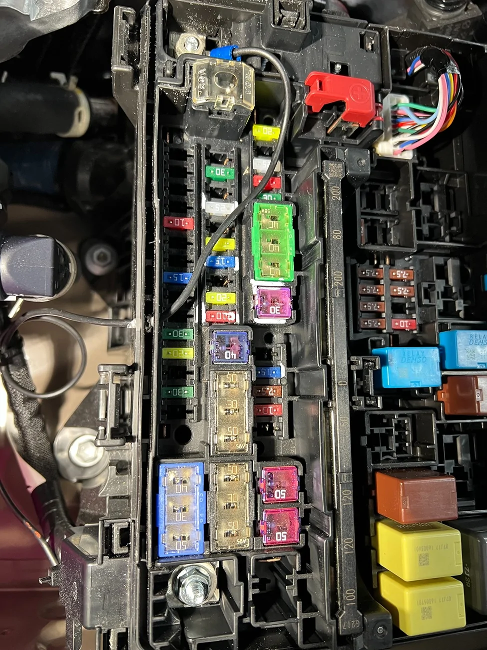

Have them look at this picture from a previous thread (“Battery Tender external receptacle install”) as there is a jump start post under the hood in the passenger side fuse box. Forum member gmarcucio used an adjacent post in that fuse box that apparently has 12v from rear battery. MLO may be able to hook up there rather than running a wire through or under the truck interior.
But don’t take my word for it. Let the professionals look at that fuse box!

I have that on my list to ask them. I’ve heard others say that’s not a good place to hook a switch. Like you said, I expect them to have a professional opinion on it. Part of me wants to wait a bit so they work on some other hybrids first and let them be the guinea pig.
