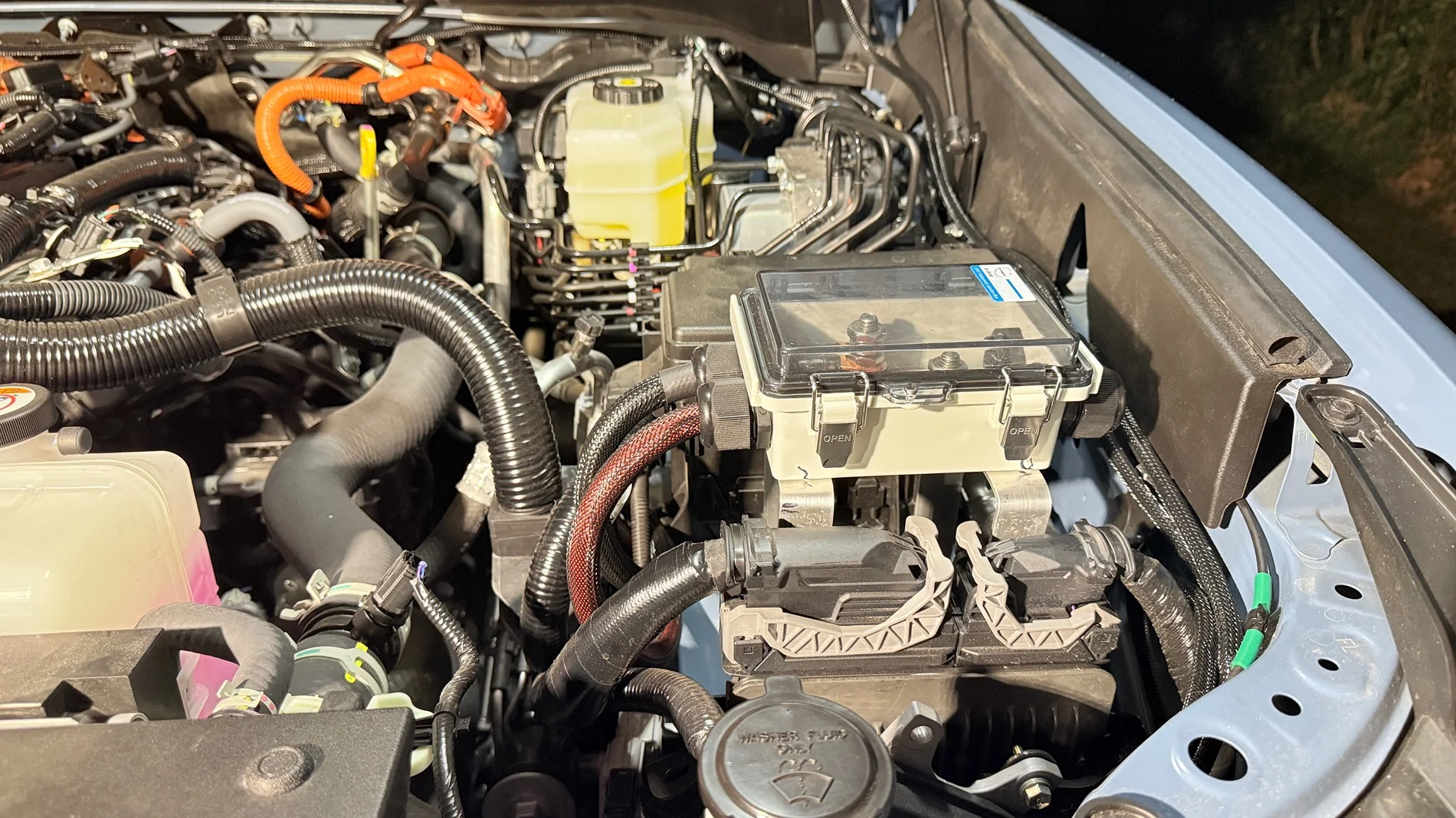

Just wanted to say thanks to @williej346 for providing the video guidance and info to inspire me to attempt to take on this project for my 4R. I didn’t follow the under hood parts list exactly but am happy with the end result. Thanks again, Will! šŸ¤
2025 2026 4runner 6th gen 12v power extension (for hood hookup) in Hybrid iForce Max 4Runner (DIY) IMG_9399

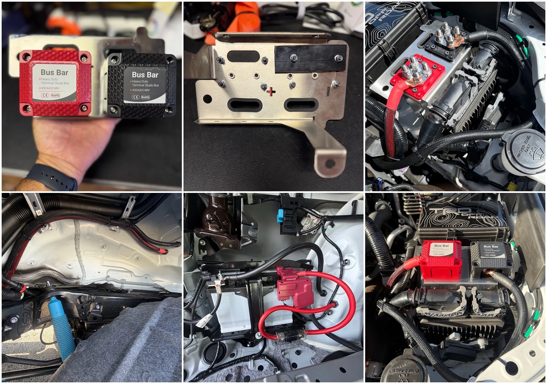

@williej346 , I actually shared you video on my thread. Small world. And @abstraakt I used the KC power plate in my build (it looks like you are using a KC power plate
Yep, you're right the KC plate. I had to drill some additional holes on the mounting surface and use a makeshift ABS backup plate to make it work for my configuration, but I liked the way the bracket utilized existing fasteners and I didn't have to drill into the fuse box cover if I were to use a different type of aux power plate.

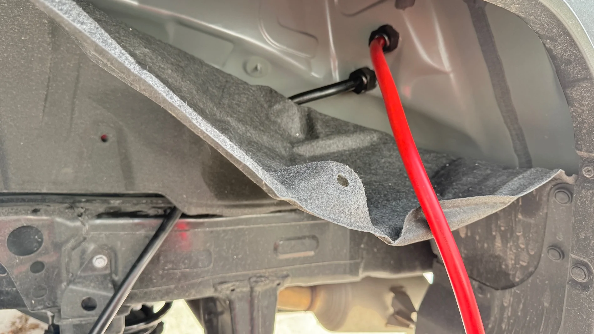

Couple questions, is 2 gauge in the table or is this a ā€˜don’t be an idiot, run the 1/0 or 2/0 while you’re in there’ situation? I might do a winch one day, not sure tbh. Do you all have a link to the grommets you used in the rear or will anything that style work?
okay, one more. Anything you’re doing to protect the wire run or is being on the frame enough and I’m overthinking it?

I ran 2/o on mine. It’s a bit of distance and trying to factor in additional accessories (maybe winch) in future. Shop I use has an in-house auto electrician. I recall @williej346 saying in his video he’s got some wiring background so might be good to hear from him.
