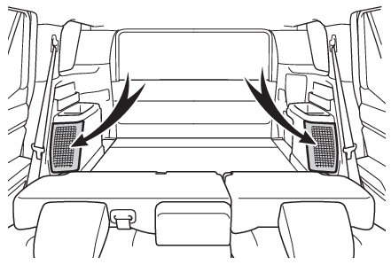

Large amounts of water: I see no issue with that, as I will not likely be having a lot of water in the back. I do not think there is a concern over small amounts like spilled dog bowl water or from sealed containers (like a jug I carry to fill the aforementioned dog bowls or as backup emergency water). Yeah, don't put it right next to the air intakes for the battery. I suspect, though, that even there it would be difficult to get enough water in there to cause an electrical problem.
Weight above hybrid battery: @drNick I have never seen anything that warned about a weight limit over the hybrid battery. I just rechecked the manual and found nothing. Where did you see this? I really cannot imagine this would be an issue, especially as the weight should be fairly evenly distributed anyway (would you have 120# all right over the battery often anyway?).
