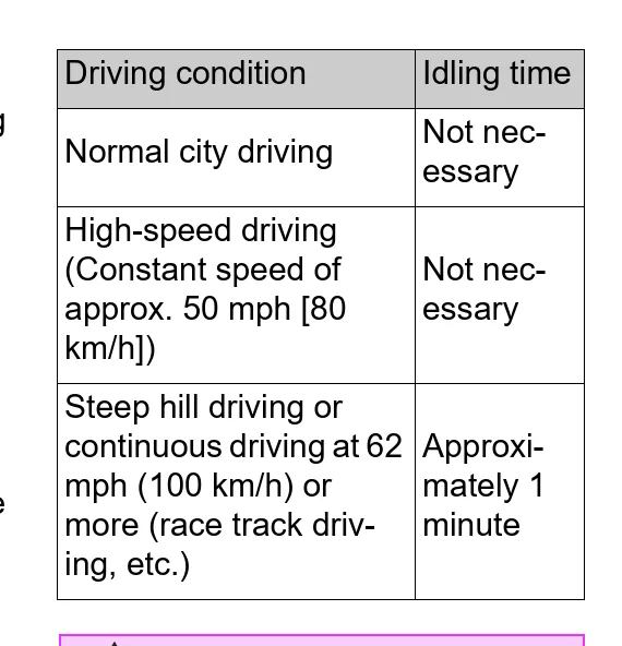

The answer is yes. After hard driving you are supposed to idle the car.
I thought I'd post this manual excerpt (pg 194) [corrected] despite the age of this original thread in case someone else comes along wondering the same thing and curious about the answers.
I probably wouldn't think to idle the vehicle, or that it won't be a problem as many in this thread believe.
I am just pointing out that this question is asked and answered in the owner's manual. I happened to stumble upon this just yesterday while reading the manual "for fun"
2025 4runner 6th gen How does Hybrid iForce Max engine cool down the turbos after a hard drive? Screenshot 2025-11-13 at 7.01.32 AM

but that doesnt tell you the details
on the 4R, the turbo is water and oil cooled. so if you run it hard or above normal, the reason you do a cool down is to lower the temps of the oil mostly. the water part will still pump since that is tied to a electric pump motor if i remember correctly and will run after ignition off
oil pump will not so that oil will cook that is sitting stagnate at the turbo
