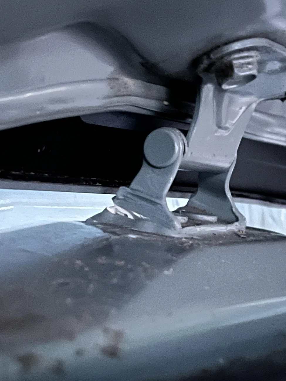

if one strut become stiff or harder to compress, closing the hood could easily twist and warp
the hood itself. it is a lightweight aluminum hood and already known to show vibrations and flexing from wind. and it is not designed to handle gas strut compression forces at the hinges.
so now you are asking the hood to perform beyond design parameters and compress two gas struts. that could go wrong and twist the hood if one strut fails
not saying it will happen, but Toyota is known to design hinges as minimally as possible. reference rav4 liftgate hinges ripping out and warping on power liftgates using all OEM parts.

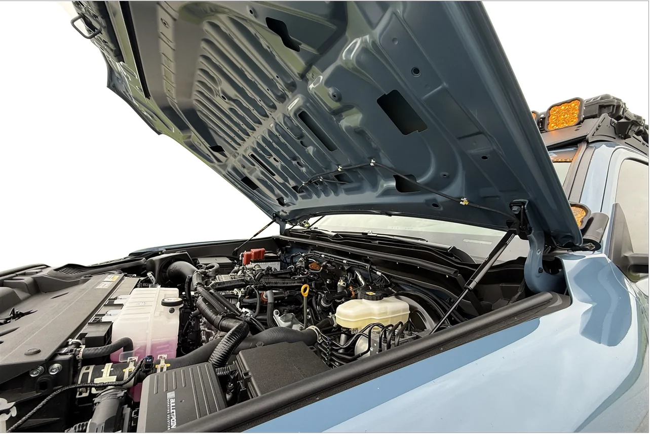

2025 2026 4runner 6th gen Hood warping from hood support struts? 1771180758825-50
2025 2026 4runner 6th gen Hood warping from hood support struts? 1771181245546-ix
these hood struts send forces into the hood structure where it was not engineered to perform that way...hence some damage risk exists which doesn't exist with the prop rod
